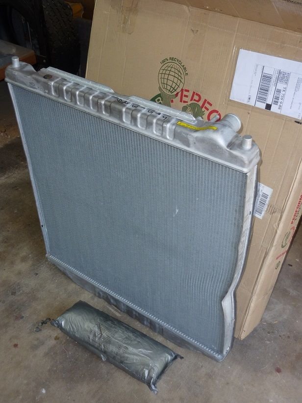

It's my understanding the BPD is a Performance Radiator, only at a higher cost. Maybe the extra cost is justified if BPD can deliver it without any damage. I ordered directly from Performance and it took them three tries, and they were all damaged. They told me to toss them and gave me a refund. I kept the third one as it was the best. So I got it for free but it's racked so the top mounting brackets are cocked to the passengers side. Drives me bananas but it was free and I still don't know what else to as the plastic tanks are out of the question for me.
Here's the first one I received from Performance. That grey foam pad on the floor is the only packing material that was in the box.
