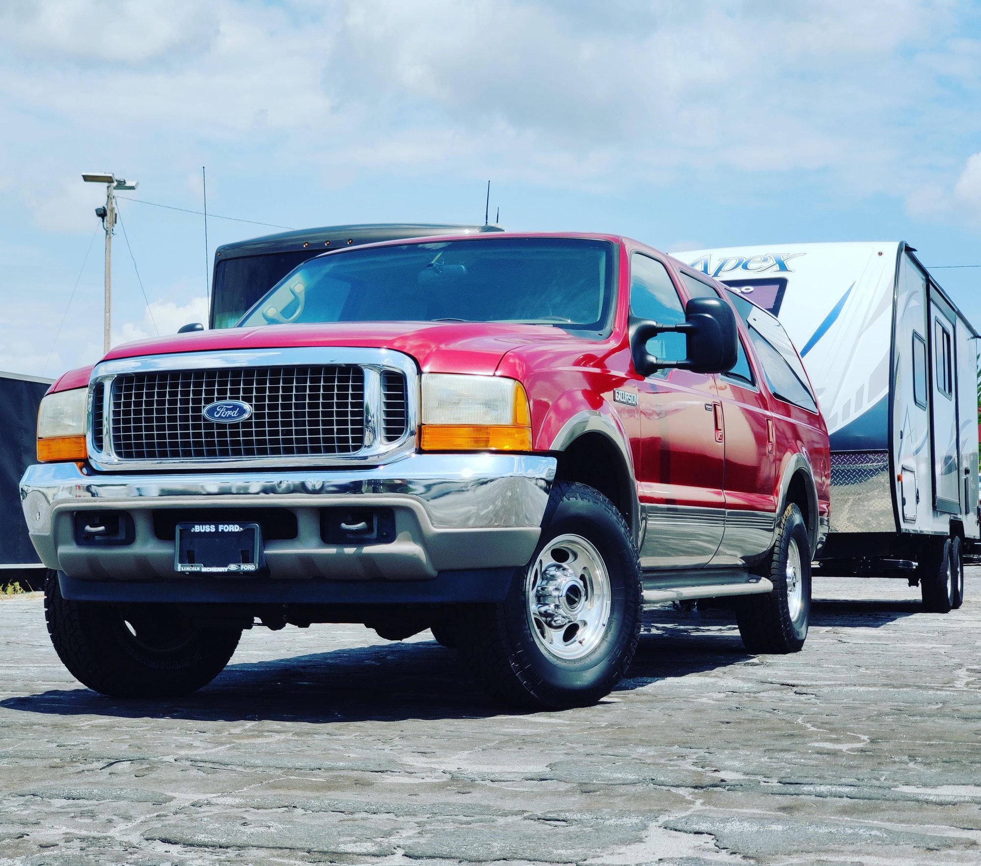

So I have been reading every thread I see and basically I think I have taken it to a point of confusion. So I will try to layout the use of the truck and goals so advice can be given on the best coarse of action.
The truck is a 2000 6.8 V10 4wd with 173k miles on the clock. Currently on factory 16” rims with 285/75R16 AT’s I do have a Reese sway control and weight distribution set up. I have no issues with the way it pulls currently aside from the ride. Currently there are no issues with wondering on the road.
I have no plans to go above a 33” tire. The truck is the family road trip vehicle as well since the 3 dogs get a ton of space and so does luggage and the kid. I do tow one of two trailers for some trips. The first is a double axle enclosed car hauler 8.5’x20’ 8’ interior height loaded weight with trailer approx 10k. The second is a 21BHS (21’) coachmen apex nano load weight is approx 6k.
I have taken the Ex off road as well and will probably do that from time to time but it is mainly fire roads and forestry service roads. Nothing extreme.
Towing duty, highway cruising and forestry roads are the challenges. My goal is a smooth riding down the highway, competent towing, and absorbing light off road trails with some flex to the suspension. I want to accomplish this with as little lift as possible keeping it friendly for my wife to drive and ease of getting the dogs in and out as well. Keeping it car wash friendly to would be nice but I’ll get over that lol.
So Procomps and Bilstein I know are popular with a number of F250/F350 spring combos. Those are the goals I have no issue with changing the springs, shocks, etc to get a great final result.
So I would love to hear your recommendations for a good ride and competent towing capabilities for the suspension with minimal lift.
Thanks in advance guys much appreciated. If there is a data point I overlooked please let me know and I’ll get the info, measurement or picture.
