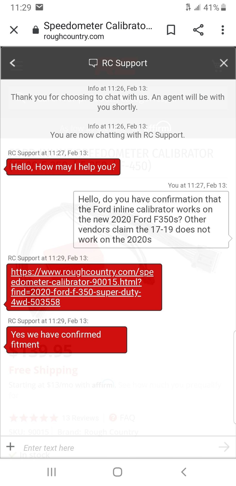

Has anyone had any luck with speedometer calibration on the 2020s since last post?
Has anyone tested this method?
I think you should buy it and let us know. Hypertech and FORScan are both currently working to get it to work, and this unit looks a lot like hypertechs...
