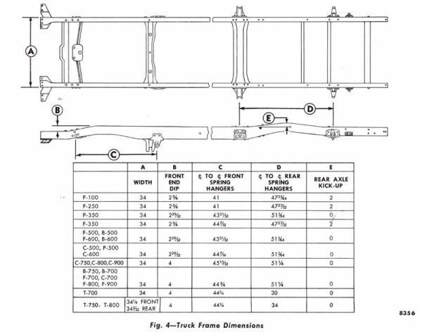

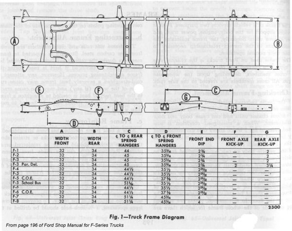

Here are the overall dimensions on the three frames:
48-52 Frame
53-56 Frame (there is a difference in the rear springs in 56)
This does not show the cab mounts, but there are a set of "wings" similar to the front mounts on the 48-52 above.
57-? Frame
Sorry there are not more dimensions in these drawings. But they give you the general idea.

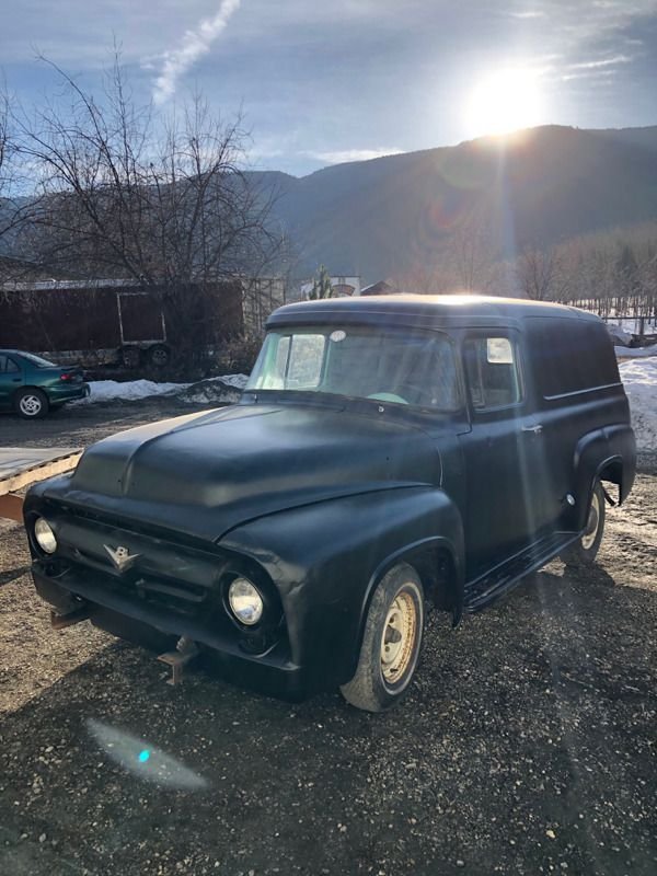

Atom: This is one frame that you can not have:
Old Jan 22, 2020 | 03:33 PM
AtomiCapricorn's Avatar
AtomiCapricorn
Posts: 40
From: Lake Havasu City
Nice to see another panel truck/money pit. 😄 What are you running in it?
Old Jan 22, 2020 | 04:40 PM
Old F1's Avatar
Old F1
Joined: Feb 2008
Posts: 2,795
Likes: 129
From: Windermere Valley,B.C. Ca
Snow ! It's the next project in waiting, buying parts a bit. I have a 5.0l HO for it.
In regards to the frame, the I think the Panel frame is longer, it has some extensions built on to the pick up fame.
If you still end up needing one there was a bare pick up frame just across the border in British Columbia for sale.
I thought about getting it as a spare but the guy was being difficult, I see that the listing is gone now, but probably still there? .
