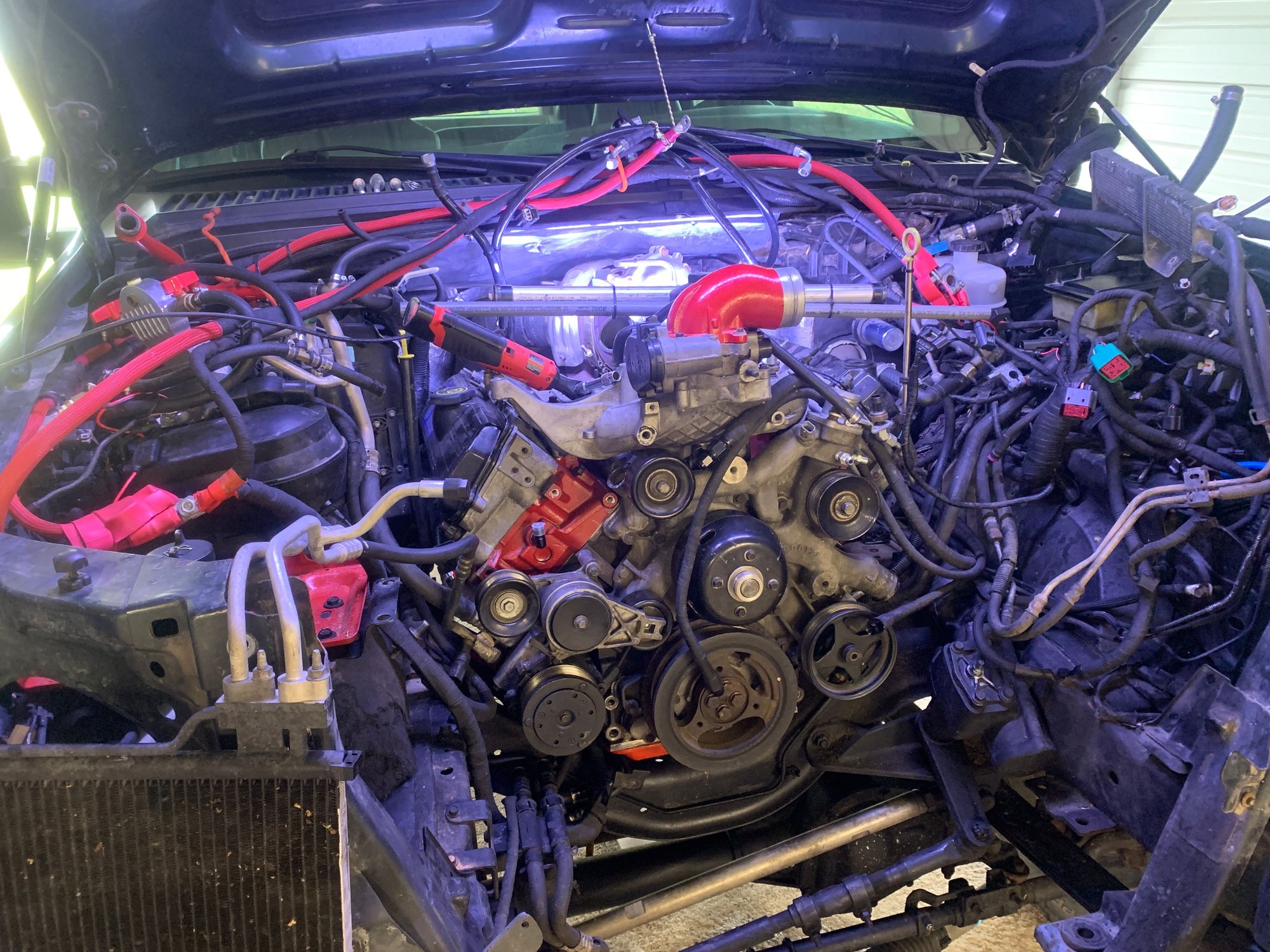

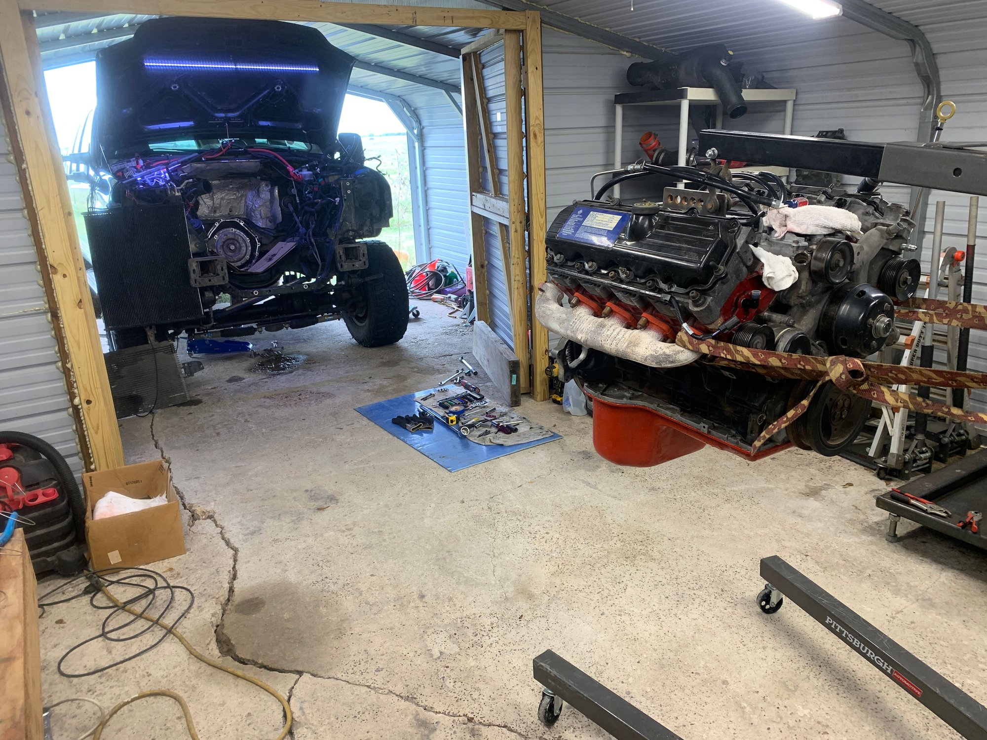

Not really, I have plenty of room! Haha! Last time I replaced it was about 30k ago and it was a Mororcraft water pump that started weeping from the freeze plug. I just got my Dieselsite pump in today and will install it once I get the engine back together.

You can easily get to the water pump from the top. Drain the coolant from the radiator, remove the radiator, belt, fan and stator then you can swap the water pump.
