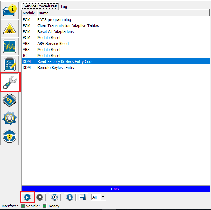

I use IDS normally to access modules, but also have used other tools that work so so.
Example: Forscan (which I do not recommend given the likelihood of Russian hackers infiltrating it) under the Modules (w/PIDS) area --- it will pull these up (often with a range of two possibilities for each entry position so you may have to do a little trial and error). I believe it's also under the "Services" tab.......
I believe Forscan is still "free to try" (haven't used it in a while)..........so give it a shot.........

Get an ELM327 adapter and down load FORScan software to your Windows laptop. connect to the car, go to service procedures and read the keyless door code.
