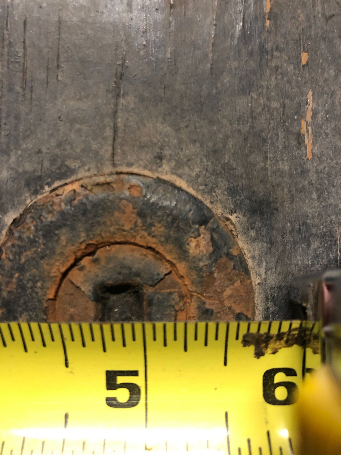

So I’m removing the wood bed planks, and for the life of me, I can’t find the correct tool anywhere to remove the four bed to frame bolts. Can anyone help me with the name/correct tool sold anywhere today, to remove these four bolts from yesteryear?
i know I could cut heads or weld nuts to the tops, but I’d like to be able to install the new set when I re-install the refinished boards with the new set of bolts, and having the correctly fitting tool for the install would be great.
This is one of the four culprits

Tried the 1/4” ratchet, and it is to small. Slips and spins. I measured with a digital micrometer and it's .3065”.

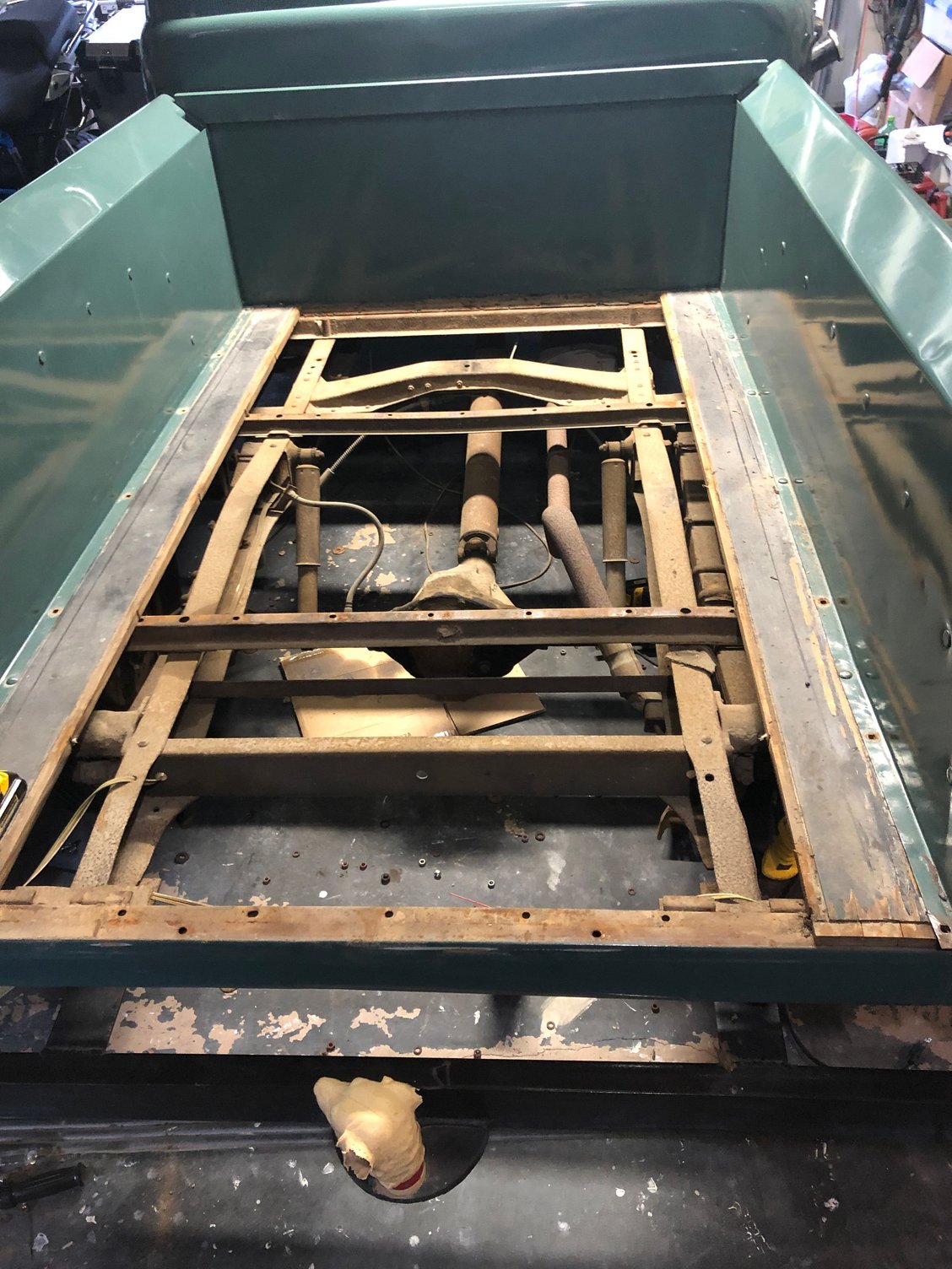

I will hit the Harbor Freight first, then option two will be the 3/8 extension, and last option will be cutting them off from the underside (amazing how much easier access is with the four boards already removed. Might go ahead and replace the rear shocks and the seal on the rear end while I have the bed panels out, just to make things easier.

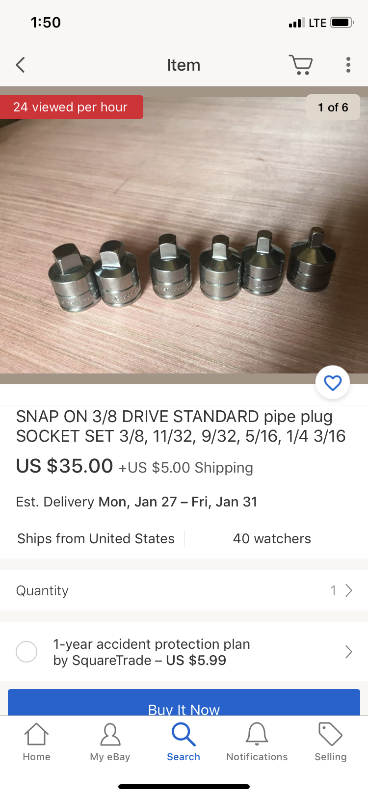

It’s 5/16” and there are “pipe plug sockets” that fit it perfectly
here is a set
here is a set
I should have asked about this like, idk, 9 months ago, lol. I drilled & cut the crap out of mine bc I couldn't get anything to fit. Good to know for next time! I have a running list of like 50 Things Not To Do Again once I get to my next project, a '54 for the wife.

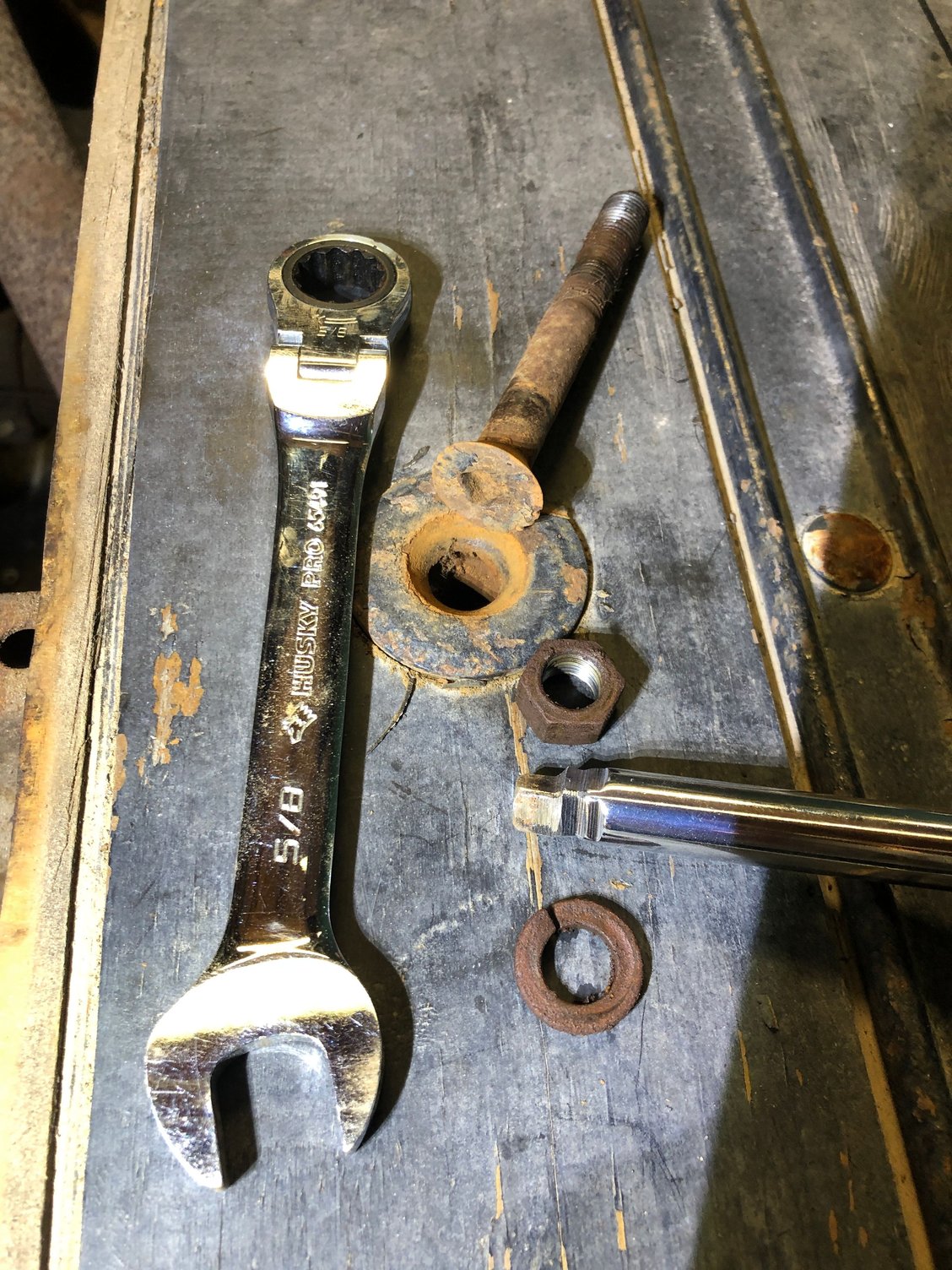

SUCCESS!!!
Quick trip to Harbor Freight, a new 3/8 extension and a new bench grinder (didn’t have one of those in this garage). Took less than five minutes to grind down the 3/8 extension, exact fit on the old bolt head, and off she came with little to no effort. Now for the remaining three, and its wood refinish time.

All four bolts are out and wrapped the extension with some blue painters tape, so I don’t pull it our and try using with any regular sockets. It will go into the bottom drawer and probably never be used again, as I will order the set of Snap On pipe plug sockets for the new bol install.

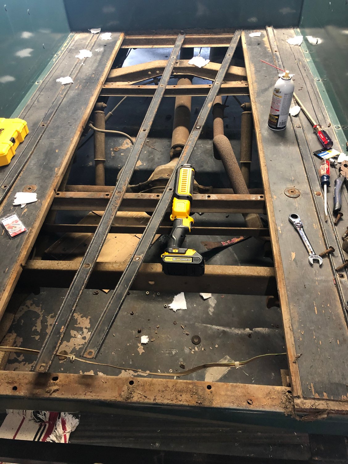

A little off topic, but what do other use on new wood install for gasket material that goes between the wood and the metal cross members and under the bed sides on the outer bed wood slats? I’ve seen mentioned and sold the cork material, but was wondering for longevity about using rubber 1/16” thick. Is there any disadvantage to using rubber? I’m just guessing the cork was all that was really known /m available back in the day, but there could be some other reason I am just not thinking of. I am not concerned with high end show requirements, just wondering if there are any potential problems with using rubber instead of cork.
Also, all bolts are now removed except for a few side ones. Is there anything I need to do for holding up the bed sides when the last few bolts are removed and the two outer wood pieces are slid out? I am not seeing anything that looks like its going to come crashing down and apart, but maybe I’m missing something that I should be cautious of.
