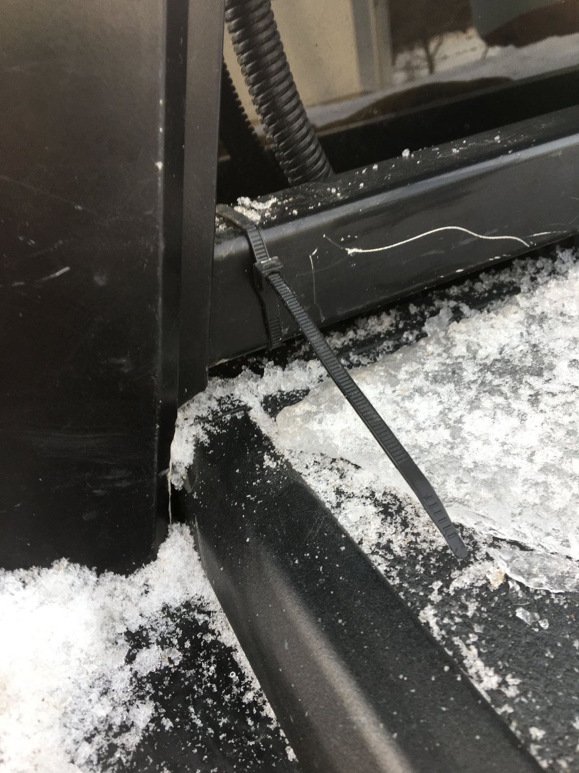

My Magnum I believe is for the earlier Fords,(pre-17's) so it sticks out beyond the cab a bit. Its also the High Pro.
I have a Backflip on mine that would not fold all 3 pcs as its tucked under the rack to seal on the fwd end of the bed.
I also had to cut 2 little tabs to get it jammed in there. The Backflip was for a '17 I picked up used.
In looking at the Magnum site they are the same width so I don't think the OP would be able to fold it as he wants.
I'll try & get a picture up later of how its tucked in there.

Here’s the picture of the Backflip tucked in there.
