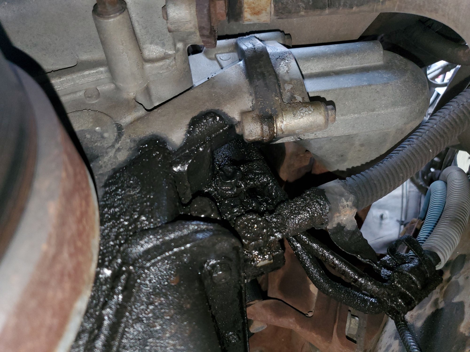

Hey everyone. I have a 2003 F250 7.3 with about 211k miles on it. I have developed an oil leak somewhere on the front of the engine but am having trouble tracking it down. I currently have it at the shop after my failure to find it, and they are still looking into it but figured I would post here to see if I could get some more help. I had first thought it was the HPOP reservoir or the oil cooler gasket at the front. After cleaning that up some, it appears to be coming from higher up. No oil in the valley. Shop feels it is looking like it could be the front cover, but after cleaning it up yesterday and running it all day they couldn't find a leak. I have attached a few pictures for what its worth though they aren't very good.

Could be a failed gasket on your oil cooler or oil cooler mount

Sure looks like the front mount for the oil cooler. Here's a recent thread on this very topic

I see a pretty significant crack in the aluminum casting.
Simple green and elbow grease. Get it surgically clean. Start it and get it up to temp. Follow that lead.

The thought of a crack scares me in a 7.3, I hope its just his oil cooler gaskets/orings. I was scared *****less when I replaced my reservoir gasket, from reading the 2 different gaskets and front covers.

After further review, I must ask, was this rig ever "Frozen" ?
Denny
Denny,
Where are you seeing a crack? The bottom of the front cover leading to the oil cooler? Hopefully that is just a casting line covered in oil. Looks pretty straight and protruding not open. HOPEFULLY

I apologize for not being clear. Does not appear to come from cooler flange gaskets or cooler o rings after cleaning it up. Also doesn't appear to come from the reservoir gaskets either. Shop cleaned it more and after driving it around yesterday are still unable to locate it. Said it is definitely not the front plug on the oil rail. We discussed using dye to try to find it.

The crack looks like it's coming from the front cover. Just look above the oil leak and you will see the crack clearly about half inch to 3/4 inch long vertically.

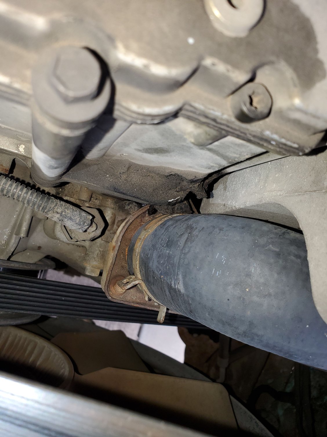

Is this what you're referring to? I believe that may just be
shadow from the flash at the edge of the front cover.

Some cleaner shots. Still not great pictures though. No visible leak right now so I will drive it for a few days and see what happens.
