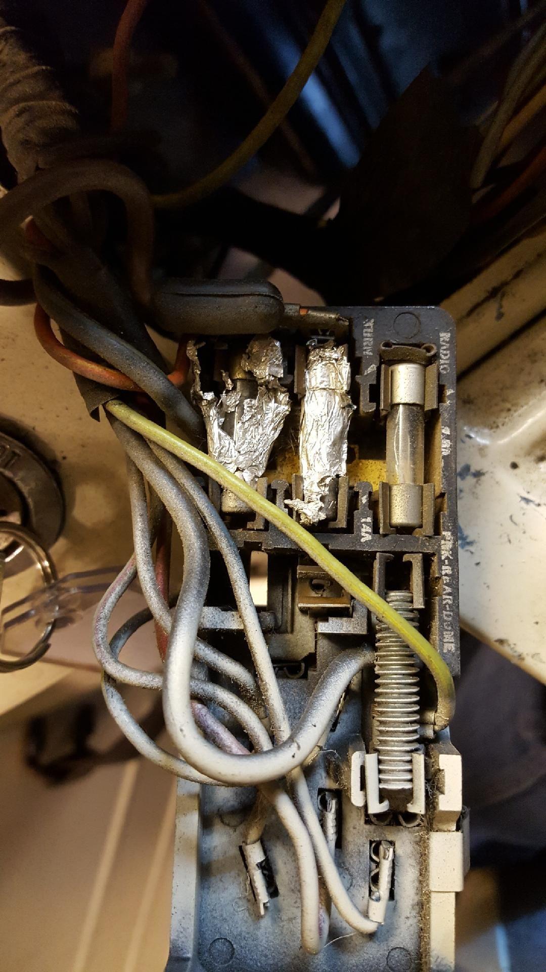

Any one know if there's a fuse for brake lights not working? I've replaced the mechanical switch w/a new one, parking and signal lights work, except brake lights. If anyone has had this trouble before I sure appreciate any information or help you can provide.

Yes. There should be a green wire with a red or yellow tracer going to a 15 amp fuse in the fusebox.

I had to wiggle the wire to get mine to work its in the fuse box the single fuse the wire kind of goes out the top

I see the wires at the fusebox, not sure which one it is because there's no Brake light label, it says Back (maybe that means Brake light), it's a 2 amp fuse, I believe it should be a 10 amp at least? Anyway, appreciate the info, we'll keep trying.

its the longer fuse. be closer to the headlight ****

this is how I found this. I fixed it. the wire for the brake light is the green one going over. I believe. the sm fuse on the rt .is radio. the one with the threaded rod is the brake light fuse

Just want to let every one that when I replaced the turn signal light switch/wiring....that fixed it....now brakes, lights, turn signals all work.

Love the old school tin foil “repair” of the fuses. I used to keep some in the glove box for TEMPORARY repairs. It is sometimes amazing what people will do with wiring. “the one with the threaded rod is the brake light fuse” 😀 What is that about a million amps! Glad you located and took care of this before the truck burnt to the ground.
Mine is probably worse than yours if that makes you feel better. I found wiring running through holes in the chassis, without grommets, wrapped around the metal fuel line.

I hope you got rid of all the tin foil and threaded rod.. Also if any of the fuses are loose, I've seen those ends at one of my electric suppliers, I'll see if I can find a link. If the fuse doesn't snap in tight they can get hot from the loose connection and melt the fuse panel.

FYI it was the turn signal switch and not the fuse. I replaced with a new one and now brake light work.
