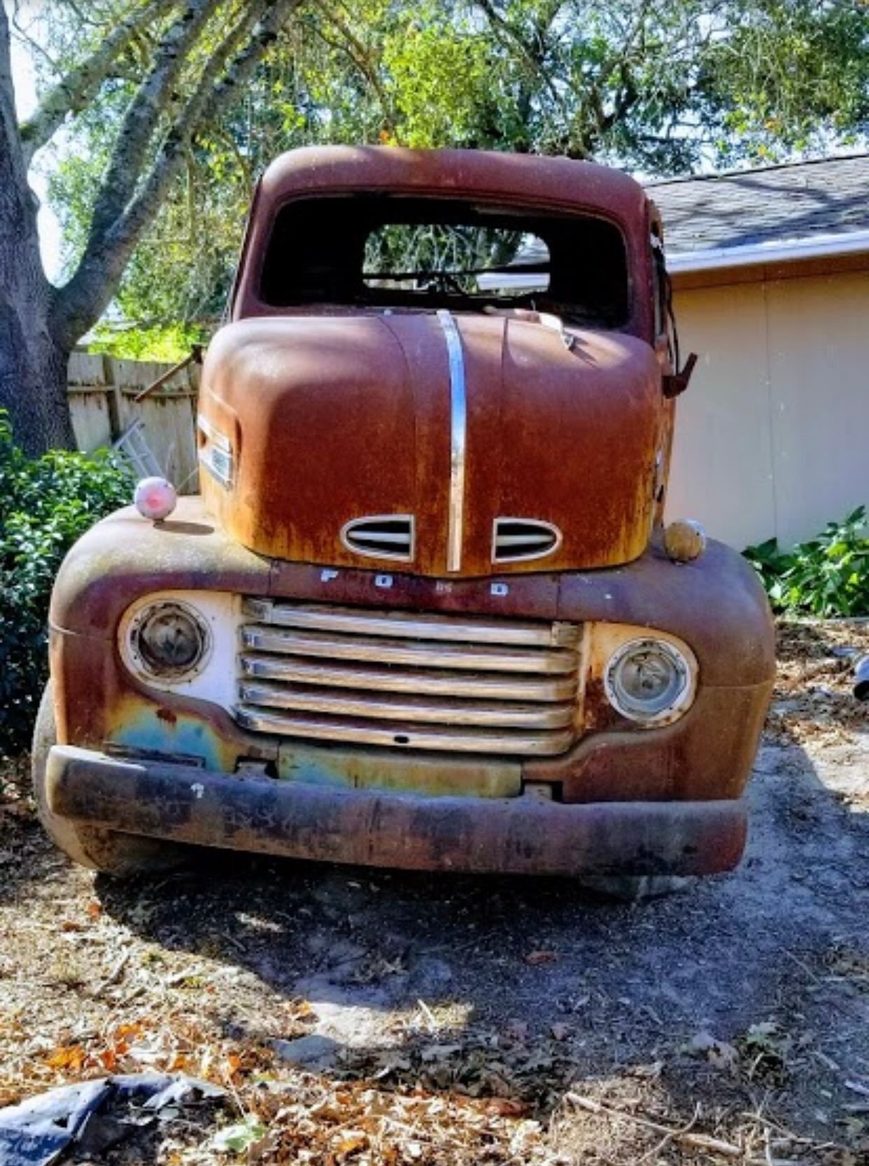

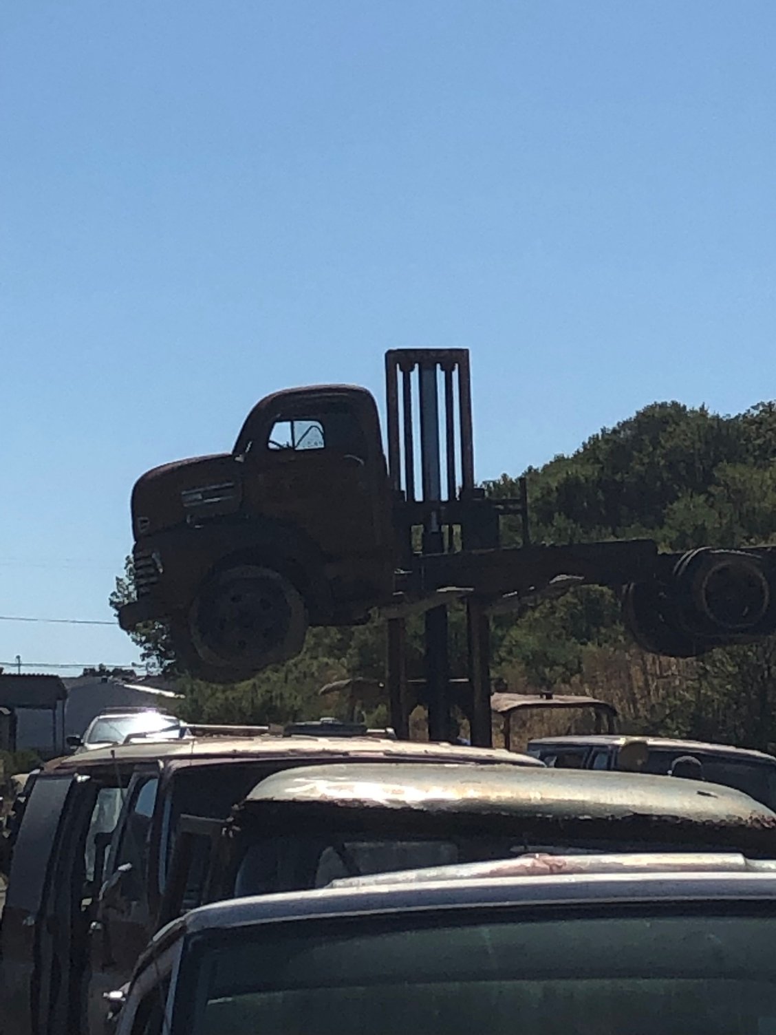

Old Jan 14, 2020 | 12:49 PM
COE50's Avatar
COE50
Joined: Jan 2020
Posts: 15
Old Jan 14, 2020 | 12:52 PM
COE50's Avatar
COE50
Joined: Jan 2020
Posts: 15
Old Jan 14, 2020 | 01:41 PM
Mixer man's Avatar
Mixer man
Joined: Sep 2014
Posts: 4,920
Likes: 21
From: Bothell & Silverdale, WA
WOW! Hope you realize what you got there - very rare stainless grille bars, and the body looks good from what I can see. Those pictures whetted the appetite. More please, at your leisure.
I did not realize it until now, That’s good to know. There is not much else to see but I can take some more pictures. What did you want to see?
