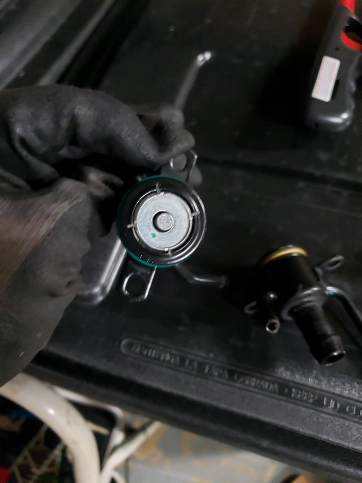

Edit: Forgot to add the specs, 2001 F150 4.2 V6/ 5 Spd
So I threw in the towel and let a shop diagnose my Bank 1 and 2 codes. To those who told me to look at the intake gasket first, you were right and I should have listened sooner but was hoping for an easier fix. They've determined that its the mid-intake gasket that has failed. I am guessing they mean the lower intake gasket but I would replace both since I'm in there. Are there any other parts I should consider replacing along with the gaskets and isolator bolts? I've never changed an intake gasket before but the shop wanted $900 for the job and I am sure I can do it if I take my time. Any tips for a first timer attempting the job? Is there a particular brand of gaskets to avoid? I'll be aquiring the parts from Rockauto as they are very affordably priced.
I've replaced the following parts already:
PCV Valve on valve cover and grommet
PCV Valve under the IAC (though the replacement part looks entirely different internally)
A hose going from the vapor canister solenoid to near the throttle body
Fuel Filter
I have a PCV elbow but can't seem to find where it goes
I'll be ordering the needed parts in the next couple days and hopefully can get started this weekend. Thank you in advance!

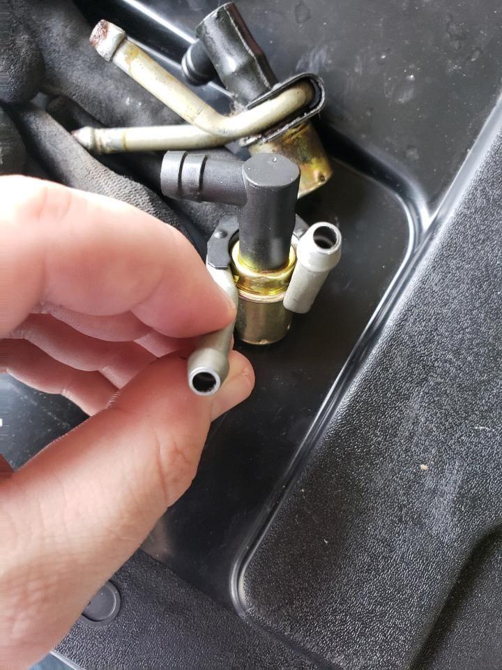

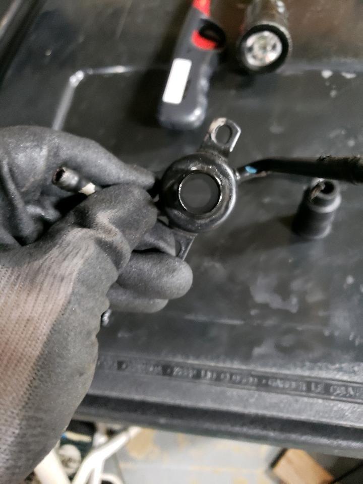

So IMRC and the bushings, got it. As for the PCV Valves, there is two on my truck for some reason and both have coolant lines on them. It's the one that attaches near the IAC that I had trouble with, had to look under a 2002 F150 to get the replacement part. The first picture is the PCV on the passenger valve cover. The second and third pictures are of the one next to the IAC but as you can see look different. The one I picked up isn't a Motorcraft part though.

I think my 03 uses the bottom version. Some tweaks between the range of years and from aluminum upper intake to the plastic one, I reckon.
You shouldn’t have two. Someone must have plopped one elsewhere because...they felt like it?

Hmm maybe I should put the original back on after cleaning it? Some gut instinct told me not to throw it out just yet.
Yeah, I’d hang on. I also edited to add a lot, so don’t chunk your computer yet.
