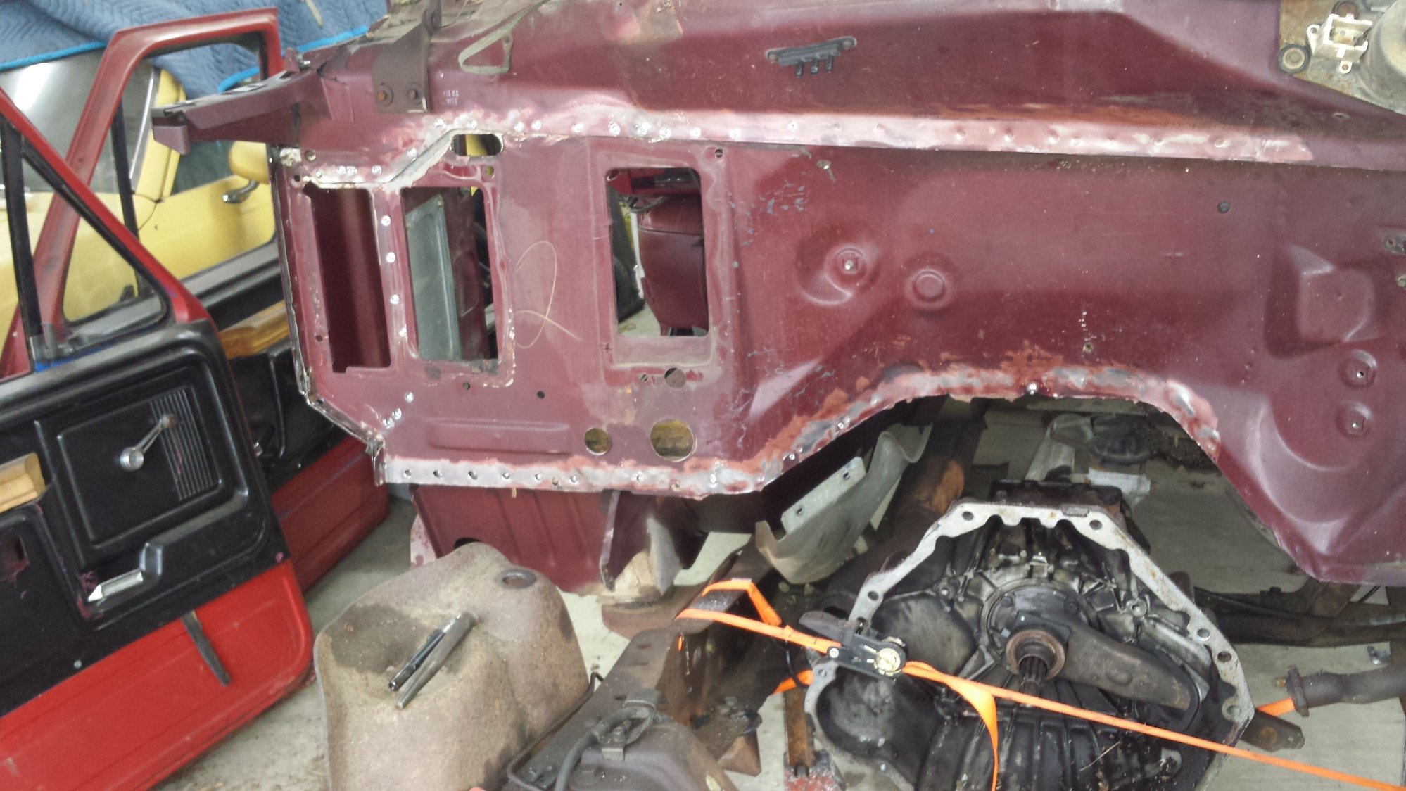

Don't know if this is the transmission you are talking of? It is a SROD out of a 81 with 300 six, best picture I have of it at this time.
It is a 3sp with 4th being OD. The bell housing does bolt on like the T18 & T19 transmissions.
On the 80 to think 83 clutch used linkage after they went juice.
The 80-86 trucks if auto and maybe a 3 on the tree did not have a removable pan above the transmission where the SROD, T18 & T19 did have removable pans to access the top of the trany.
I can also tell you the SROD & T18 use 2 different pans as the shifters come out in different places.
I know this is for 80's trucks but it may help you on your swap.
Dave ----
