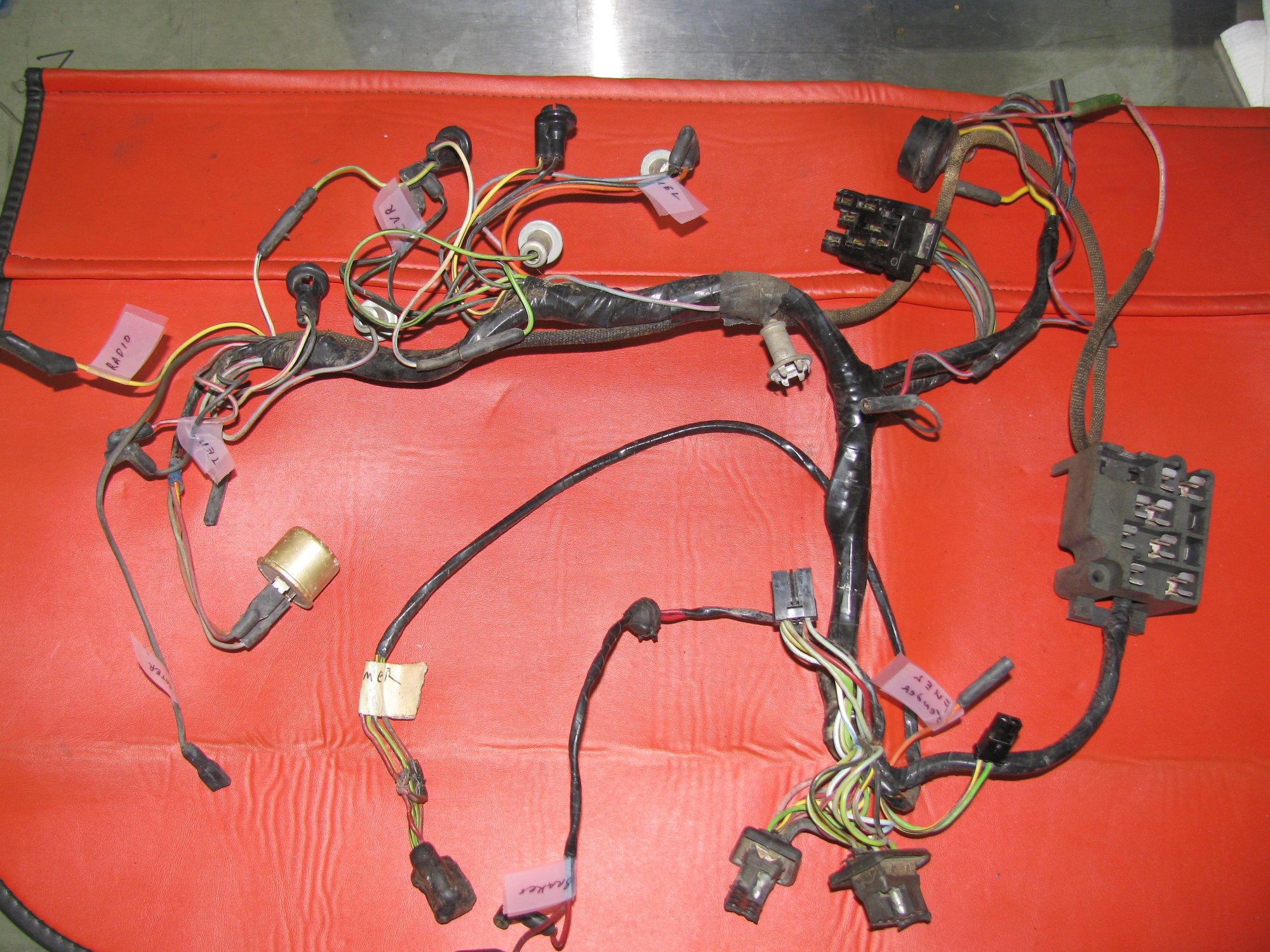

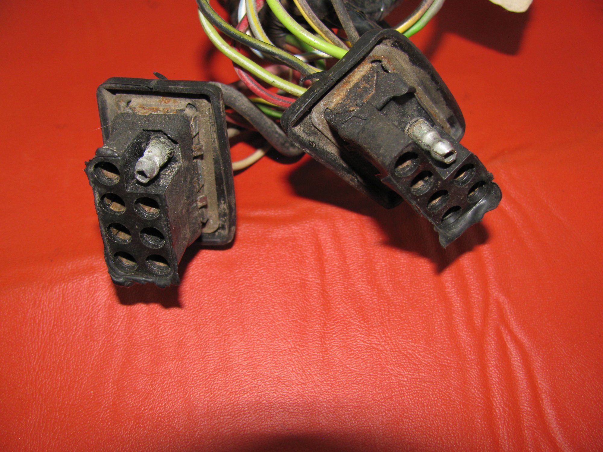

Originally Posted by daveengelson
Sent my email address, let me know if U did not received it, and at your convenience, my winter 'to do' list is lengthy.
Did not get it. I will put a couple of pictures here.

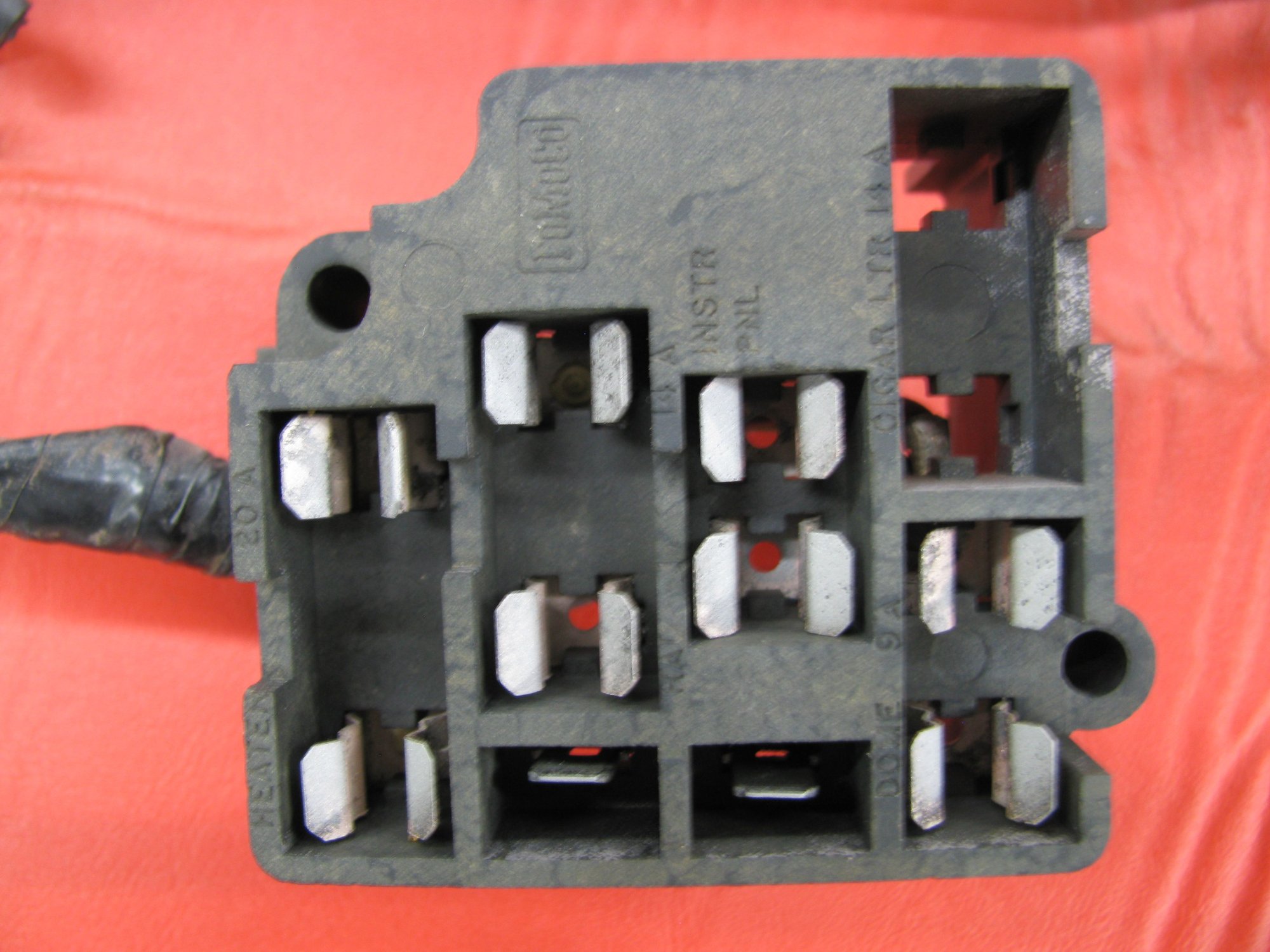

I am replacing the harness in the 65 styleside but in the process, one of the wires come loose from the fuse clip/retainer and in order to reattach the wire I will need to remove the clips/retainer, I have a couple of spare fuse blocks and practicing removing the clips and finding it can be a major time-consuming pain in the backside. I will probly go the route of removing the clips and soldering the wire but curious if there is an alternative fuse block I may want to consider should I decide to add circuits in the future?
Comments/suggestions appreciated.

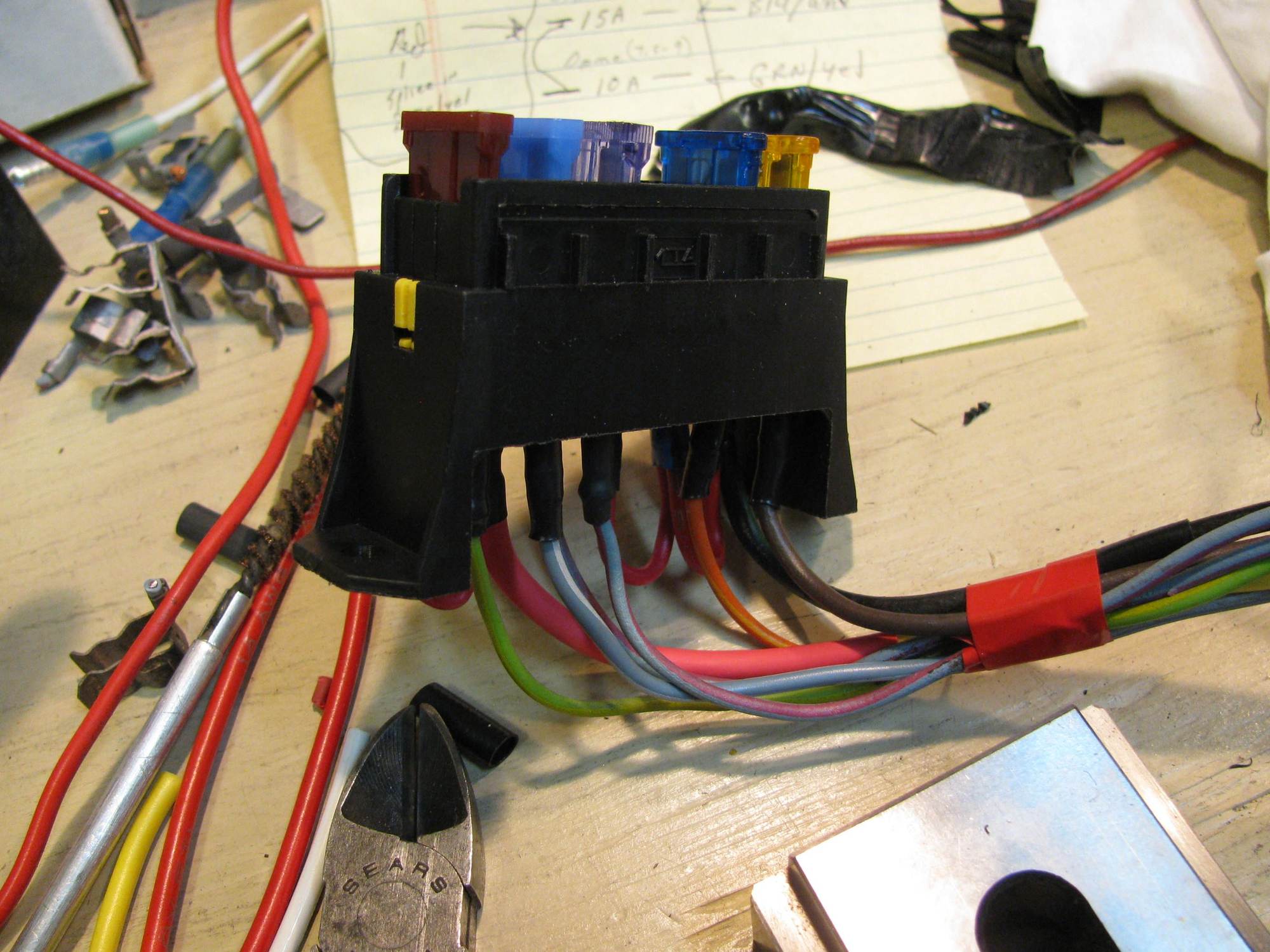

When I rewired my stock harness to accommodate circuits for the backup lights and neutral safety and no resistor ignition circuit. I changed to a 6 circuit ATC fuse panel. These things are super cheap on e-bay and there are a bunch of different ones. This one did require a spacer under it to get more clearance for the wires.

Thank you for the input and after sleeping on it decided to see how removing the clip and soldiering, if all goes well install the harness and be done with it. If I decide to keep the truck intend checking out a wiring replacement kit.
