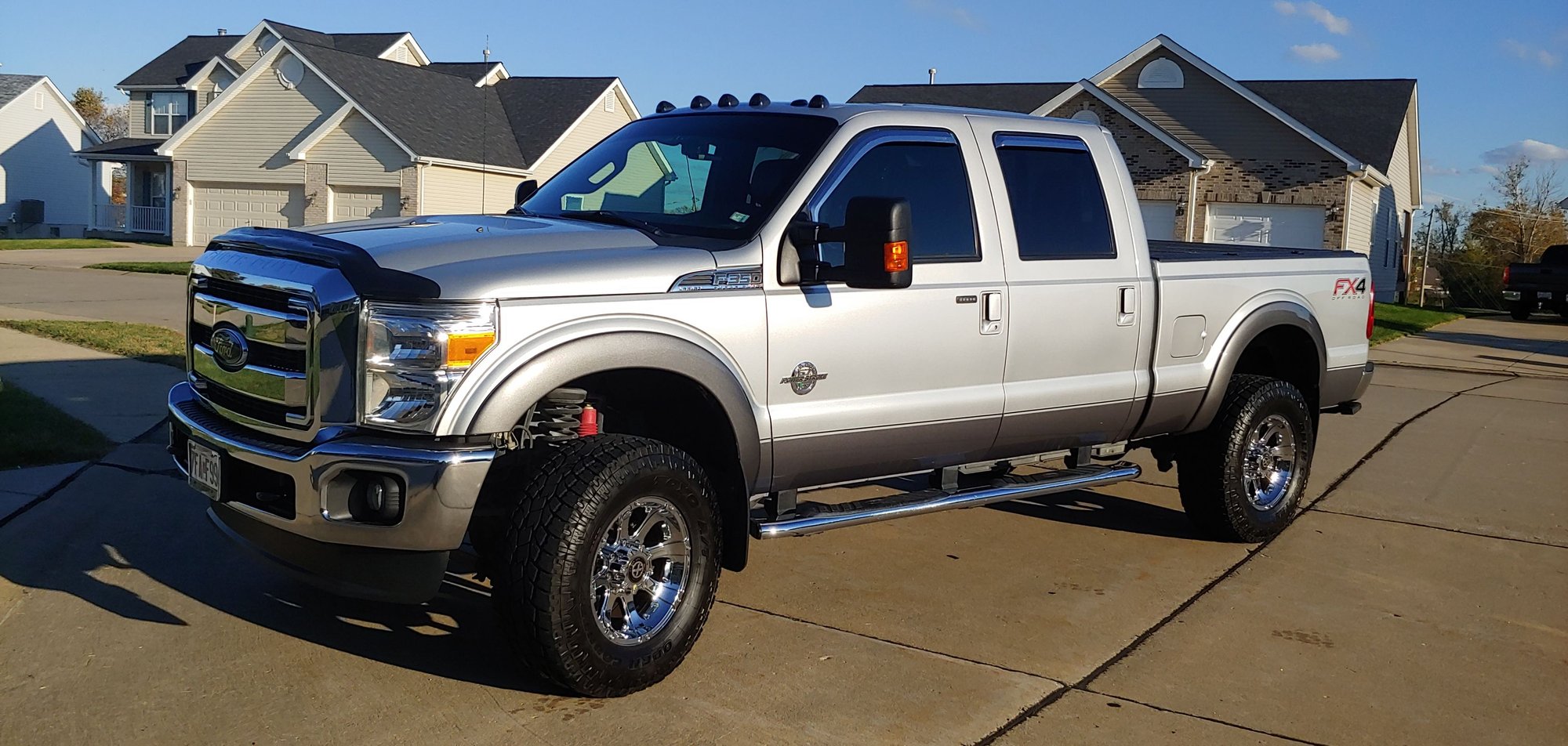

Ok Good advice there and can do. NOW I'm wondering though - PO told me it has 4" lift. It does have 12.50x35 x 18 Toyo Open Country tires on it. I thought the spring blocks in the rear were part of the lift - apparently the factory blocks were 4"?? Looking at the Rough Country dual stabilizer but they have one for 2" to 8" lift and one for stock. Been driving myself nuts looking at spec sheets etc trying to figure out whether or not it's lifted. Just measured and from ground to bottom of front fender is 43 1/2". Total roof height is like 84". Any ideas on what I have?

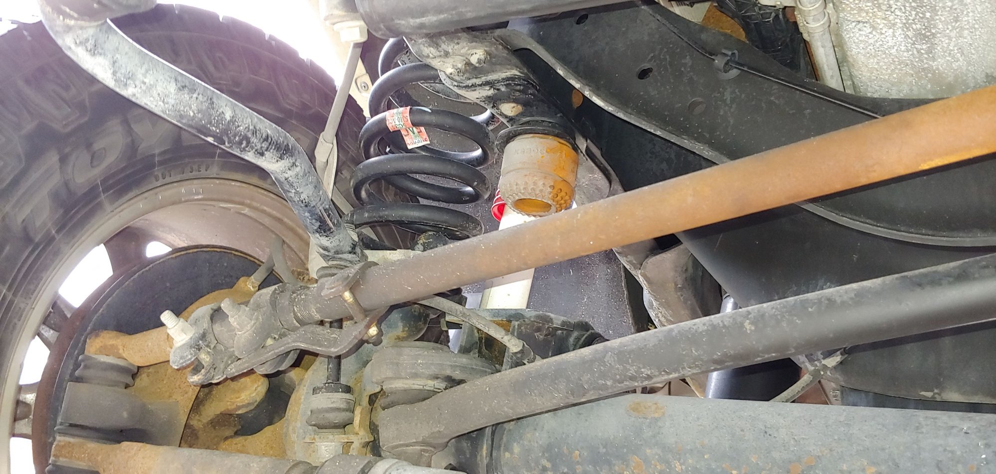

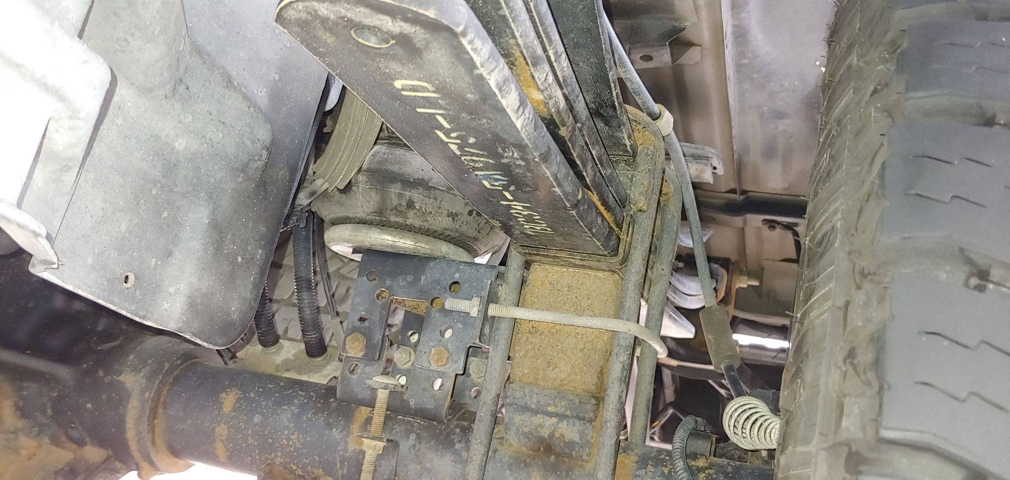

Well - first time uploading pics on a forum since photobucket days. Hope I did it right... Couldn't figure out how to get text and pics both. Anyway - I think I've discovered that in fact it does have a stabilizer. There is an extra bracket on the tie rod and I had removed some ubolts that were just hanging on the tie rod before - which is why I thought something was missing. SO - looking at these pics - has this thing been lifted?

I see a stabilizer off the rusted tie rod/drag link.
It's the one with a stud pointed downwards and the black cylinder parallel with the axle.

Yep, there's the stabilizer.

It can be difficult to judge perspective in pics but I'd say no. Looking at front wheel well space, even if those are 35's, you're close to stock. I would say definitely not a 4" lift as you said in Post #1
