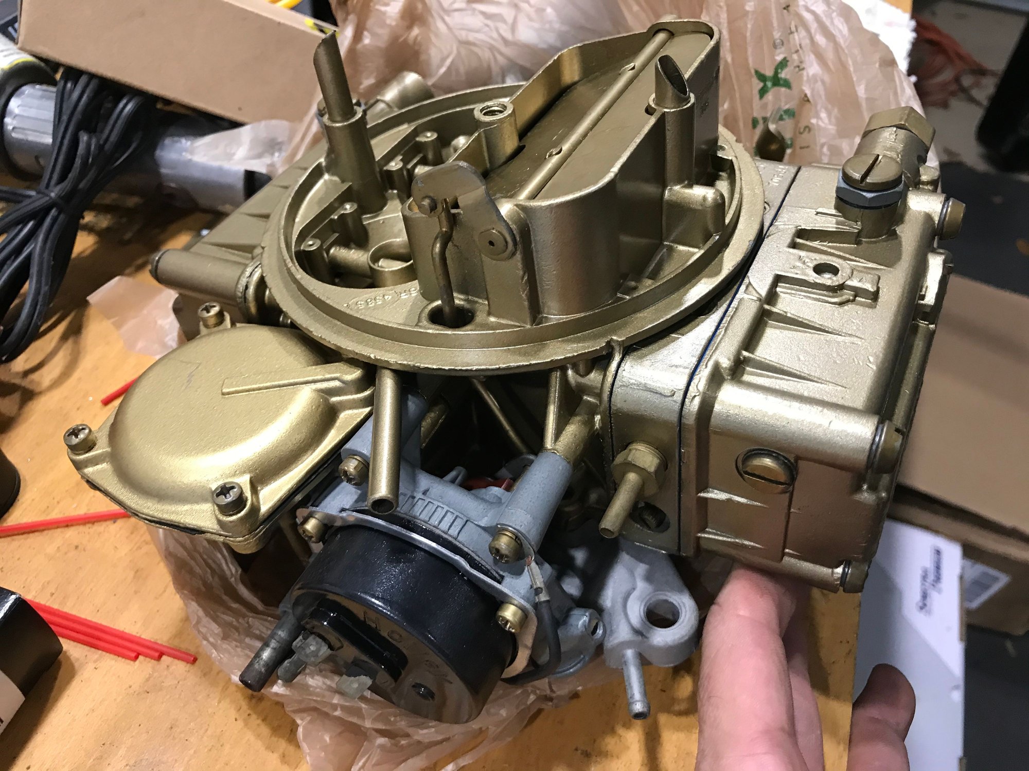

-I have a 4160 Holley looks like and my old 2bbl had manual choke from POwner (which I prefer)(gonna wait to order manual choke for this carb until I get others things done).
-In the meantime, where do I grab power for this electric choke?
-Do some of you just put 12v on a toggle switch for morning starts and work it manually?
Thanks,
JB
