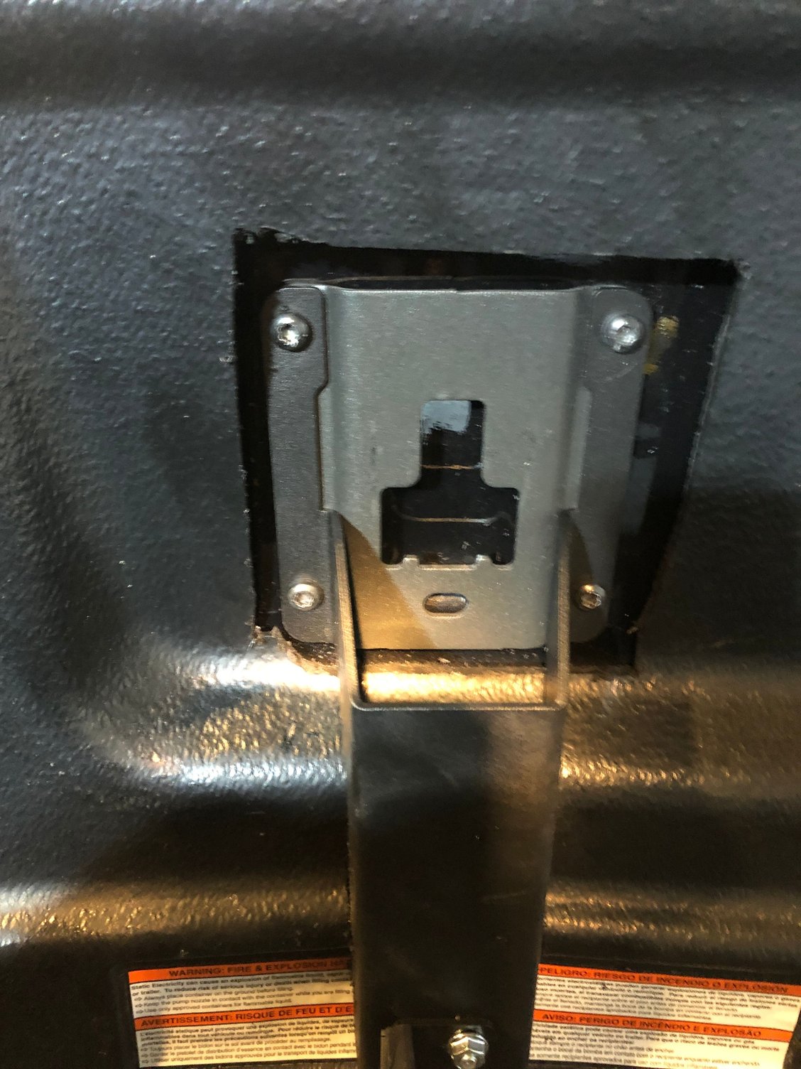

Installed mine this morning. Here's a couple of pics of the trimming I had to do to the drop in plastic liner. Made the existing hole around the Box Link larger to be able to get the bolts out without dropping them between the liner and the truck bed as well as being able to fit the bracket up to the Box Link plate. Also made 2 slots in a rib on the liner for the bracket to slide into. Sure glad I've got one of those oscillating multi tools. Might have been a bitch with a utility knife!
The Box Link didn't seem to want to slide down far enough inside of that bracket to reinstall it so I didn't bother. It won't really be used with the tool box there anyway.

Those oscillating tools are so handy! That looks good. Im thinking of throwing one on the other side now.....
