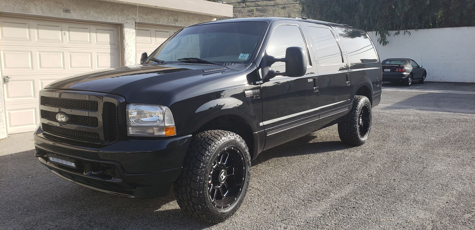

Another thing I have recently found out is, my Ex does not have a rear sway bar at all. I intend to have a Hellwig 7643 bar installed in the rear and upgrade the front as well.
Back to the steering issue, I hope someone can direct me to the drop axel pivot brackets to bring the alignment back close enough to adjust without removing the leveling blocks.
I have attached a pic of the Ex after the upgrades. I only hope I can keep the stance as is.

Originally Posted by Jdubbb
but not like it did before doing the upgraded wheels, tires, and leveling blocks under the coil springs.
this is a tricky post to reply to on the internet and one i would feel much better doing in person after having inspecting the vehicle and driving it.
”steering issues”
most likely the problem is caster.
while the alignment shop is going to tell you that +2.6* is technically within “factory spec” I find the Ex needs more caster to be comfortable to drive.
on the 4x ex i find +5* + 6* of caster to be what I prefer. however I have not done a altered RWD is so long I do not have a preferred setup to recommend other then it likely needs at least 4* of caster before you are going to feel comfortable driving it. fyi. +4* is also within factory spec.
Upgrade ?
not sure where you got the idea that you were “upgrading” at least as far as performance is concerned, sure it looks neat but you have altered the parameters and settings that have been engineered to give a certain level of performance and unfortunately for you, you have taken the setup the wrong direction to actually upgrade any actual performance gain.
drop brackets.
Nobody makes an off the shelf 2” bracket setup that I am aware of.
procomp and fabtech do make a 6”
2” would be a custom fabricated situation.
there are other solutions as well but all require custom fabrication from a knowledgeable specialist.
fwiw,
a rear sway bar will take you further away from the ride comfort zone.
it will help reduce understeer a little but honestly that is not worth the jarring ride it produces and should not be an issue that needs addressing unless you are trying to drive the vehicle hard on twisty canyon roads or doing autocross time trials.
final thought.
Sweet looking Ex, I dig the street fighter look.
