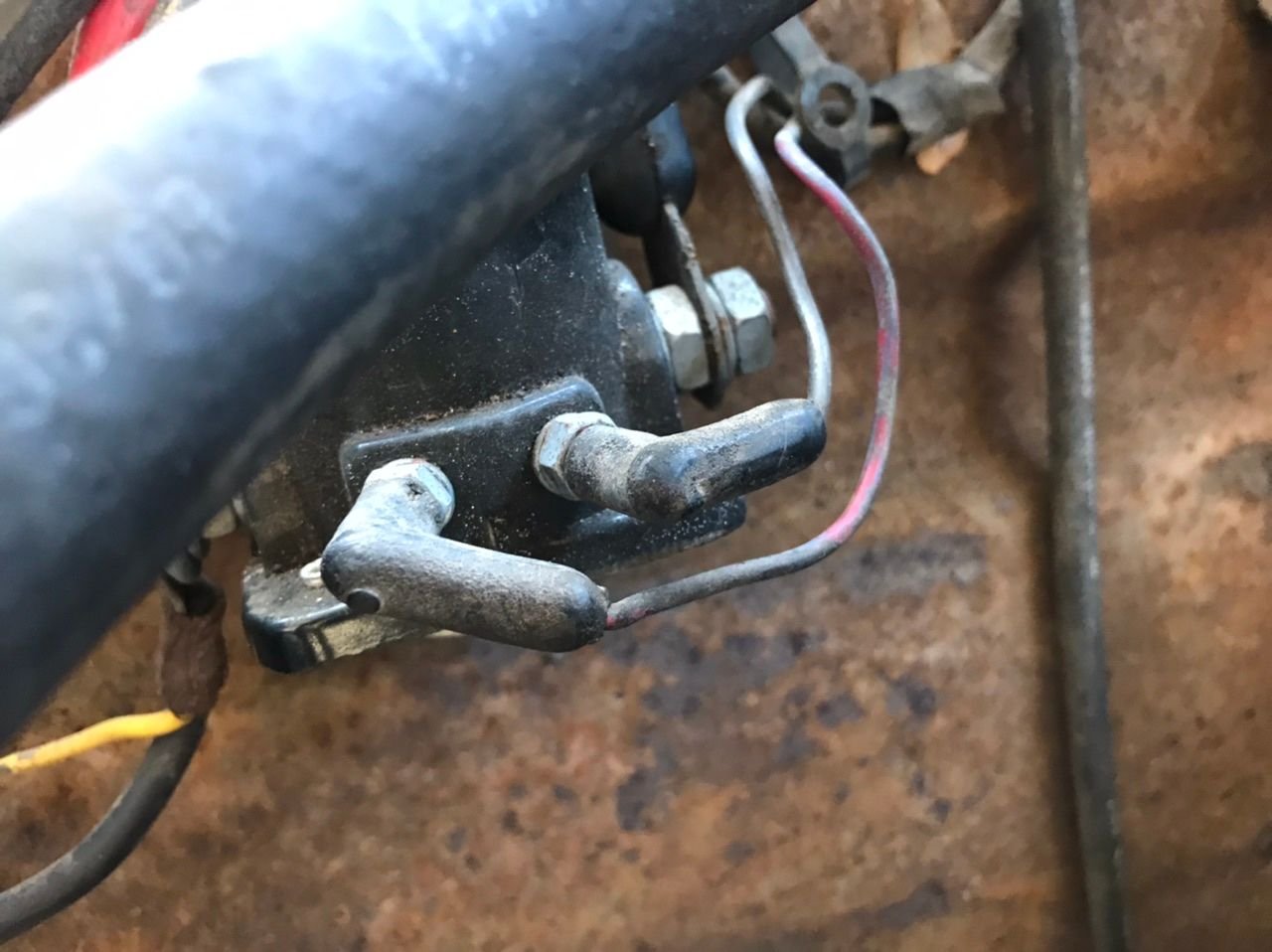

-In regards to the fan, direct to the battery is one option.
-But as I was wiring the fan, I thought about the starting solenoid and seeing as I can’t get to the back of the starter (against the head almost), well comments below.
- On the right side of the starting solenoid as you are facing it. Looks like a brown wire.
-I have 12v= Key on only on this side (brown wire) and zero bolts with key off.
-Question, can I run the fans relay off that stud so I’ll have fan off when the key is off?
-Just thinking about it.
Thanks,
