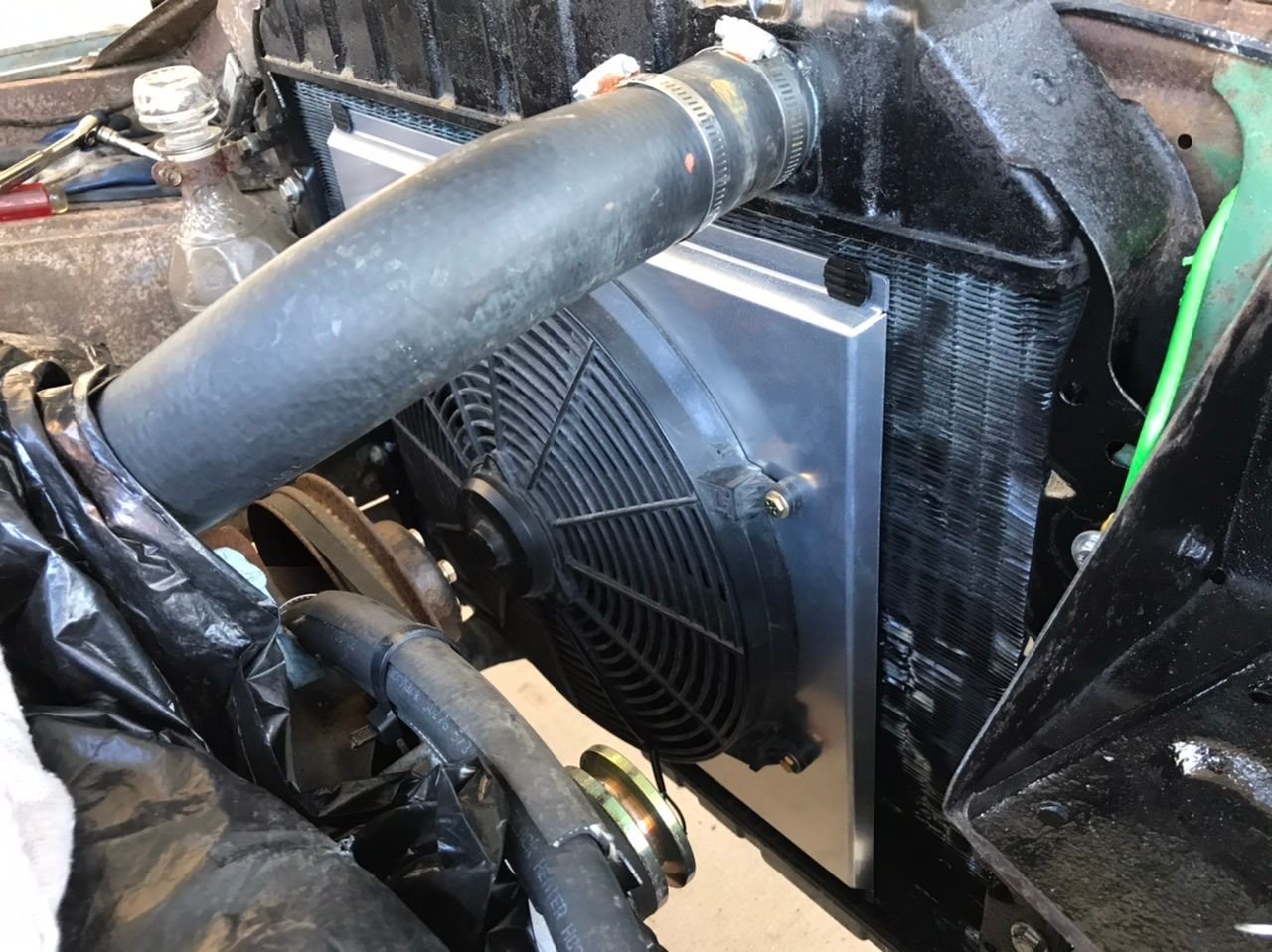

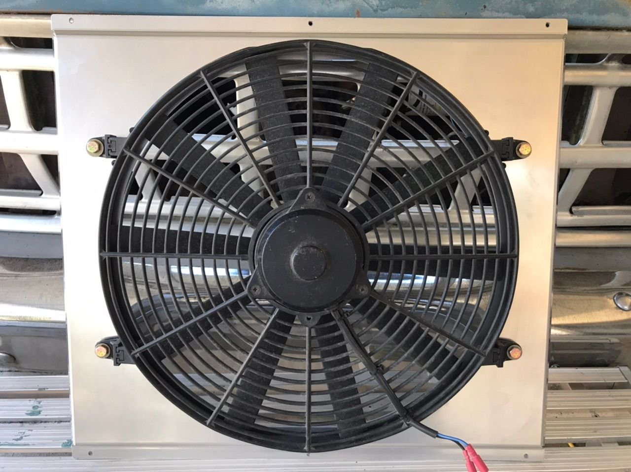

-Mounted the fan to the aluminum shroud/radiator.
-Used 1/4x20x1” grade 8 with nyloc nuts.
Looks good. Lots of space in there now.
Thanks, and I might add a second belt to the alternator, which the E-Fan makes that easy enough.
Just a though: after I mounted the fan, I should have made studs for the fan in case it needed to be removed.
The 4 mounts have a counter-sink impression in the plastic and I was thinking I could get some THIN 1/4x20 nuts on the bolt to hold, thus creating a stud for fan removal.
Just a thought for further down the road, or someone in the future.
Oh Well.

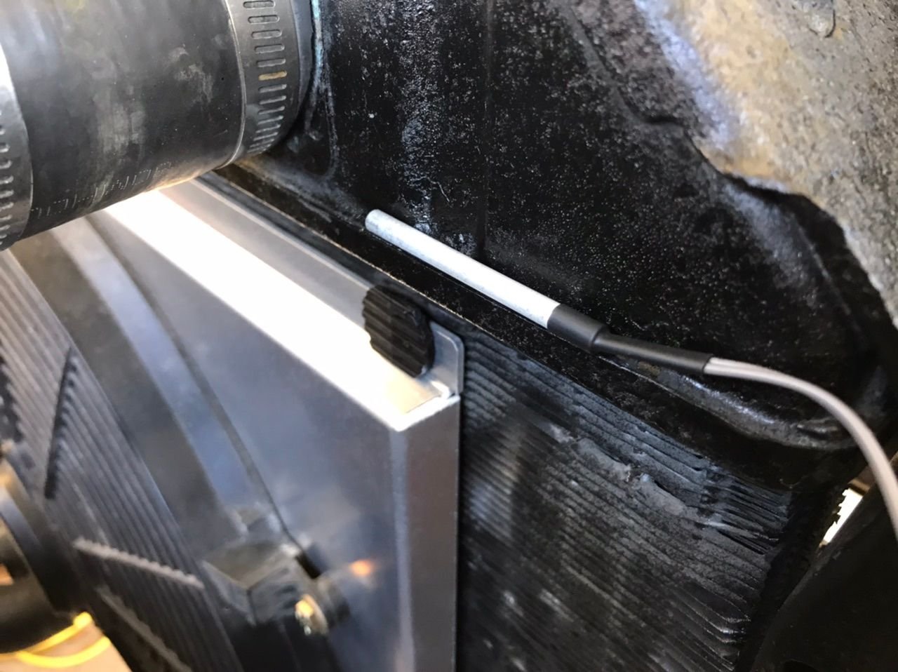

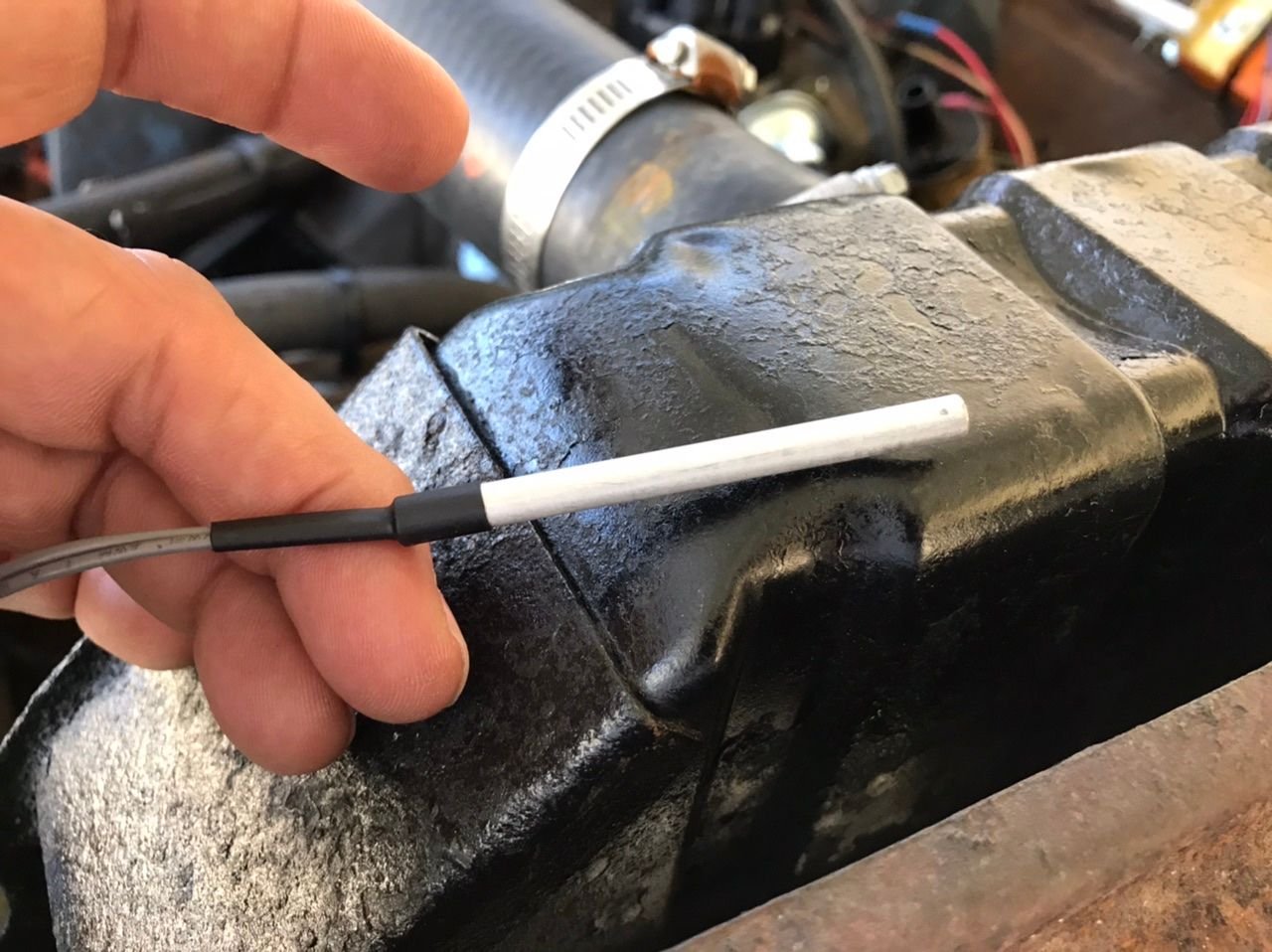

The Hayden prob is to big to fit the fins if the radiator.
Where else can I mount the sensor, to the top radiator hose?
Silicone it to the radiator tanks lip?
I don’t want to force it.
Thanks.

You can use a #2 Phillips screwdriver to work a hole through the radiator fins. Needs to be placed near the inlet hose on the top to be effective.

-I was looking through the fins and the OEM radiator seems to have a extra fin (looks like/hard to tell).
-I'll try again to see it I can get the sensor through it.
