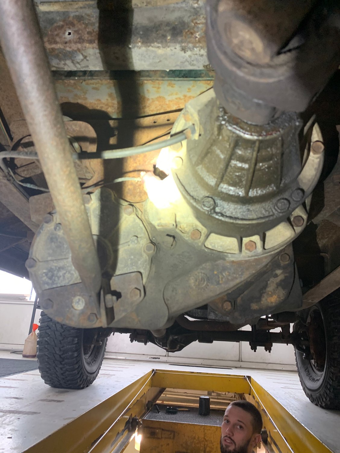

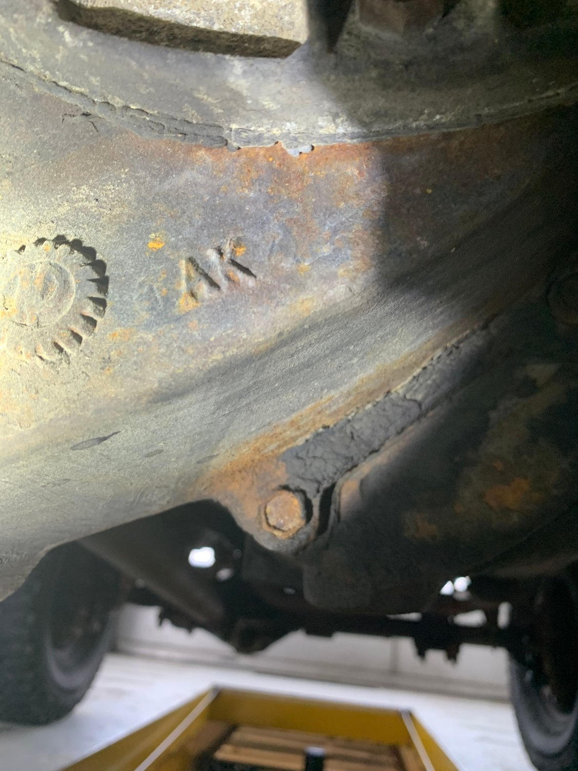

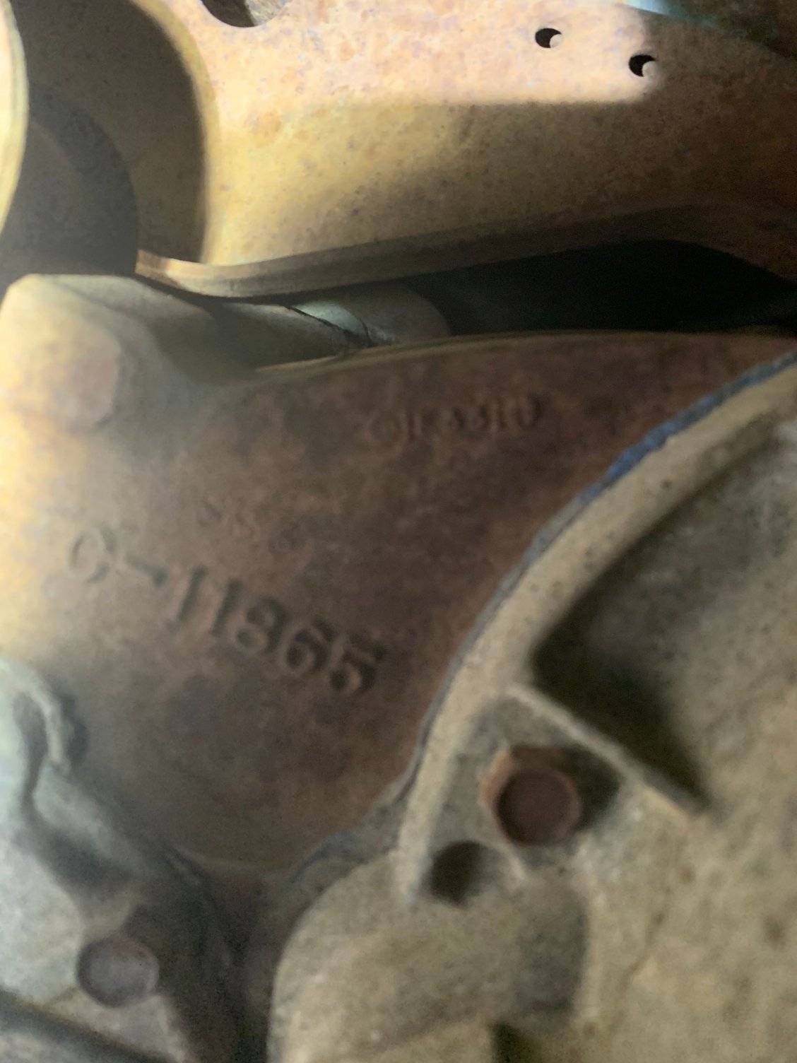

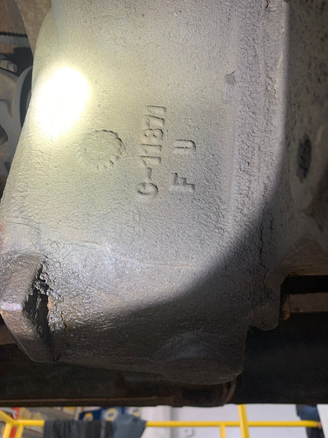

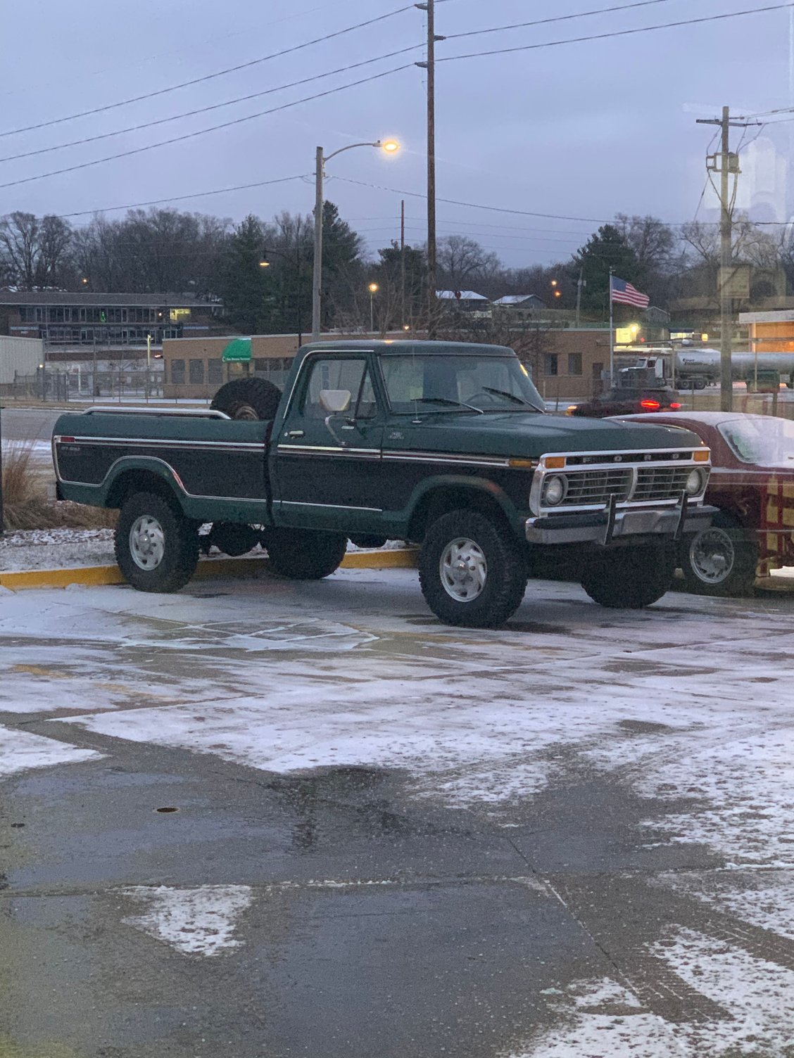

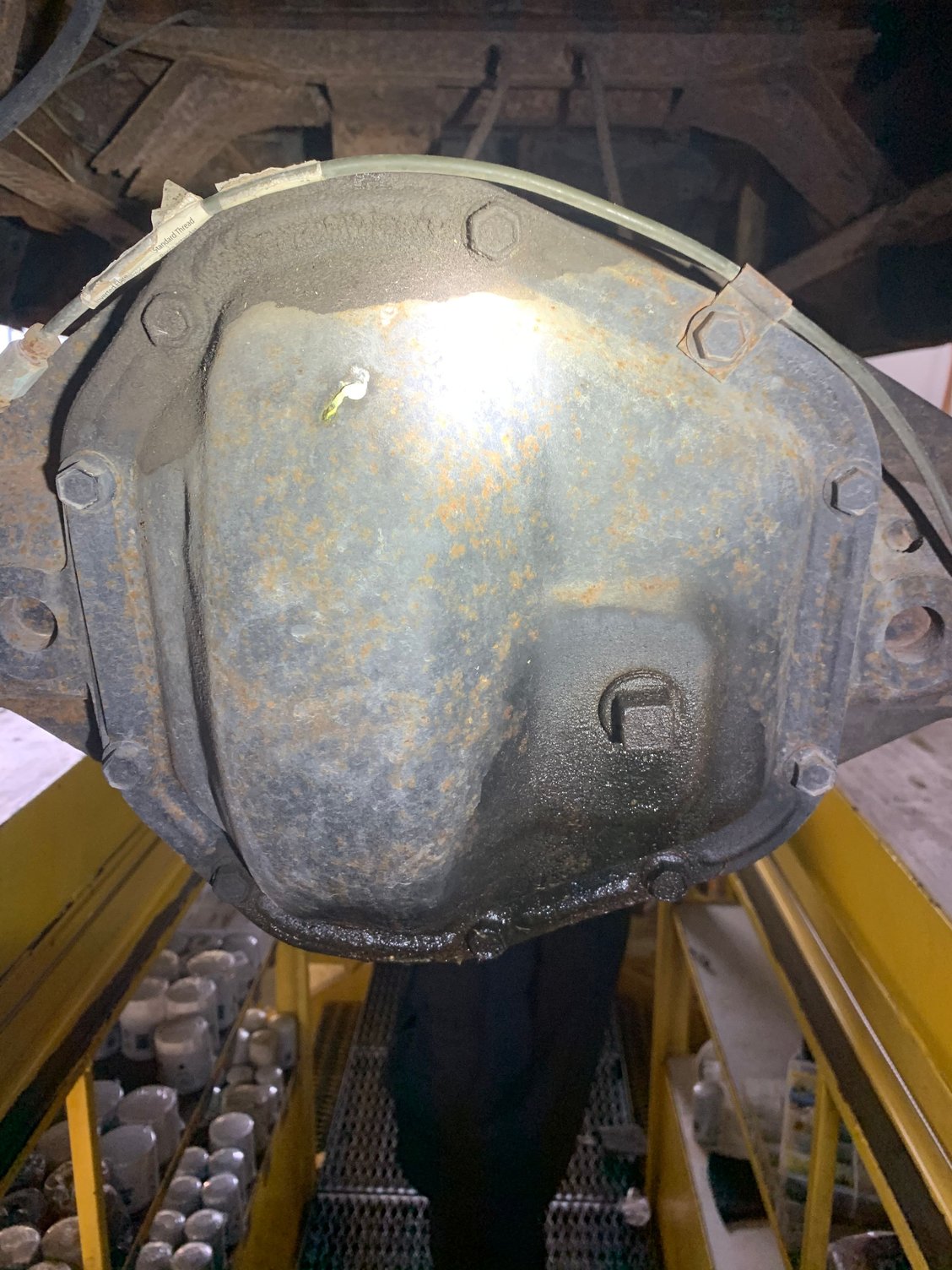

Early 77 F250. 400 with C6 and divorced tcase. Full time 4x4. Trying to correctly id the axles and tcase. I believe it to be a 60 rear and HD44 front with a NP203 but looking for others inputs. I was told that they should be 8 lug but this truck is 7 lug front and rear.

Do you have pictures of the wheel lug pattern? I've only seen 7 lug bolt patterns on like 1 or 2 years of F250s in the 90s. This 77 should definitely be 8 lug, but you never know what people have done over the years. The T-case looks just like my NP203.

Aftermarket wheel COVERS.
You have a Dana 60 rear, Dana 44 front, and a New Process 203 transfer case.

Thank you for the reply. I was thinking the same. How do I tell if low pinion or high pinion front? Also, I've been told they should be 8 lug. Was this maybe newer model diffs swapped in or did some come with the 7 lug? Thanks again.

The wheel covers are just covers, if you pop them off you should have 8 lug wheels underneath. The front should be a low pinion. If you look at where the driveshaft connects to the pinion, if it is below the axle centerline it is a low pinion, if above it is a high pinion. I can see in one of your pictures that it is a low pinion.

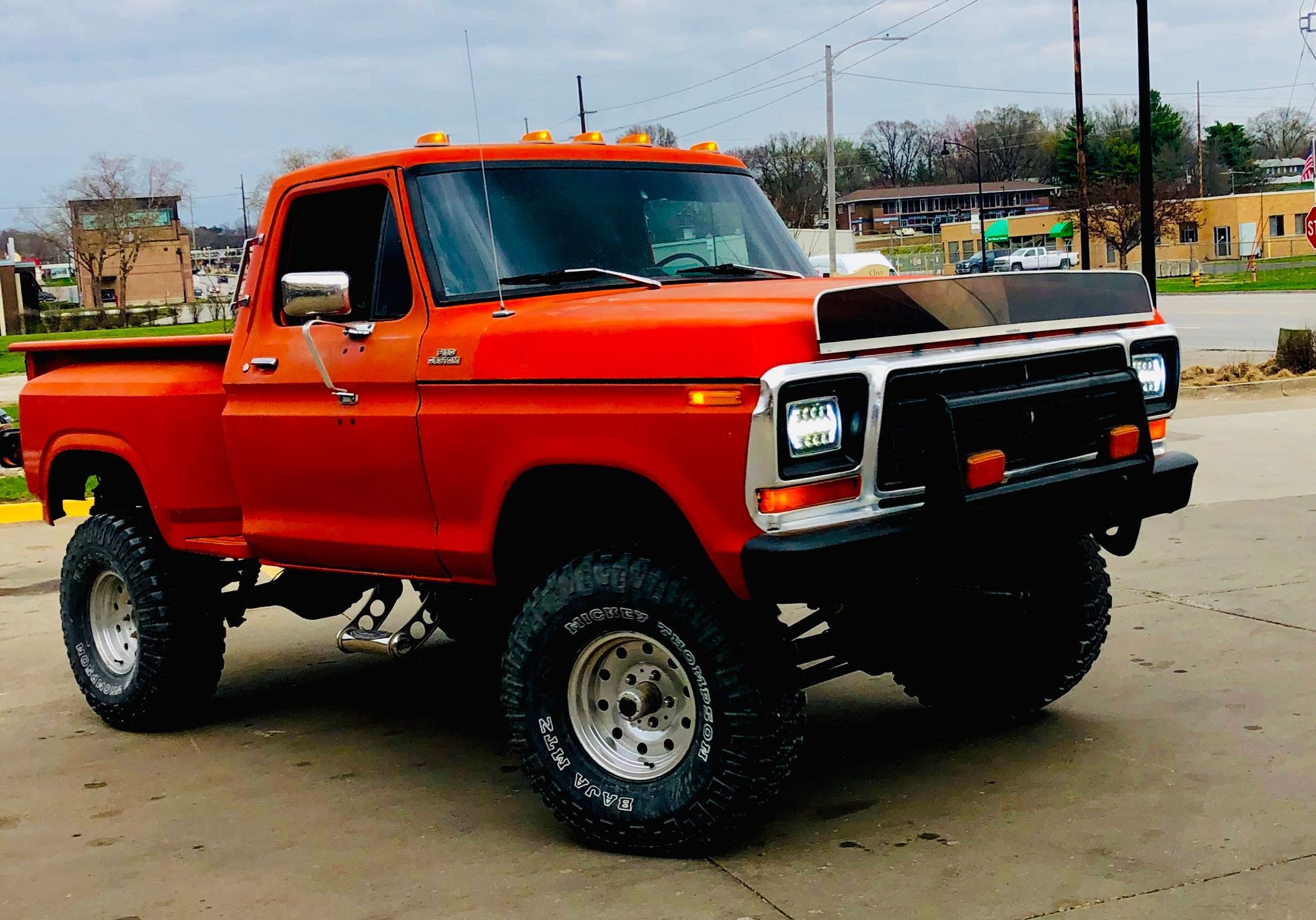

This one I just purchased last night. Got it for $2K. I also have a 79 F150 (big orange)
