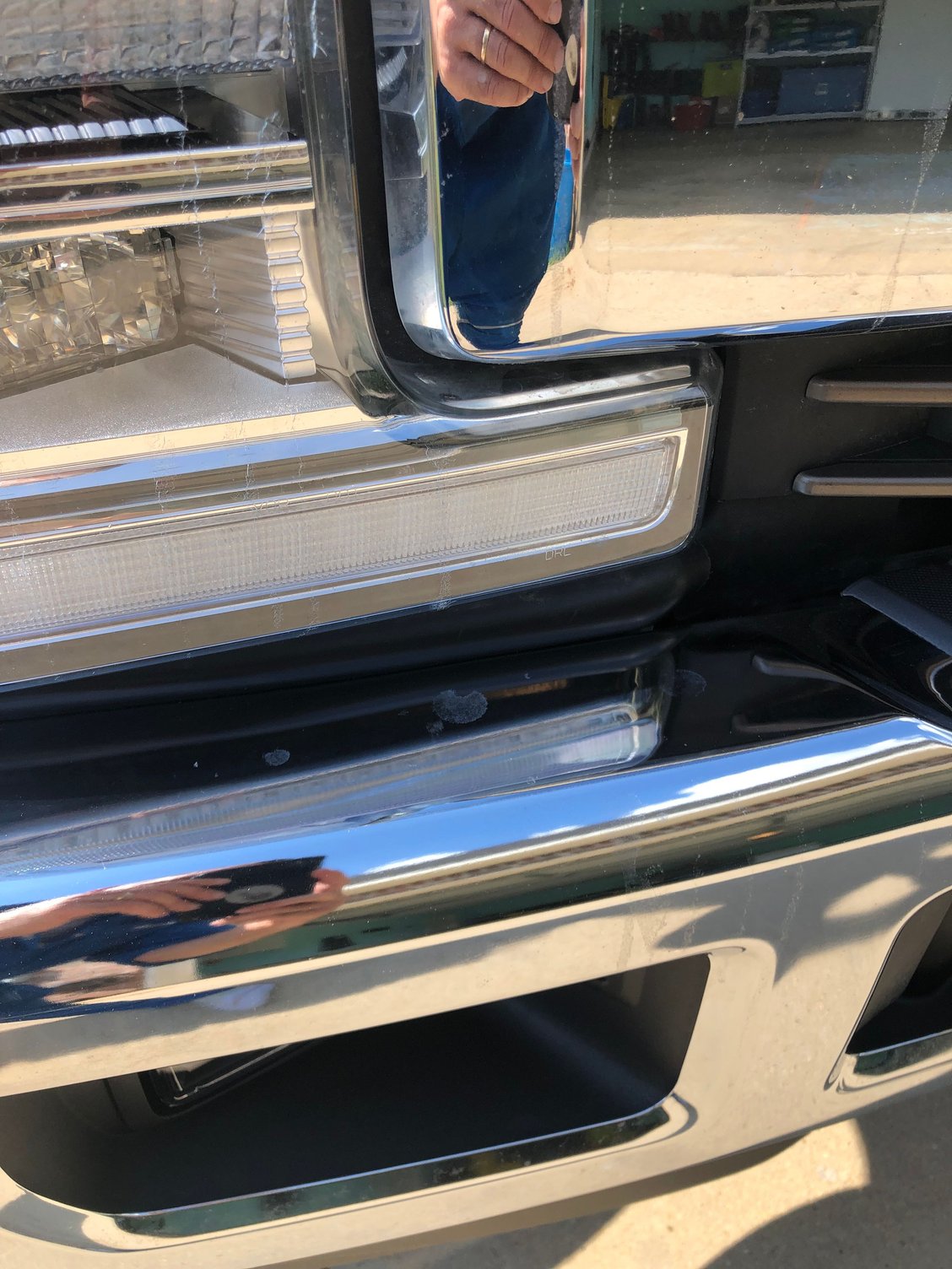

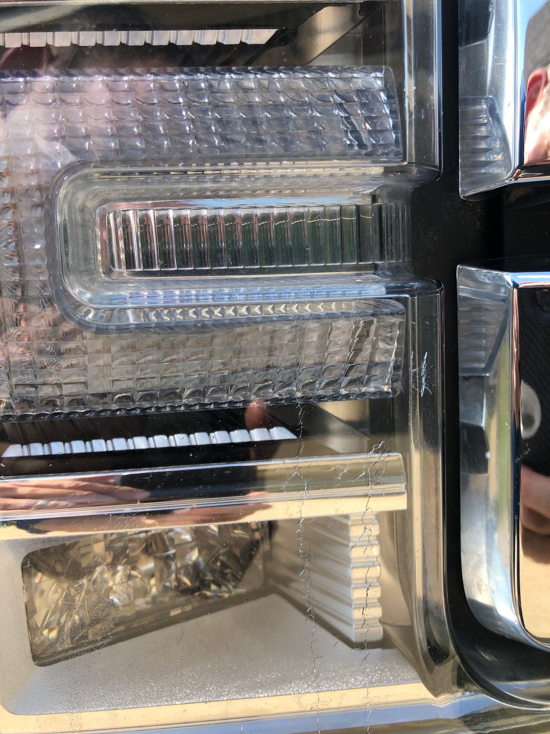

Does anyone know what could cause this? I brought my truck in for an oil change. Picked it up an noticed two streaks running down the light and a small puddle on the bumper. Tried to wash it off when I got home but seemed stuck on there. I had to fly overseas for work. Came back a month later and it’s crazed from the inside. Outside is smooth. Ford says they didn’t do it. I made some fuss over the 1500 dollar light and Ford will pay 500, dealer will pay 500 and want me to pay 500

Brake fluid maybe?

Is that some on your grill and bumper, too?

Trying to understand how a liquid on the outside surface caused crazing from the inside out. The crazing must be on the outside surface even though the surface feels smooth. May be possible to buff out using one of those kits made to clear up old, hazy headlights. Because these products remove any scratch resistant coating the OEM may have placed on the plastic lens, I would take an extra step and have Xpel or similar paint protective film applied to the light. Probably do both lights for $200 or less.
Seems like the dealer and Ford is trying to step up by sharing the cost to replace the light. It makes sense that the dealer caused the damage but there is no direct proof so they could have remained in denial mode. $500 is a hard pill to swallow. If you have the light replaced you should keep the old one. Never know, you might need a backup or someone out there may be willing to buy it. For someone with a busted light, $500 for a replacement, even with the slight crazing, may be considered a bargain.

There have been a few reports of crazing/cracking of the LED headlights. Do you see a direct correlation between the puddle spots and the vertical crazing lines? I can't imagine what could drip down the outside of the lens and cause internal crazing.

Maybe battery acid, if they removed the r/h battery it lines up with it.

maybe they cleaned up with brake parts cleaner when done?

Definitely looks like something dripped/ran down the headlight and caused the crazing. What caused it, who knows. That sucks though, not a cheap fix. Some plastics just really hate certain chemicals and react.
yes it is.
