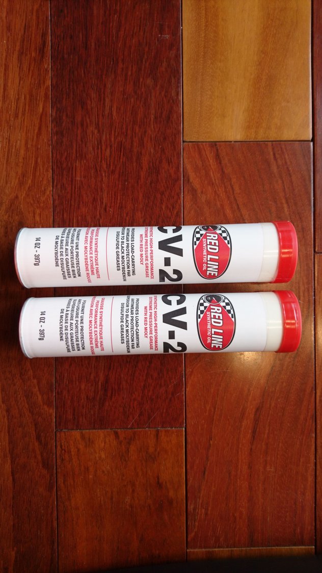

I just got this for all my Zerk fittings:

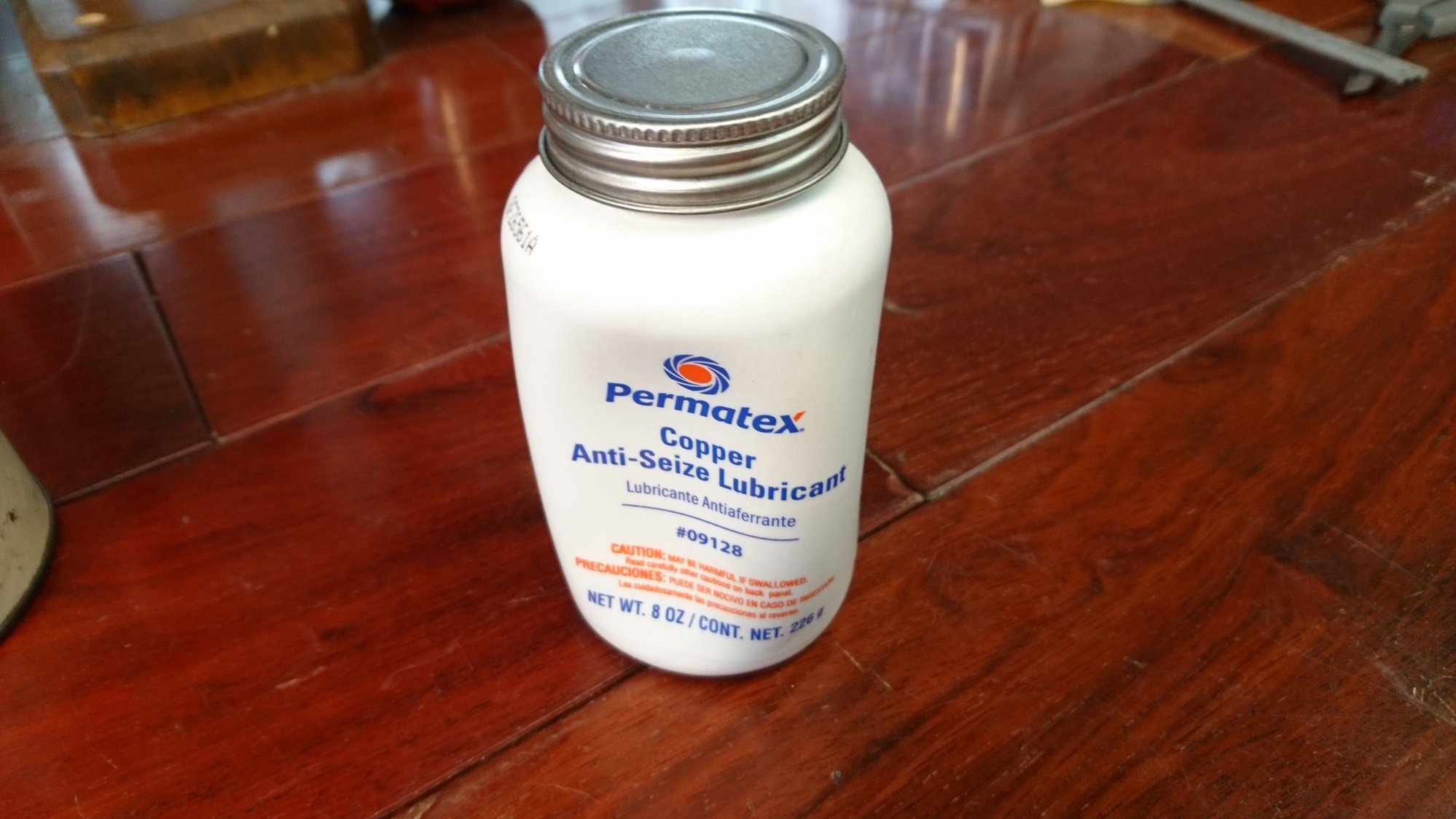

For high heat areas, like brake slide pins, I use this Permatex lube. Works really good on my tiny stock C5 brakes that develop a bunch of heat.

fwiw, i tried my permatex anti seize on my brake slide pins and the froze up, went back to motorcraft brake grease.

I'd definitely recommend using an actual silicone brake grease for slide pins. Anti-seize is more of a corrosion prevention measure than it is a lubricant.

Interesting. All the Corvette track/race guys run this Permatex on their pins. I drove pretty hard this past September at Road Atlanta and they held up pretty good. I'll pull the pins out this weekend and take a look.
Thanks for heads up.

track guys likely R&R their brakes more often as well as have different needs, I do my Ex pins once a year right before winter and last yeR when I did them the permatex was thick and tacky my brakes were dragging bad, noticed it because my typical brake temps were rising beyond what i like. ( i check brake temps as well as hub, tire diff at every stop when i am towing ). easy to catch impending doom
