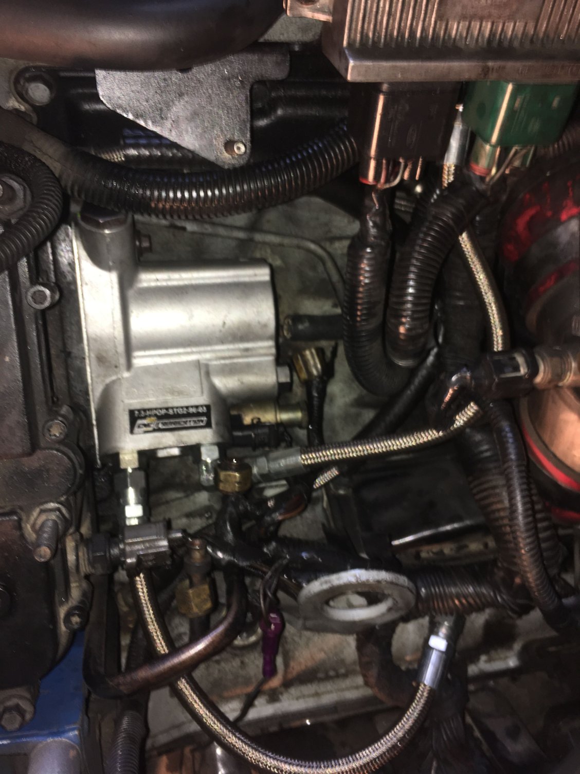

So a few months ago I picked up this CNC Fab Stage 2 HPOP and CNC Fab HPO lines. I finally got a chance to install it today!!!!
Here’s a few pics of my dirty old 460k mile truck getting some LOVE!!
Finally time to stop just opening the box staring at this sexy HPOP!

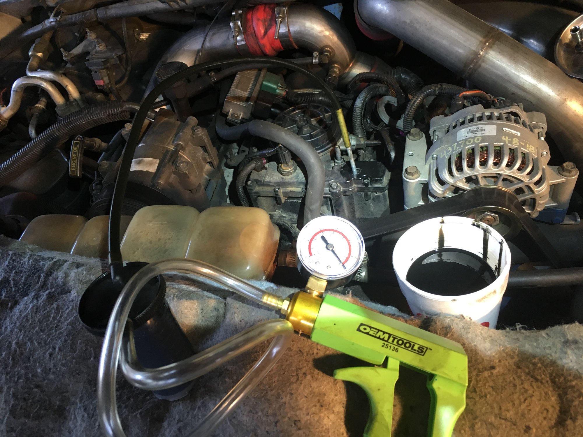

Top end oil change?? Lol, just pumping reservoir out so all that oil doesn’t run in the valley when the pump comes out.

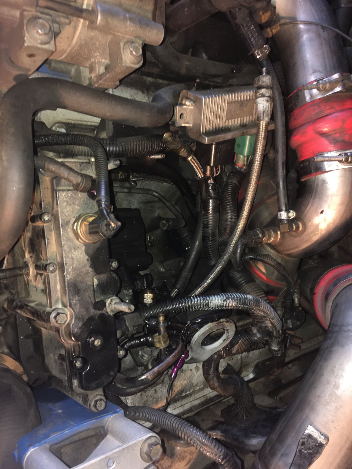

The CNC Fab HPO lines are awesome and a no-brainer upgrade.

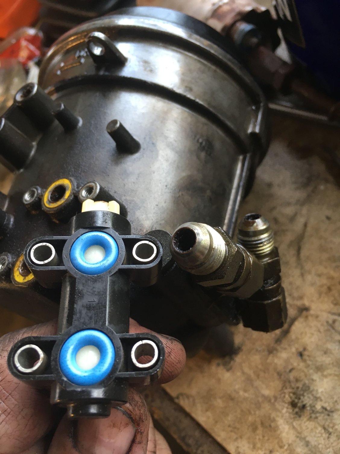

I had a new Motorcraft IPR on the shelf, but I put it in a customer’s truck day before yesterday.... This one is a ‘good used’ IPR I had.
Might as well rebuild the fuel bowl drain valve! Sooooooo much easier with filter bowl out of the truck. $7 well spent!!

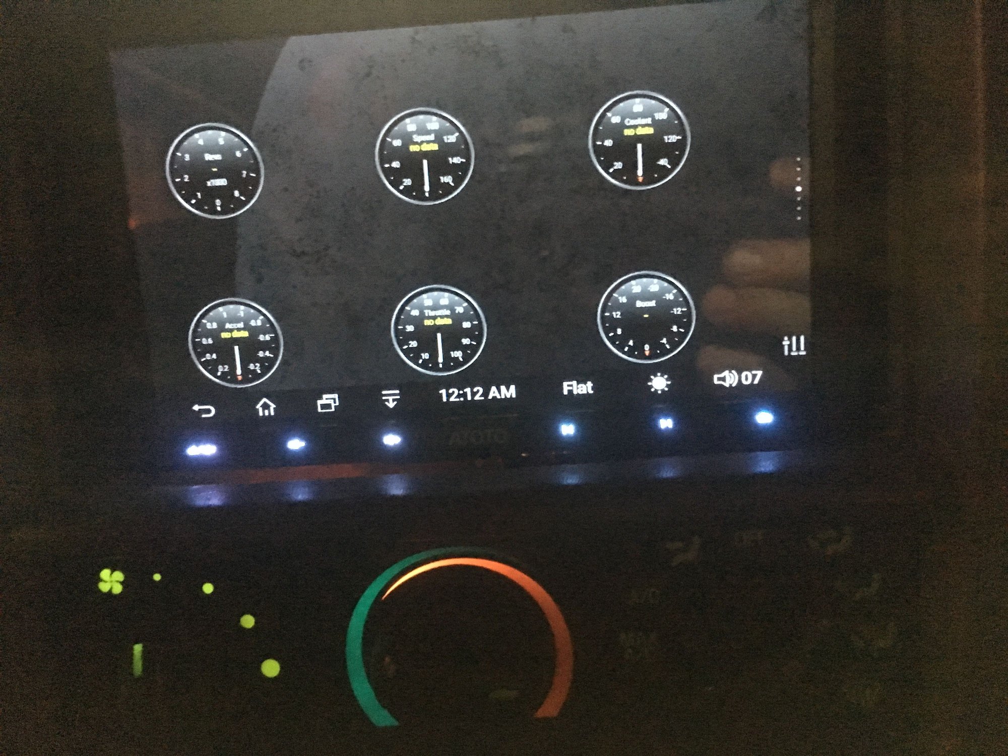

We put about 40 miles on it going to visit friends. I didn’t hook up scan tool for the hard data, but HELL YES my truck finally runs good again!!!!!!!! Hoping I can install this knockoff android head unit and torque pro tomorrow. Then I’ll have some data to report!!

Gonna put some loom on the HPOP lines?

Yes, I put loom on those SS hoses. You must protect everything from this abrasive buggers!! They will eat a hole in anything they touch!!

I’ll try to get torque pro set up in my new head unit so we can look at some data logs.
