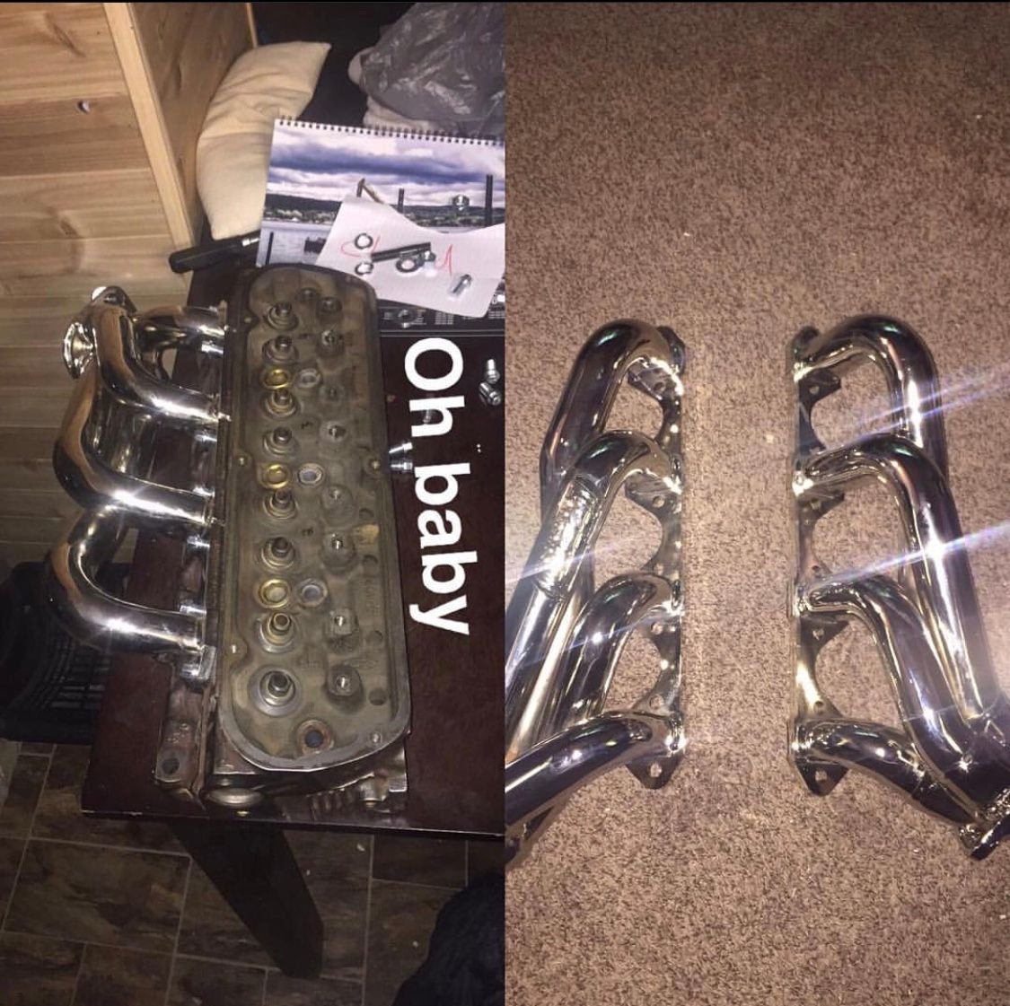

Hey man , I’ve done the same thing but I have a 5.8L. I end up getting BBK shorty headers. They fit perfectly. I highly recommend them.

Those are the "P" heads, with the plugs at an angle?
Do you remember the part number? Any pictures with the plugs installed? What are you installing those in?
Are those truck specific headers?

those look like mustang, my driver side #8 snakes in front of #7 then down. I can get better pic if it stops raining.
driver side 8 snakes in front of 7 then down
no I think they are meant for mustangs. But they fit well
