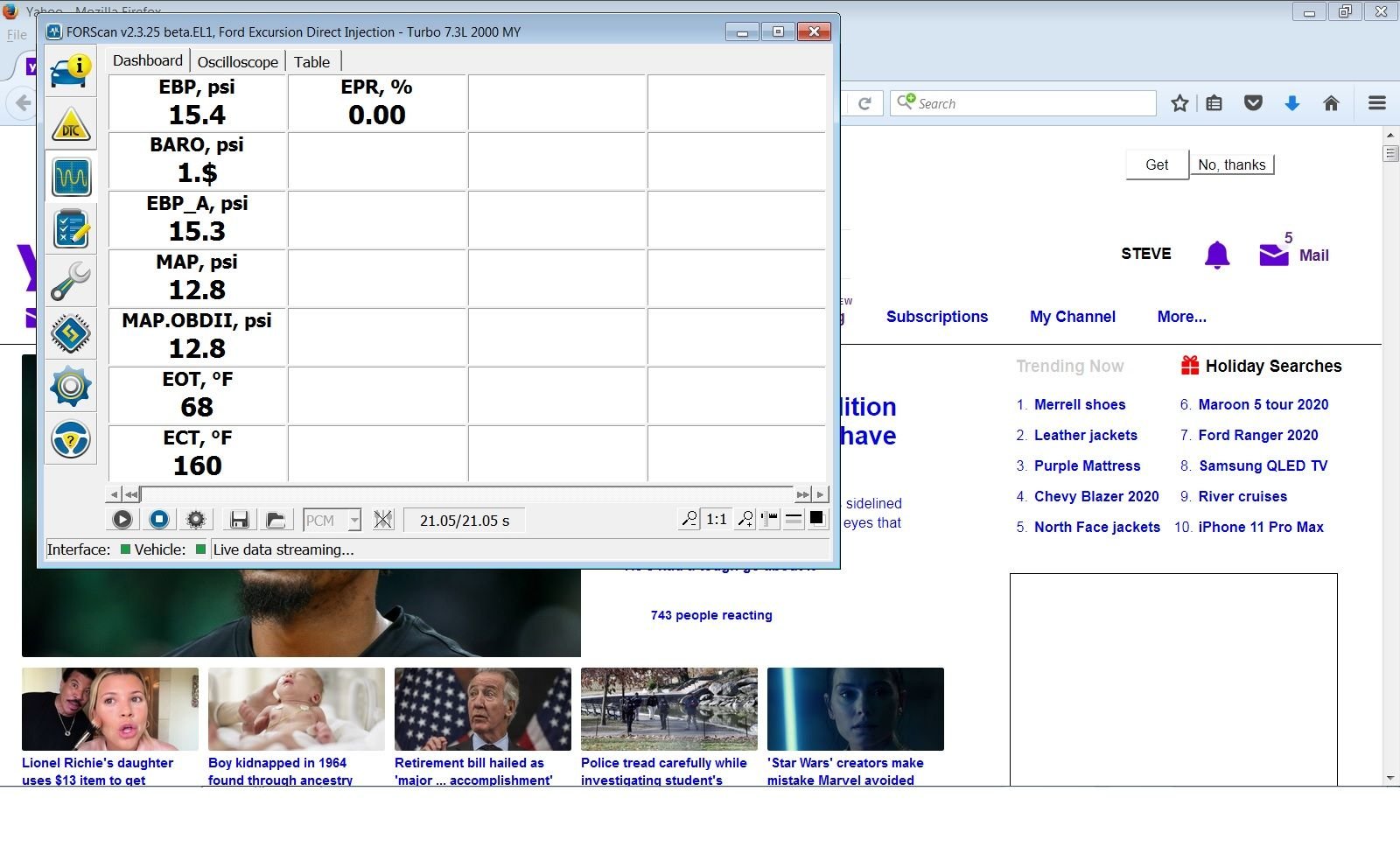

I have been been playing around with FORScan and able to get some data from each truck. However, I am wanting to look at the EPB, MAP, and BARO readings that should be within.5 of each other with a cold engine and KOEO to determine if those sensors are in good shape. The PID's show psi for those and I'm assuming this is correct? One was at 12.?, the other was at 15.?, and the last showed a 1+?...I will need to go back and look at those. I think they were the same on each truck and I know the tube on the F350 has holes in it, so I know that needs to be replaced. Both trucks have been suffering bad fuel mileage...about a couple miles per gallon hand calculated...and looking to get that back up to where it needs to be. The Excursion has also recently started a little bit of a whine noise when my foot is in the throttle which may be the turbo, but will check the wheel for play. It has also been having a SES light on which has been related to individual glow plugs but when checked this morning is now related to the GPM, so I will check connections at the large black and green plugs...which I've suspected all along but I haven't been able to get them off to look at. The Excursion has 231,000+ miles on it and the F350 has about 189,000 miles on it.
Within Forscan (and TP), sometimes there are more than one PID for the sensor you are attempting to check. Also, make sure the values or measurements (PSI, KPA, etc) are all set to be identical and something you are familiar with and can read.
Were there literally ? (question marks) in the digital gauge/readout? I am assuming you inserted the question marks because you do not remember the last value, but when troubleshooting we need to be as detailed as possible so that something is not overlooked.

Okay, so here's the readings I pulled off the Excursion this morning...going to do the F350 as well after I post this. So what's up with the BARO reading? Also, the EBP and MAP are not within the .5 psi, so does that mean the EBP sensor and/or tube are needing attention? I am purdy much at sea level...

...and here are the readings from the F350 that are purdy much identical to the Excursion. I know I have issues with the EBP tube having holes in it...which I wouldn't think would affect the reading with the KOEO, so I am guessing EBP sensor on both needs replacing? Still not understanding the BARO reading and see 2 other separate posts started that are having the same issue. The only other BARO reading that can be selected in FORScan is in HG and not psi.

are these engine running or KOEO
Trending Topics
Old Dec 21, 2019 | 01:45 PM
bwguardian's Avatar
bwguardian
Joined: Dec 2007
Posts: 2,039
Likes: 310
Done with Key On Engine Off.

where in Tx are you. Trying to figure out what your pressure should be

Between Houston and Galveston...the elevation here is about 22'-24' above sea level.

So the ebp looks to be the correct one at approx 15 psi. check your map tubing for obstructions. may have a bad map sensor.

I returned both trucks to stock programing and did the test again. The Excursion wasn't quite cold as the EOT was 134* even though it had been sitting for a couple hours. The EBP was at 15.1 psi and the MAP was at 14.7 psi, so this is within the .5 psi though I will check it again in the morning. The F350 was cold with the EOT at 58* and the EBP was at 15.8 psi and the MAP was at 14.1 psi, so this is not within spec. The BARO on both trucks is still showing the 1.$ which is confusing. I know the EBP tube on the F350 has leaks but wouldn't think that would have anything to do with the readings at KOEO. I know I need to at least order the tube for the F350, but I'm trying to determine if I need to order a MAP sensor too; in addition to doing the same for the Excursion...both trucks fuel mileage has dropped off a bit.

So I hooked FORScan to the Excursion this morning that has been sitting overnight. EOT is 68*...it sits in the garage next to the water heater...and the EBP is 15.3 psi while the MAP is 14.6 psi. The BARO is still showing the 1.$ value, still not sure what's up with this...
