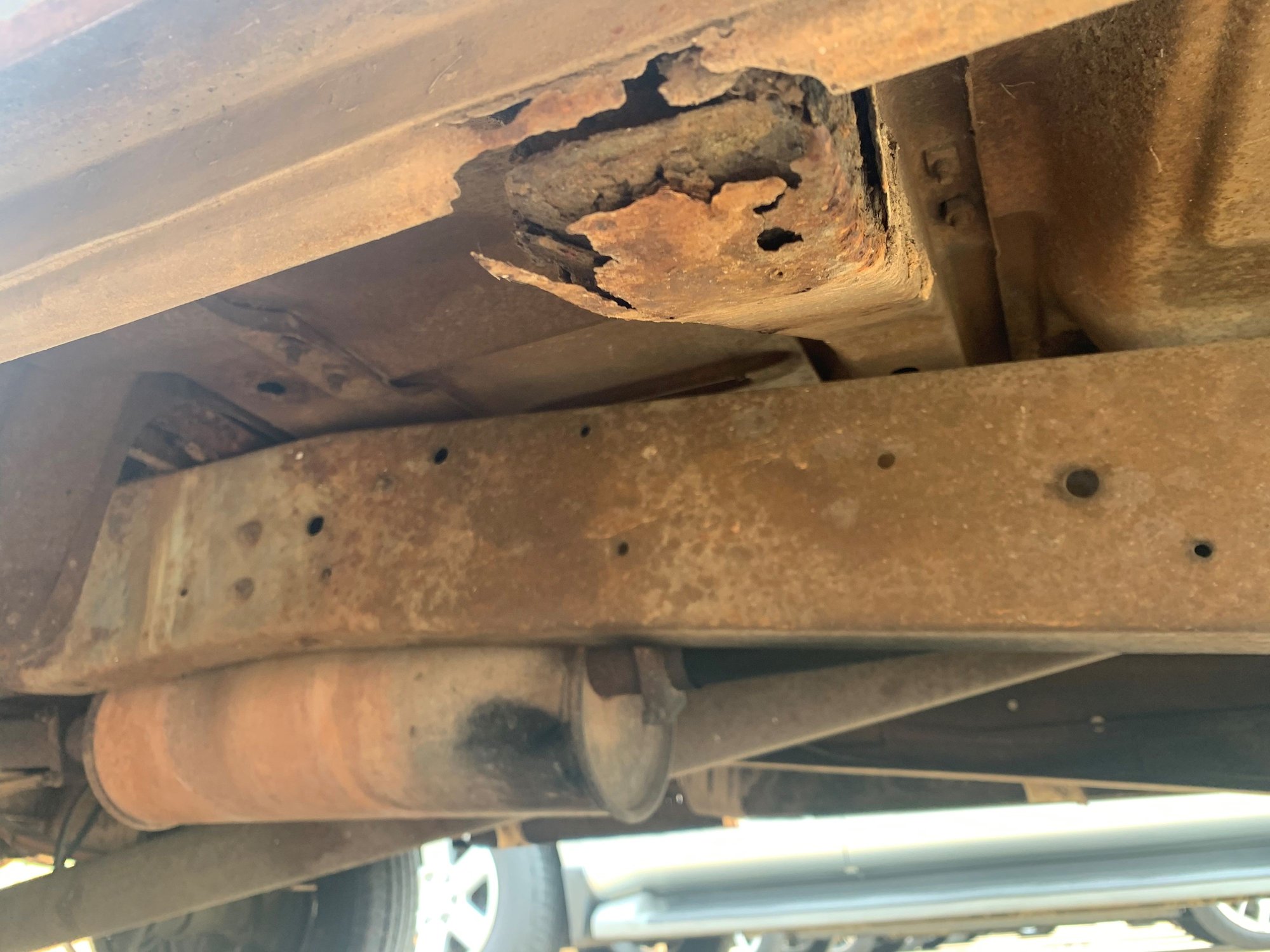

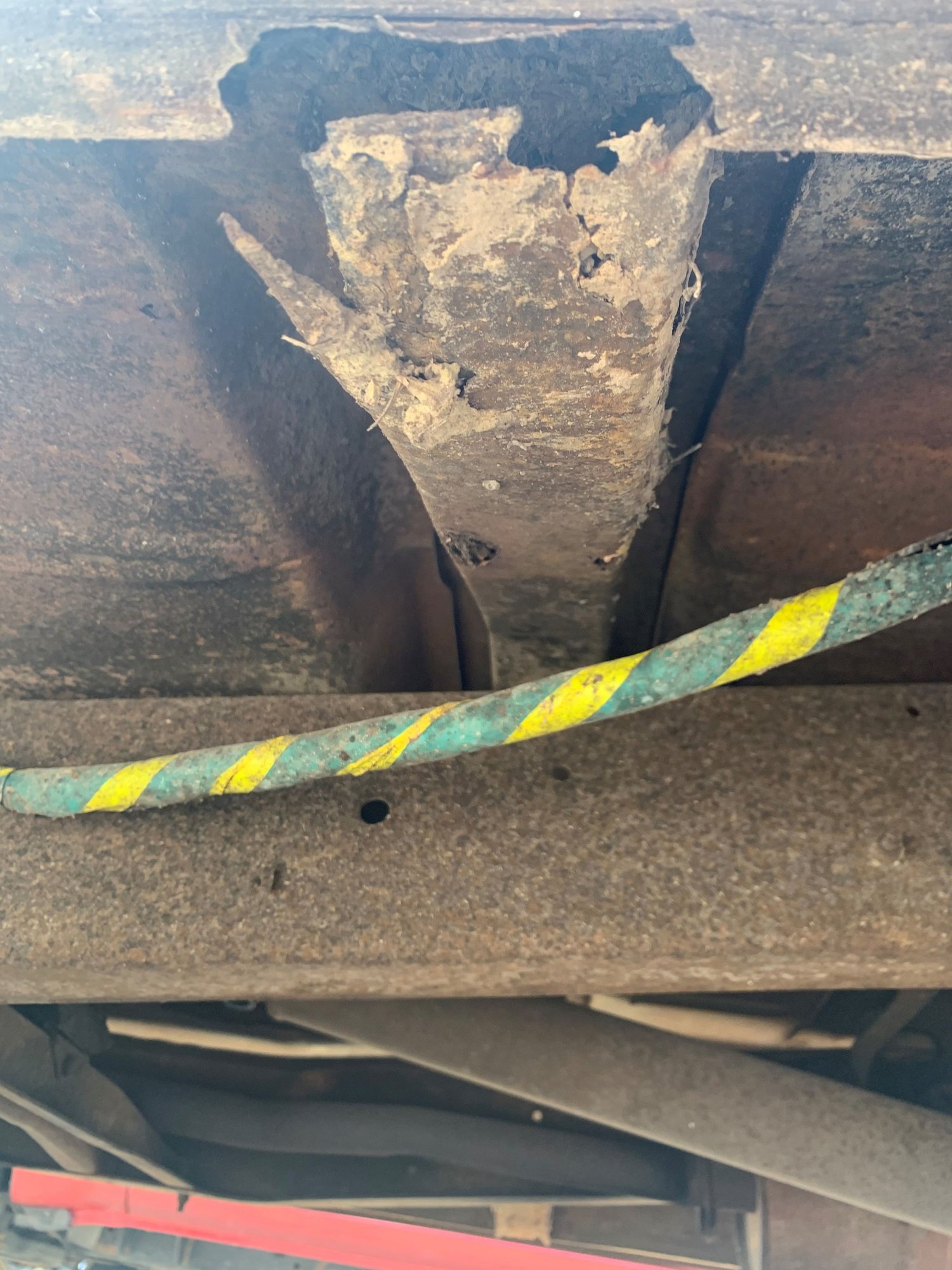

Hey all,
I hope this is in the right section but i just had a general question. Im looking at purchasing a 65 f100 (been looking for a 60s model for awhile)
and found this one for sale at a dealer of all places. Everything seems pretty solid, some rust in the rocker panels and door panels and such but overall pretty solid except for what looks like the cross member for the cab. Since i dont really have any help with this purchase im looking for some input. Would this be a deal breaker for yall, i got it down under 2000 for the price. It does run and drive and stops also. I should also say, the drivers front door rubs the fender when opening, was curious if yall thought there might be some alignment issues because of the crossmember. Thanks for any help. It is much appreciated.

Cab support ends are common replacement items it seems. I need to do mine.
Look behind the front wheels at the front cab mounts, another common replacement item.
If it runs and drives, I'd give 2K for it.

I wouldn’t! Always expect more issues than what the eye beholds....Cab braces reveal more than cosmetic rust repair. This is structural and you may be seeing only the tip of the iceberg.

Unless you do metal fab for a living, you're going to be spending a whole lot on body repair. The front edge of the hood has me leery too

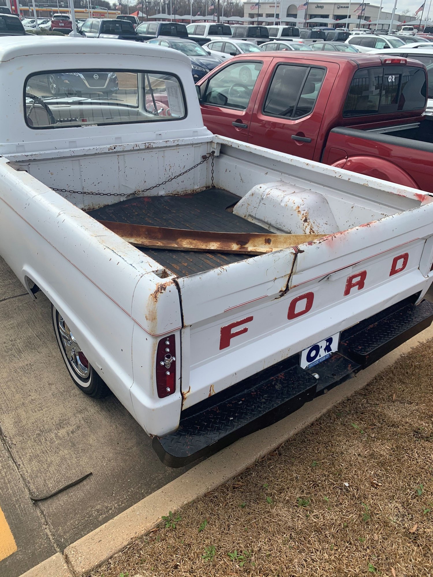

The shortbed truck certainly has been bedazzled!!
I'd definitely pull that rubber mat out of the bed and have a good look there. The tailgate is 1964-66 style so likely original. Anything wrong with it? I see a couple of dings down low, but what is that above the "O" and slightly to its left? Take a good look at the front cab supports, sometimes a screwdriver can find crumbling pieces that the eye doesn't see. Radiator core support down low is another good one to check as well as frame under the core support. Cowl area and cowl drains are another area that can look solid if it was undercoated, but can sometimes be hiding problems to deal with. Take a good look at the floors from both inside and underneath. Pull back any carpet or mats so you can get a good look. Rear cab corners can sometimes have issues that a screwdriver or pick can find. Check doors along the bottom edges, if the drains at the bottom of the doors were plugged there can be lower door rust issues. It seems like a decent truck in the pictures, but the center cab brace you would want to deal with correctly. As long as you go in with eyes open and don't let your heart get in the way too much you'll know if you want to tackle it or not.
I'd plan on pulling the cab off to make the repairs easier to get at for those braces.
