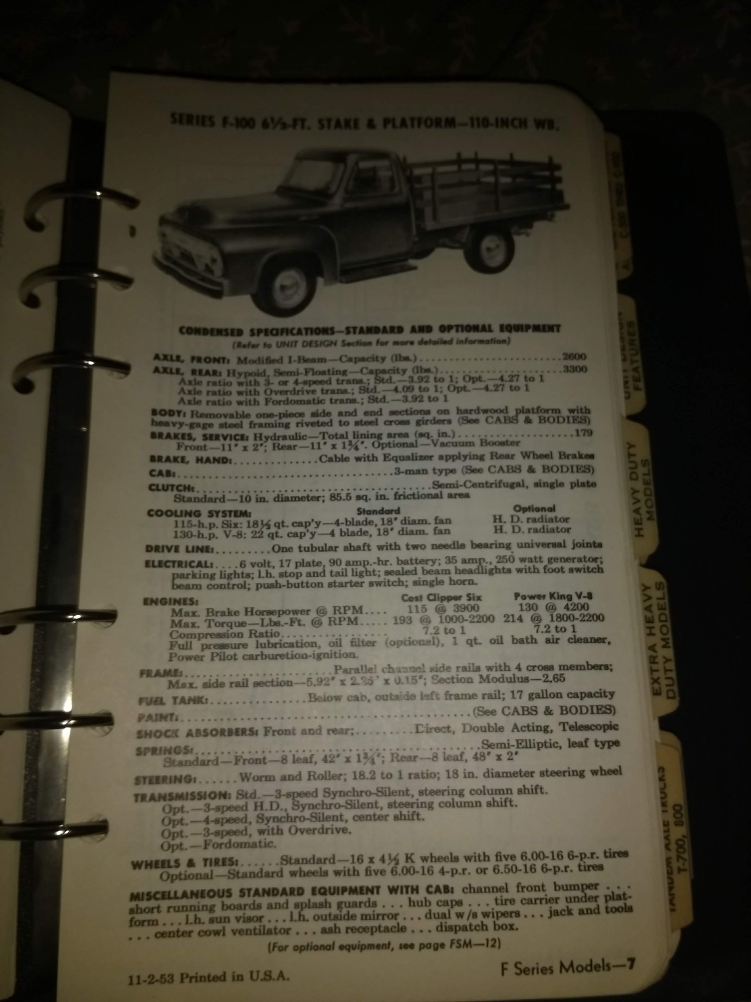

Here are pics of my 54 Ford Truck Dealers catalog. This should help you. I am sure the only difference is that with the "platform" bed you got no stake sides (or racks) and therefore was cheaper.

I don’t profess to know but I’d make a guess that the side board pockets are the only difference. They are probably cut into the steel of the bed so the side boards can drop into them. Like the pockets on a pickup. Other thought would be they have pockets welded to the outside of the bed, but the pictures don’t reflect the second thought.

The stake pockets were not welded on the outside. I am 99% positive that the only difference between the platform bed and the stake side bed is that the platform bed did not come with stakes.
So that leaves 1% for me being wrong.

I would agree with Abe. It would make no sense for Ford to build 2 different platform beds. I've never seen one without the stake pockets. They were designed to work with or without the stake sides, depending on the usage. If you wanted to have solid sides or different height sides instead of the factory rail sides, you would still need the stake pockets to install your own-built sides.
