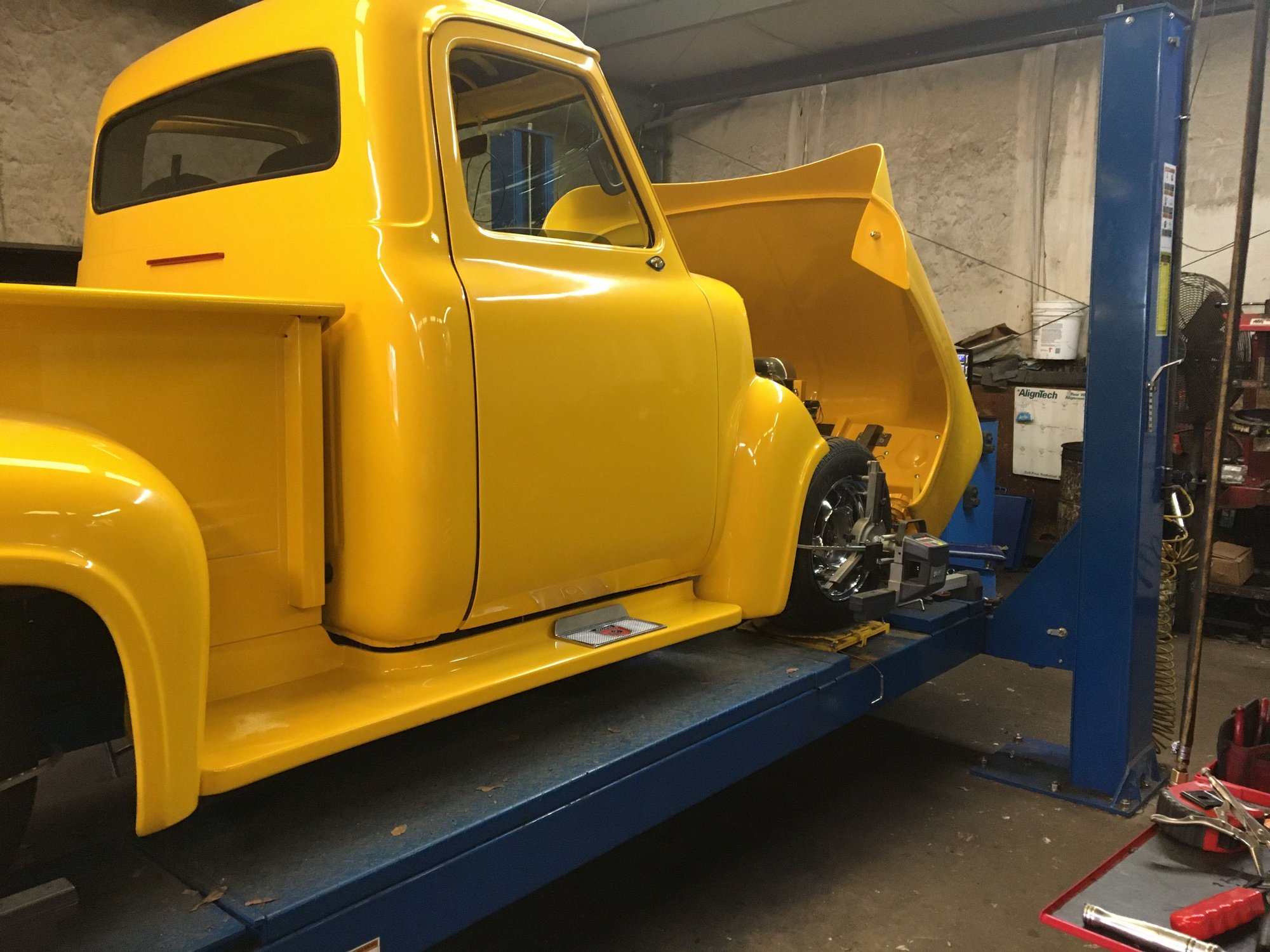

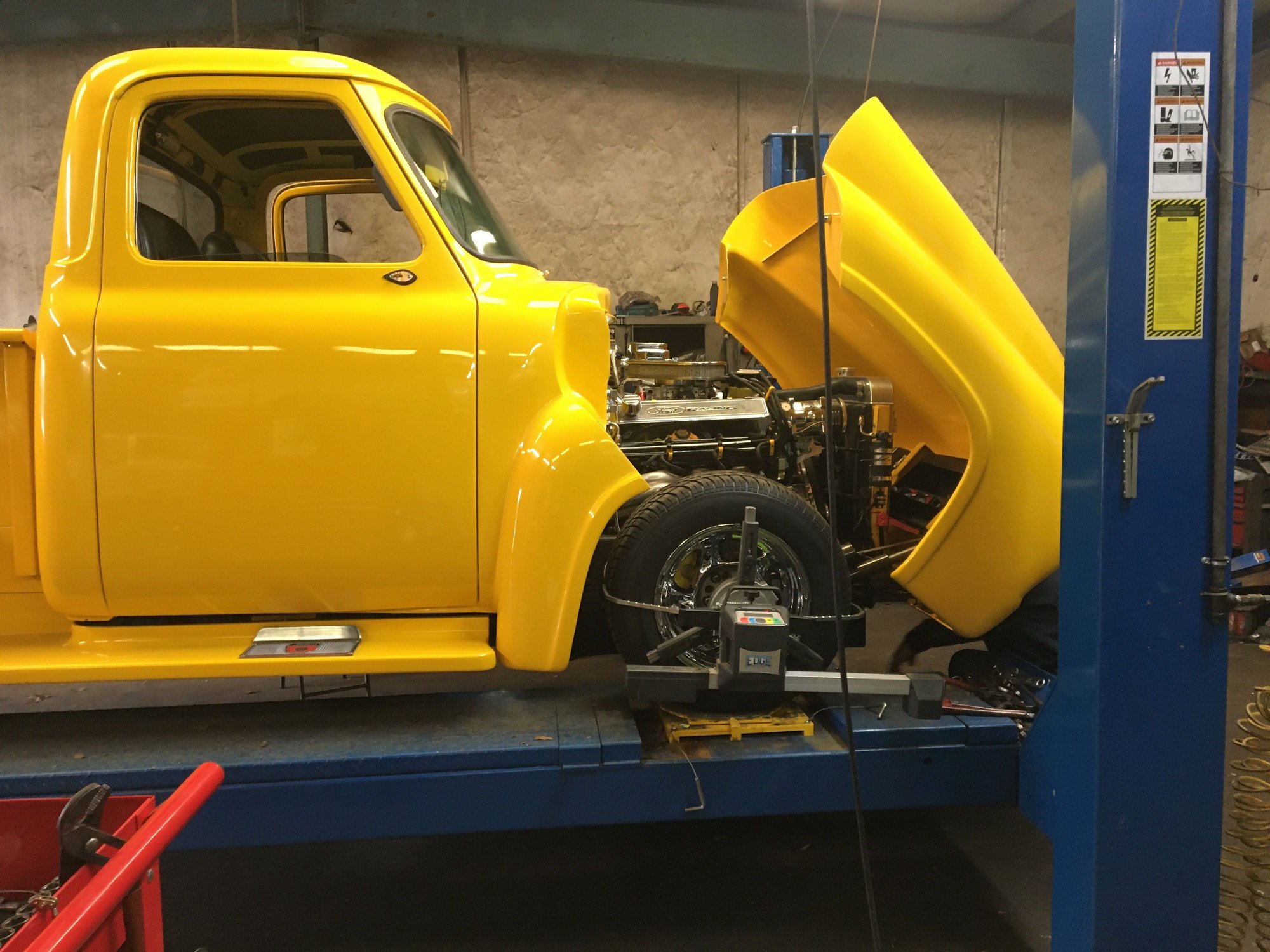

took the trip on a little day trip to the alignment shop. Got new tires and before driving it got the front end trued up... They had a hard time matching Heidt's spec for the MII front end especially on the camber. I told him to make it drive straight, not wear the tires and not pull to either side... only drove it about a mile after, but all seems good

Just curious as to what the problem was, especially with a camber issue. Are you out of adjustment within the slots for the upper control arm ?

sorta, couldn't get the camber to set right without the upper control arms being all wonky... front all the way in and the back all the way out...

Don't feel alone - we just took our truck in for an alignment on Friday.
We've got a Mustang II front end (No Limit) & they said it was maxed out as well.
Seems to be a common issue with these after market front ends.

John,
I took mine in as well and got the same story about camber. I also have the heidts. Those guys at first were saying the alignment can’t be done. Questioning if I welded it square. Saying we should put a chain and pull on the frame. Also saying if it was them they would remove and re install the ifs. They never heard of heidts. I was going to leave right then but it was all hooked up and I was pretty much already in to pay. After some him and hawing and some loosing of a arms back and forth it magically got into the Green tolerance. Drives great now. Seems like people just like to talk crap about these old trucks when we eat the cookies!

That story seems to highlight the level of skill of the typical technician of today. All they know is what the computer screen says. They have no knowledge of the theory or practical application of what they're doing. It's either "in the green", or it's not, and therefore something else must be the problem. It's certainly not with them.
I had a similar experience with a DD once. The tech came in to ask if my car had ever been in a wreck. I said no (and it hadn't), it was factory stock. One side was in the red and the other was in the green. Both sides were within .1 and right on the edge of the window, but the tech insisted one side was bad while the other was perfect, because it was in the green. I knew more about the numbers he was looking at than he did. I was having excessive tire wear and I wanted it changed. I told him where I wanted it set, and he refused to move the green side. I asked why, and he said because it was in the green. It was fine. I went elsewhere and got it done right.
