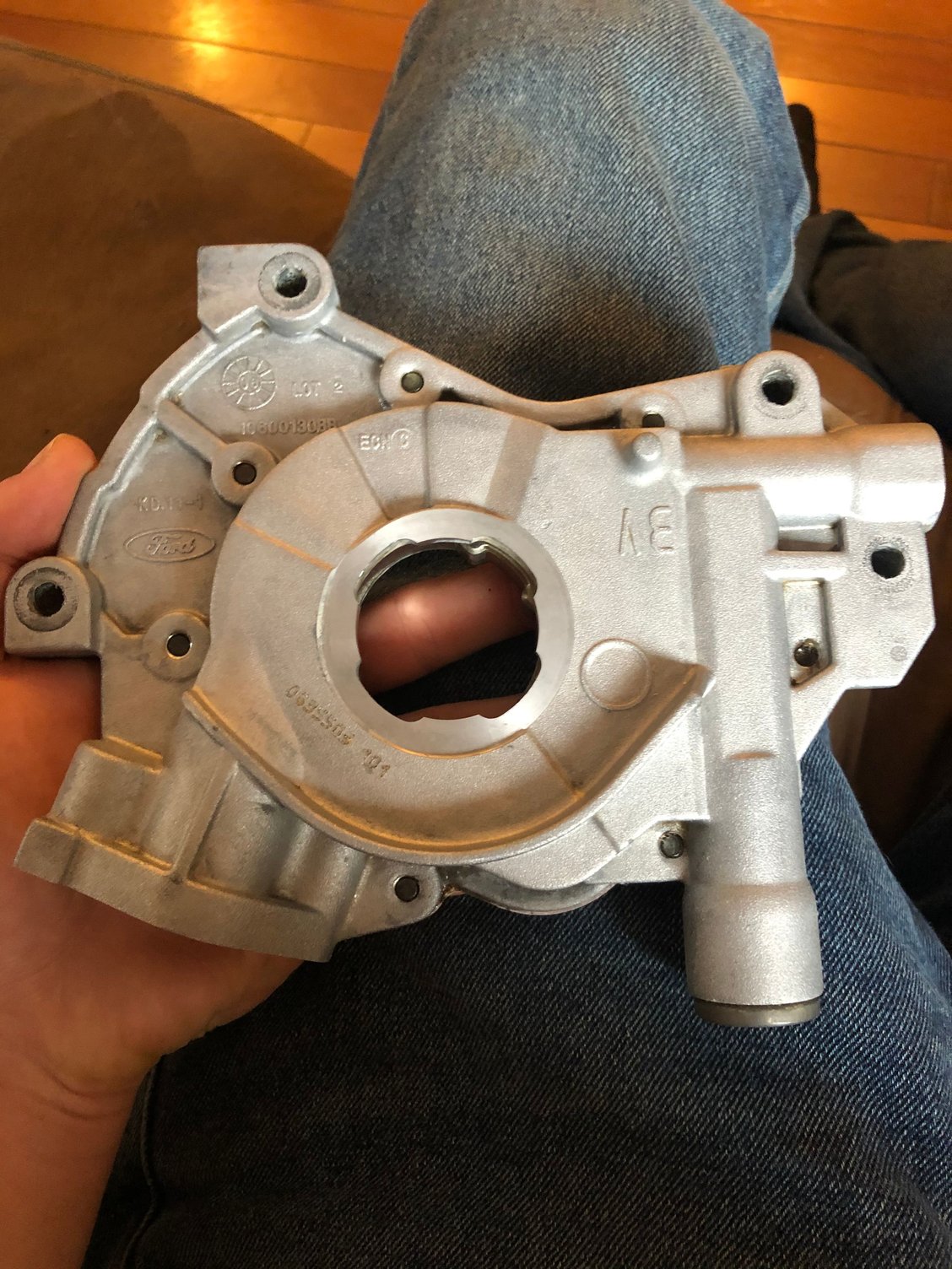

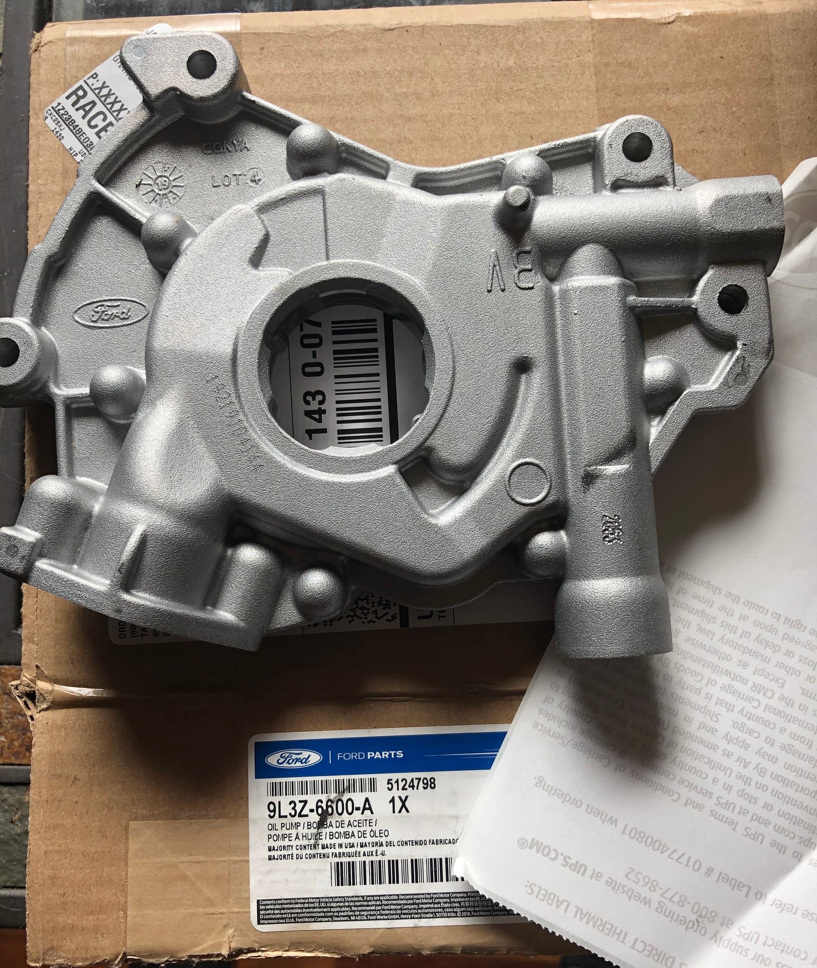

I’m 21 and on a budget with this covid-19 slowdown so I did the work myself (I had the startup rattle). It was doable but difficult at times. I replaced the timing chain tensioners, guides, arms, and oil pump. I re-used the timing chains and replaced one rocker arm because it fell somewhere in the suspension area and I couldn’t find it. I found no damage and no cam cap scoring in my engine just one blown out chain tensioner gasket. I’m an OEM guy, I skipped the Melling hype as my original oil pump did a good job keeping everything tip top. Used all OEM components from Tasca Ford. Ford made some changes to the oil pump. Here is the old 2007 pump removed and cleaned up vs the brand new 2020 one I installed. Runs great and no more rattle!
Old:
New:

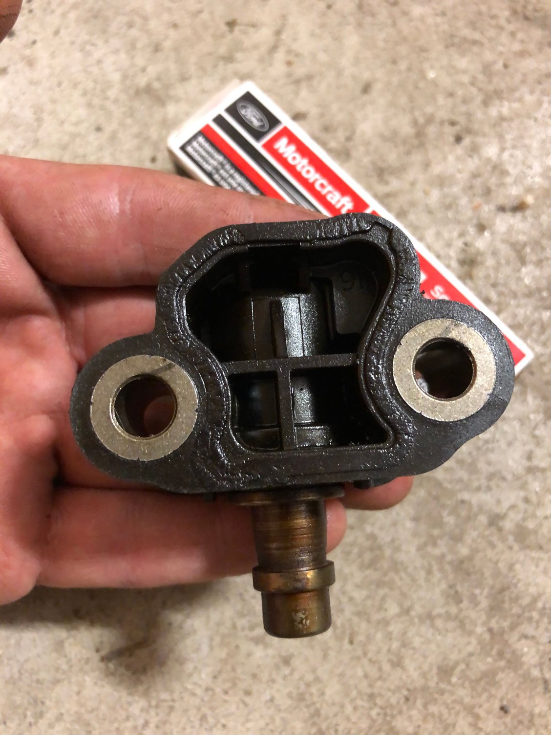

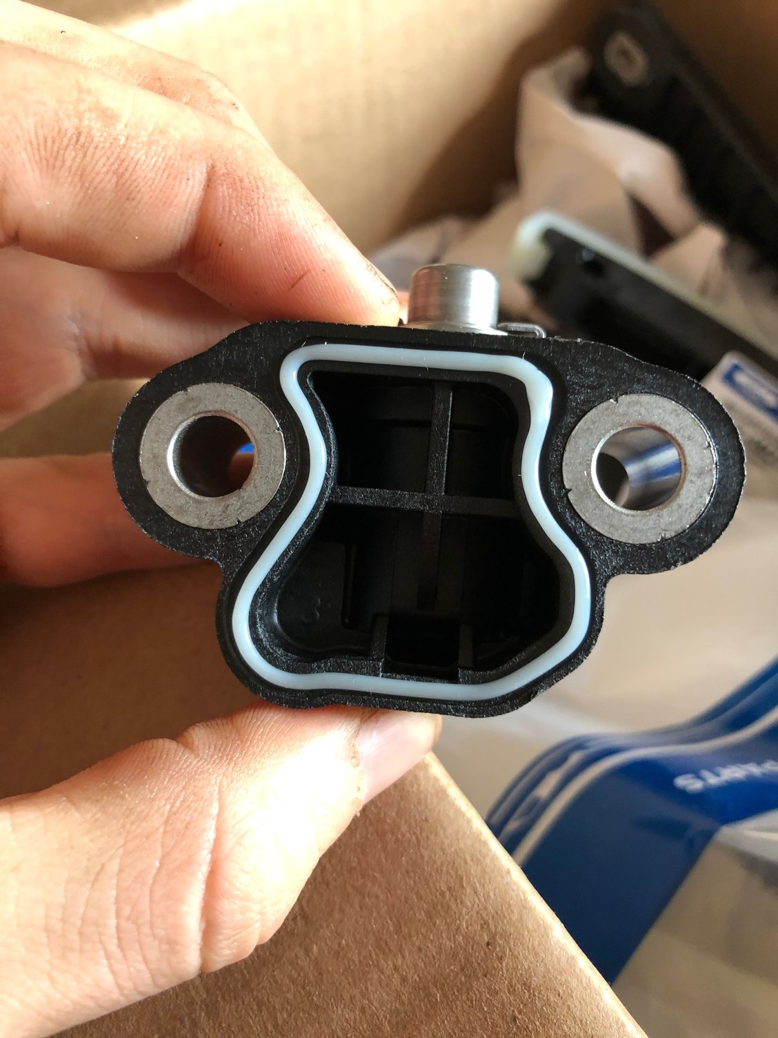

My biggest piece of advice to offer you is when you do it get a 8mm swivel head ratcheting box wrench. That bottom oil pickup tube bolt was the hardest part of the job. The new tensioners have a white O-ring now, my old one’s were brown gaskets. Hopefully the new O-ring Ford came up with is better. It feels like a silicone material now vs rubber on the old:
