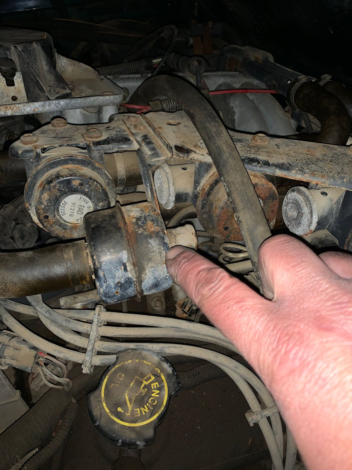

I replaced the map sensor since I already had it. Engine not missing at all anymore. Not stalling skipping. Still isles high. It fluctuates most of the time up down. When I first start it it runs fine. Still have code 122 I think I miss read it last time when I said 22. I’m going to check the pmc and icm resistor. Now I’ve thought of something else. After watching a YouTube video. My one plate on the tb I can see a slight gap. Light through it when it’s closed. Could this allow air in causing the high and fluctuating idle? From what the video said it was on that car. Would that throw a 122 code? I know it’s tps. Also is the thing I’m pointing to in the picture need a hose going somewhere? I don’t have any idea what it is but it’s blowing air.

No the AIR muffler does not get a hose.

Thanks it looked like it should. But wasn’t sure.
