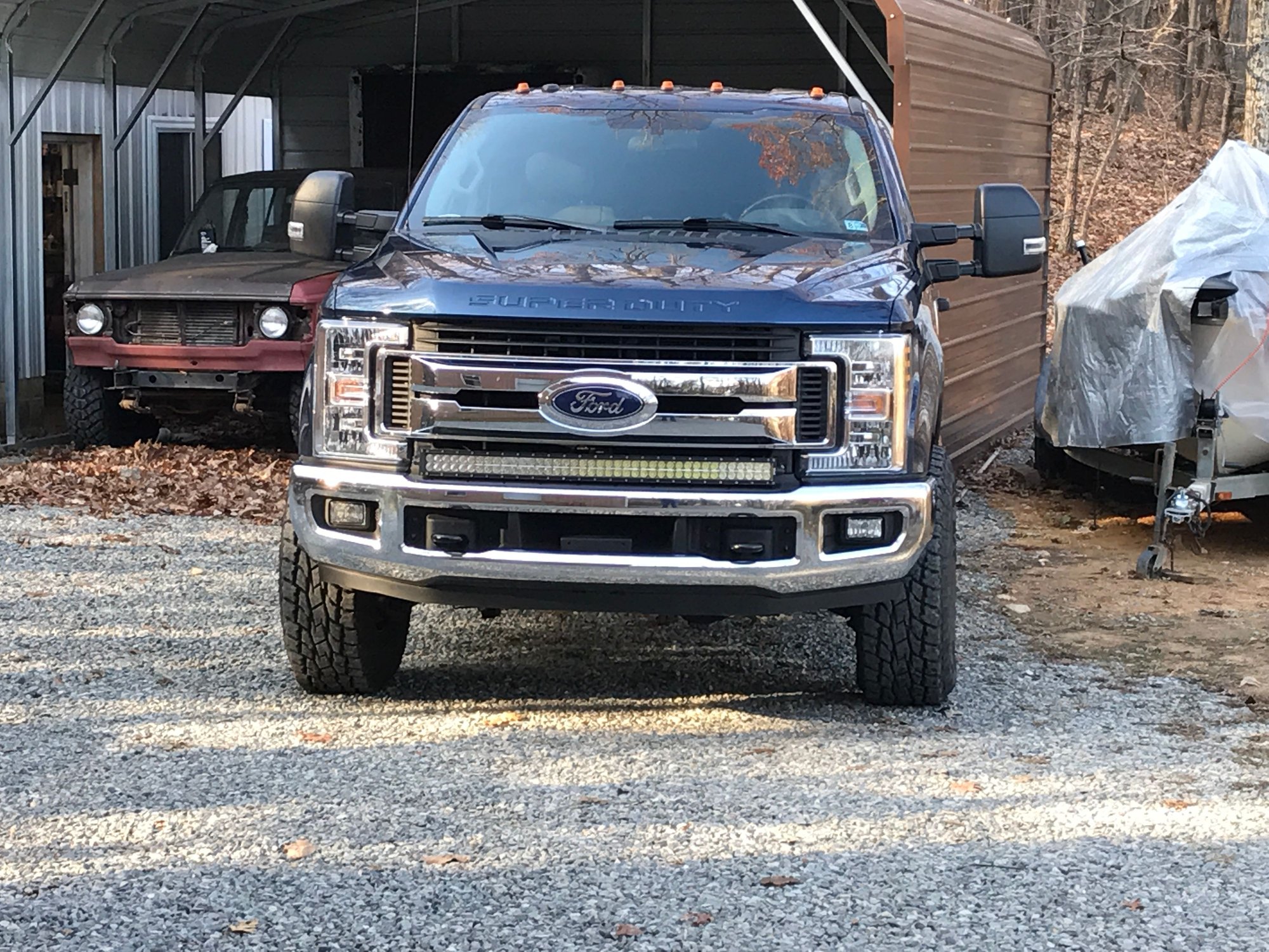

17x9 - 0mm offset:
Old Dec 11, 2019 | 08:14 AM

Originally Posted by ATC Crazy
17x9 - 0mm offset:
That looks perfect! I also see they are methods, I am looking at the standards. Thank you for posting the pics. Did you use a leveling kit? If so which one?
I hate leveling kits. My truck is stock suspension
17x9 - 0mm offset:
Are those 37” tires?
34" (285/75/17)
