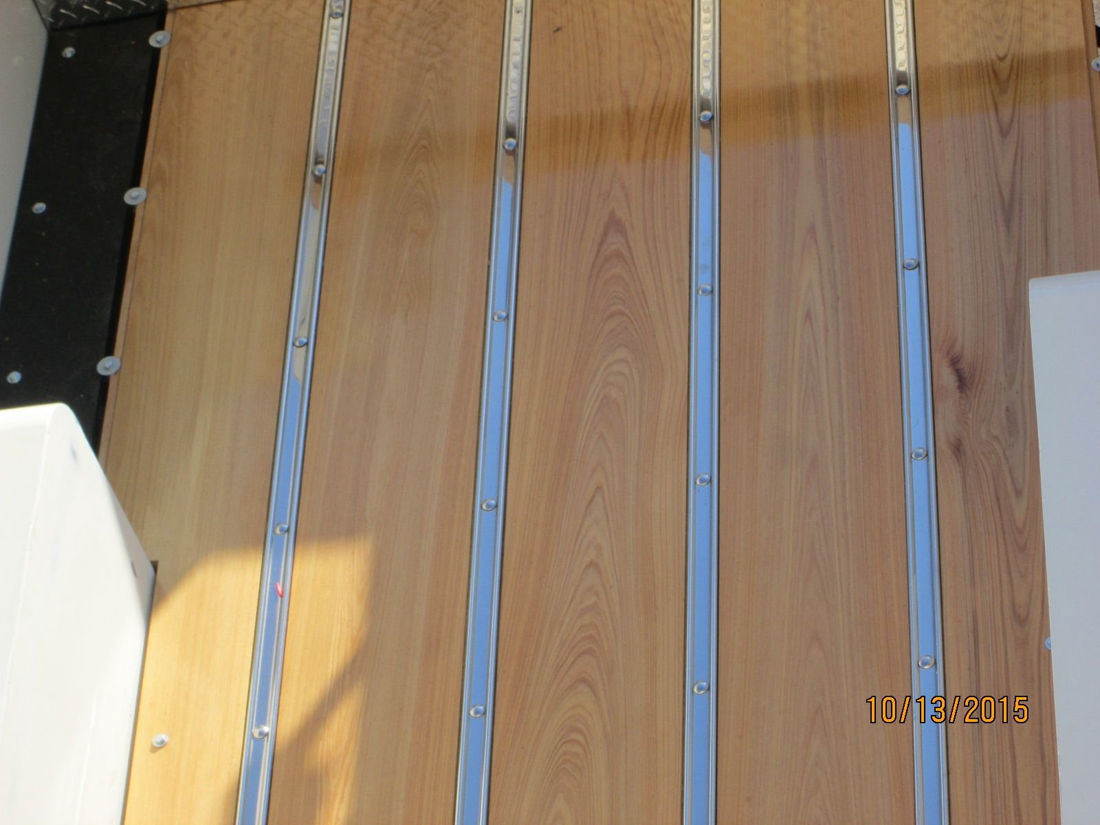

The pic's on here have some good looking bed floors...hope the one we ae doing look as good as these. Went to local lumber company and having some boards cut. When I get them the only thing left will be how to finish them. Seal them under side and ends with paint sounds like a good idea then stain and top coat the top side???
