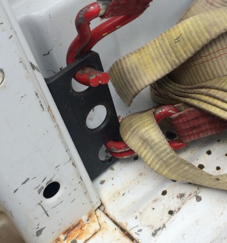

Yeah I dunno if you're talking bed walls or bed rails; there are some miscellaneous holes smattered throughout the bed wall interior, primarily at structural supports or stake pockets.
One of the best things I ever did was replace the flakey corner tie-downs with custom ones I built with three holes per.

I LIKE THAT IDEA, GONNA STEAL IT FOR NEXT WEEKEND'S PROJECT

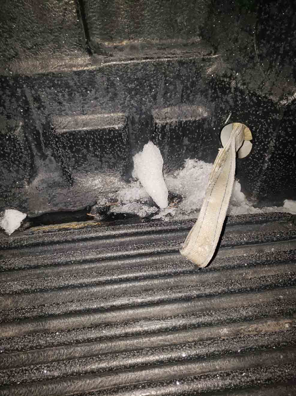

I use my industrial, walking foot sewing machine to fabricate these webbing loops. Their 1.5 inch heavy webbing that I double layered throughout length and triple layered at ends. I used a 10mm stitch length with size 138 polyester thread-super strong. They're looped into the eyelets behind plastic bed liner. When I attach something, I use webbing cam straps (home made of course) to secure load. I'm sure that there are some commercial systems that may be "better", but I find that with these there is no metal to scratch of rust, and their home made cheap. They are frozen in picture. I can show whole bed once sun comes up later.
Cheers, Noel.

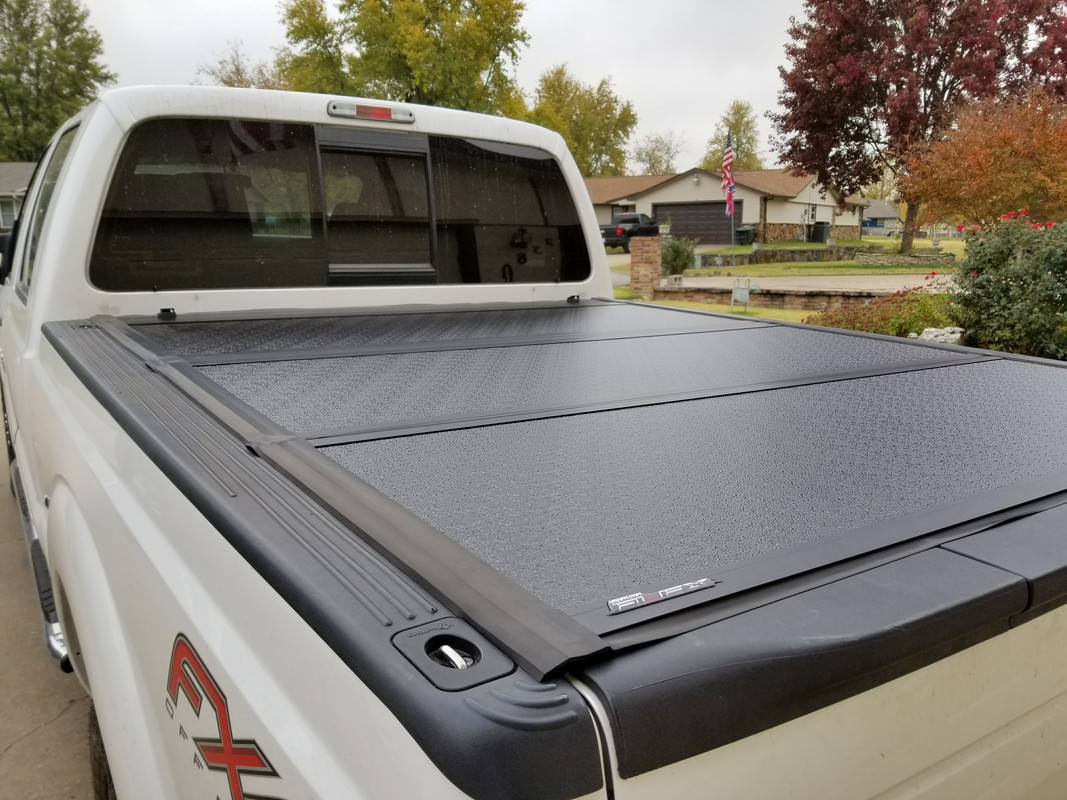

There are loops in the stake pockets already. Just pull the plastic cap and look down in there. I use them all the time with ratchet straps.

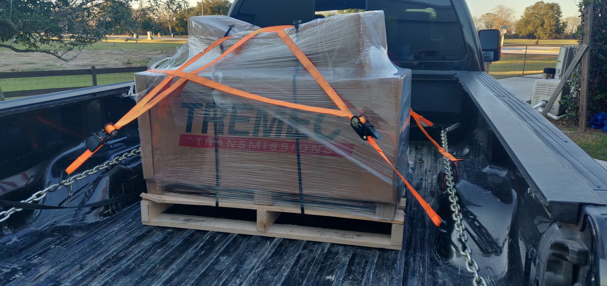

I also use chain on each side of my bed (front to back). I attach it to the factory tie downs with quick links. That gives me a tie down anywhere on the sides and at the front of the bed. It works great. Learned that trick from an old man.

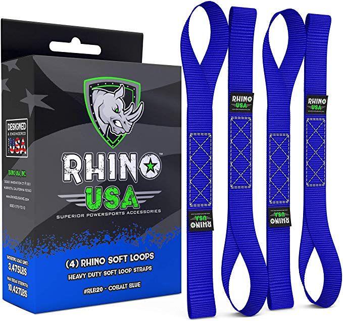

I use these. Not as rugged as NoelCT's, but at $12 for a set from Amazon- very easy to purchase.

We are looking for something that goes in that little hole on your picture, not on the bed. We are thinking rubber stoppers but no way to tighten them up.
