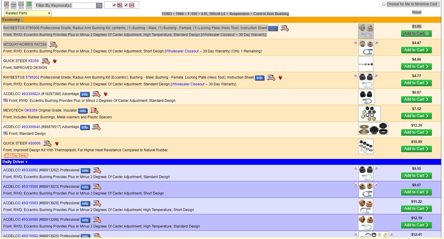

I noticed some heavy clunking when driving over road irregularities. Noticed that the bushing under the drivers side cab is shot for the lower control arm. I see bushings on Rockauto for +/- 2 degrees camber and some sold without (e.g. the hole is directly in the middle). Is this something thats easy to change in the driveway? Or does the whole suspension (springs, shocks, brakes) have to come undone to get at the bushing? Ordering brake lines as it is because the passenger side is rubbing against the spring. I didnt see a sway bar (my original thought to the clunking). Do these use torsion bars or sway bars? I dont get under the truck much and only drive it for errands that require the long bed.

Can you post a picture of this bushing you talk of because our trucks don't have lower control arms and as far as I know The only degree bushings you can get are for ball joints and used only when needed.

I see rock auto I will have to look when on my pc

#12/13/15/16/17. I didn't know what else to call it specifically.

The arm is called radius arm and bushings radius arm bushings.
I did not know the bushings came as degree are you sure they are for our 80 - 86 trucks?
Who are you looking to buy them thru as I would like to see it.
Think I would go with 0 degree bushings.

At the very bottom, Energy suspension has some "Radius arm" poly bushings for $18. The ones with adjustment look different than the cone shaped ones.

The stock bushings are centered. The offset bushings must be a aftermarket "fix" for caster problems.
I was always afraid to run hard poly bushings in the radius arms. To me it needs the extra movement a softer rubber bushing would provide.
