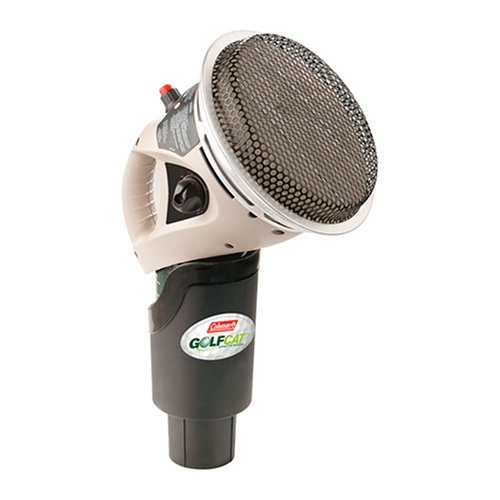

Candle - Not so sure if that would be sufficient for the excursion. How about a portable propane heater instead I've got one of these that we use in the golf carts for winter golf!! Has separate bases for cup holder & flat surface.
