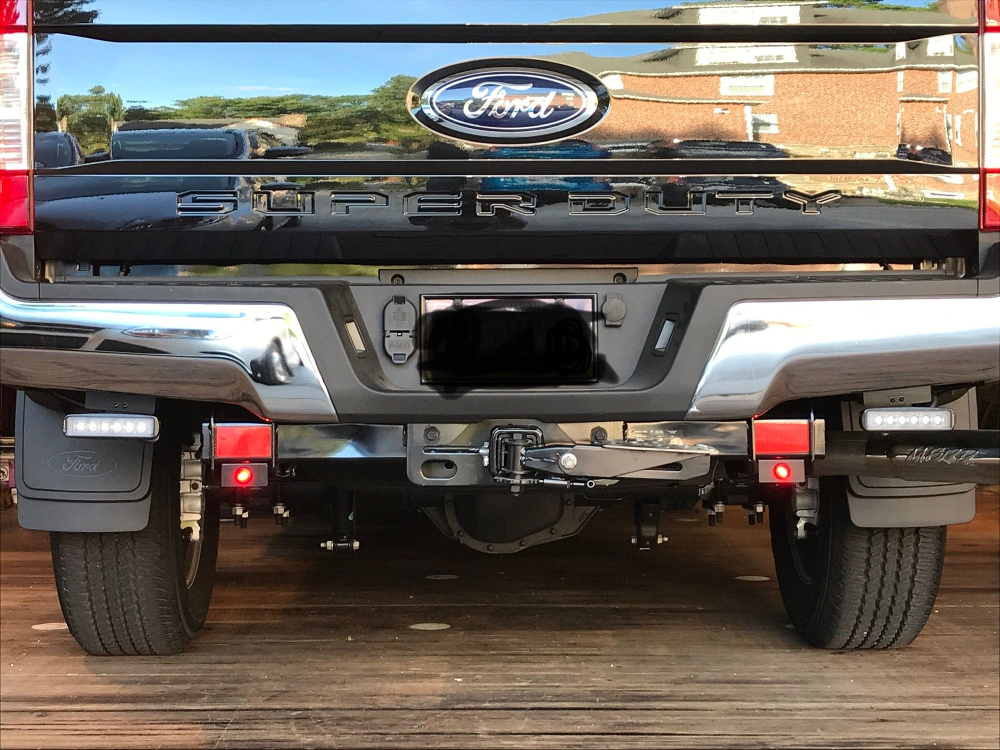

These will light up anything you need lit up. It was my first mod on my '19 for hooking the boat up in the dark. They did not disappoint.
https://headlightrevolution.com/2017...s-upgrade-kit/

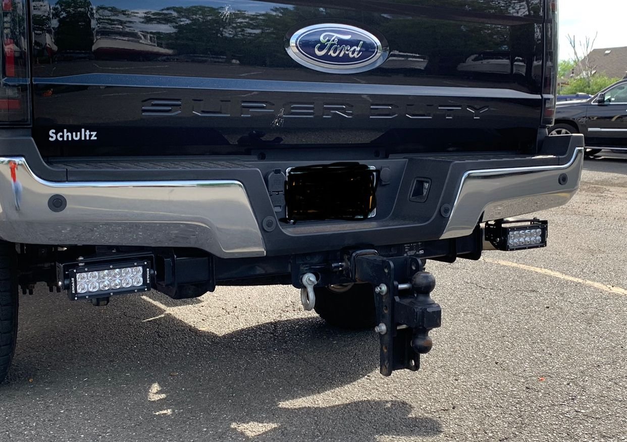

I bought a pair of LED work lights from Northern Tool. Mounted them to holes already on the outside of the receiver and wired to an upfitter. Easy-Peasy and right now you can do it for less than 20 bux.
Ironton LED work lights
I didn’t try to wire them to the backup circuit. Easy enough to turn them on whenever I need them, and honestly that’s not really that often. I do have to be careful though not to leave them on when driving forward as that would not be nice to folks behind and I don’t care to pay that ticket...

I bought the kit from zroadz. Came with the mounting brackets and two lights. I wired it to an upfitter switch, but it did come with a harness and switch incase you don't have the upfitters. They are super bright and make backing up a breeze. Also they do not wash out the rear camera.
Here's a link to the lights:
https://zroadz.com/i-23910042-2017-2...submodel%3DXLT
