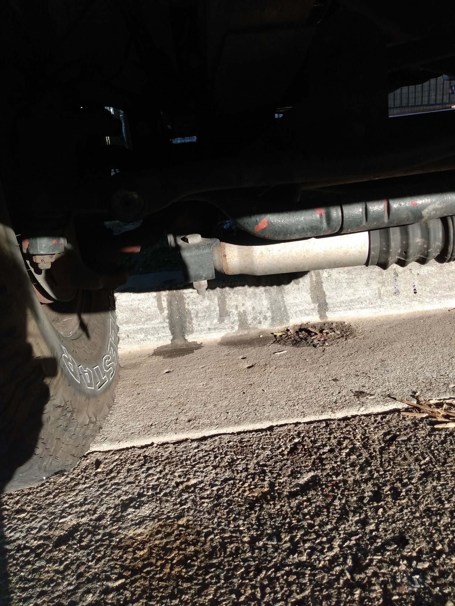

I have a 2002 f 250 superduty desiel the problem I am having is a steering problem.it has real loose steering I changed the steering box I've tightened the steering box and now what I'm driving at 60 70 miles per hour and it hits a bump in the road it pulls me into the other lane
I am driving on the 15 freeway coming back from Vegas and I am in fear of my life any help on what might be going on

Could be worn steering linkage or your ball joints. How old are they?

I would suggest getting under the front and looking at all of the steering and suspension components. Grab ahold of stuff and shake it.
If your steering gear is failing in a catastrophic way, you need to fix it because you could lose steering and braking at the same time.

First thing that comes to mind is bad ball joints. They wear out with some regularity on these trucks. Could also be bad hubs. Jack up the front and yank the tires around with your hands at 12 and 6. Do the same yanking with hands at 9 and 3. If it's loose at all positions it's probably the hubs, but if loose only at 12 and 6 that's likely ball joints. A handy shade tree mechanic can do both jobs at home with a few tools and some research.

@William gagen If the nut holding the pitman arm on the steering gear was loose, the splines are probably damaged. You will need to replace the steering gear and the pitman arm. It is important that the steering gear's output shaft and the pitman arm have the same spline count. Whether it is 32 or 36, both need to be the same. There is only one allen screw with a jam nut on top of the steering gear to adjust. What screws are you referring to that were leaking?
Another way to check your tie rod ends is with channel locks.

Mine did similar things and i replaced everything except ball joints as they “tested” ok but apparently were dry. I had to use a TSB and disconnect the steering linkage and do a friction test (not exactly sure what called) to truly find out if bad. They WERE even though three shops told me they were not as they didn’t do this test. Not worn, but DRY. Also if you tightened the steering gear very far or you could’ve done it too far and can cause issues.
As SOUS said IF bad enough it is causing an unsafe driving condition you had better be careful and advise not driving until getting taken care of. Mine wouldnt jerk you off the road but if you’re on a real bumpy road that was heavily crowned it would certainly give you some pucker factor. my wife hated the truck until I got it taken care of.

This guy has a good description. It is also possible IMO you over tighten your steering gear. I’ve certainly heard of people having that start binding and causing similar symptoms as you describe. While the ball joints and other things in steering will cause it to wander truly yanking in the other lane is obviously a more profound thing.
