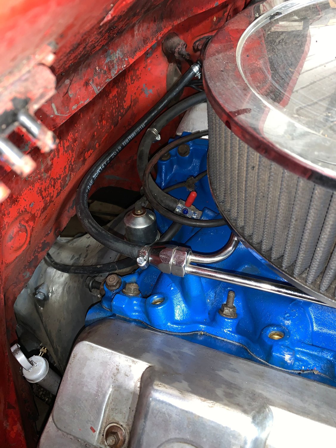

Here’s a few pics. I may get a video later, kick down is untied, still no luck. The fluid on the cross member is from changing the governors, the second pic showing where I’ve got the mod valve hooked up to the intake, also, how big of a difference would the fluid type make? And what would y’all suggest?

Just a long shot but is the rod the modulator acts on in place?
