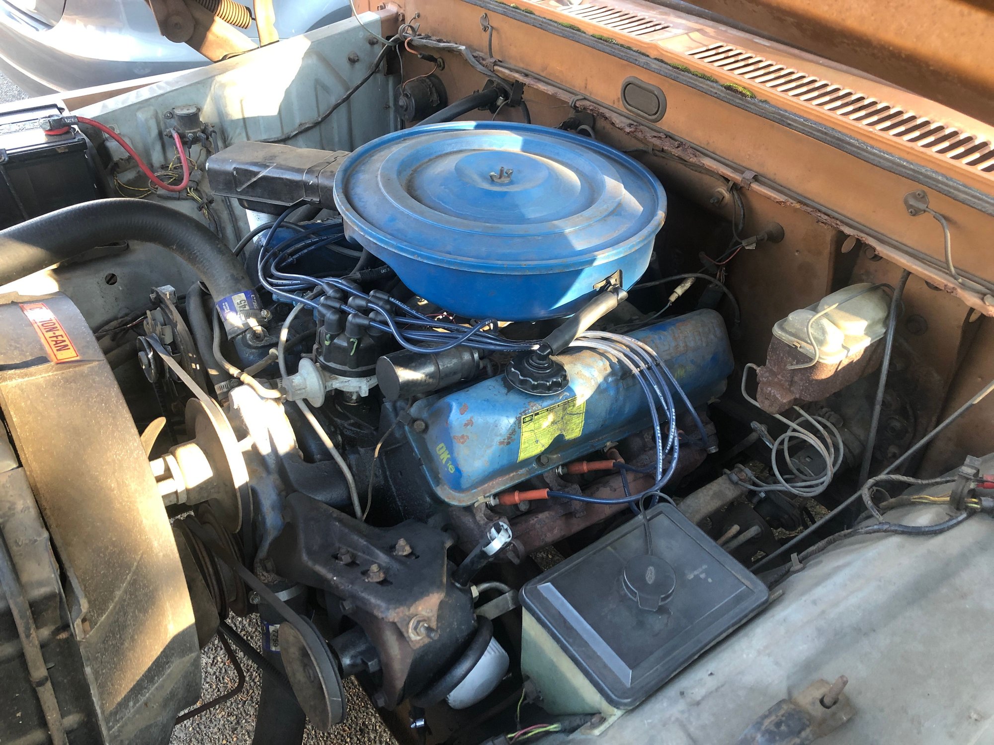

Hi, so I've never done anything like this, so be easy on me haha. I'm trying to find the EGR in my engine because the truck keeps dying on me during the first 20 minutes when I accelerate especially out of turns. I've read a lot of information and it appears that it could be a ton of different issues causing this. One I read was the EDR might not be working, or filled with gas causing the stall. Attached is a photo of my engine. Like I said be easy on me, i'm new to the world of older car repair. Thanks!
-Alex

Pull the air breather off and look at carb , most use a base under carb an a vacuum diaphragm in rear,,looks like the pictures below , May have to remove carb and clean the base spacer out , might be your issue might not be , but that's the egr and check vacuum

There is no egr on that engine, you most likely have a float issue causing fuel to dump in turns.

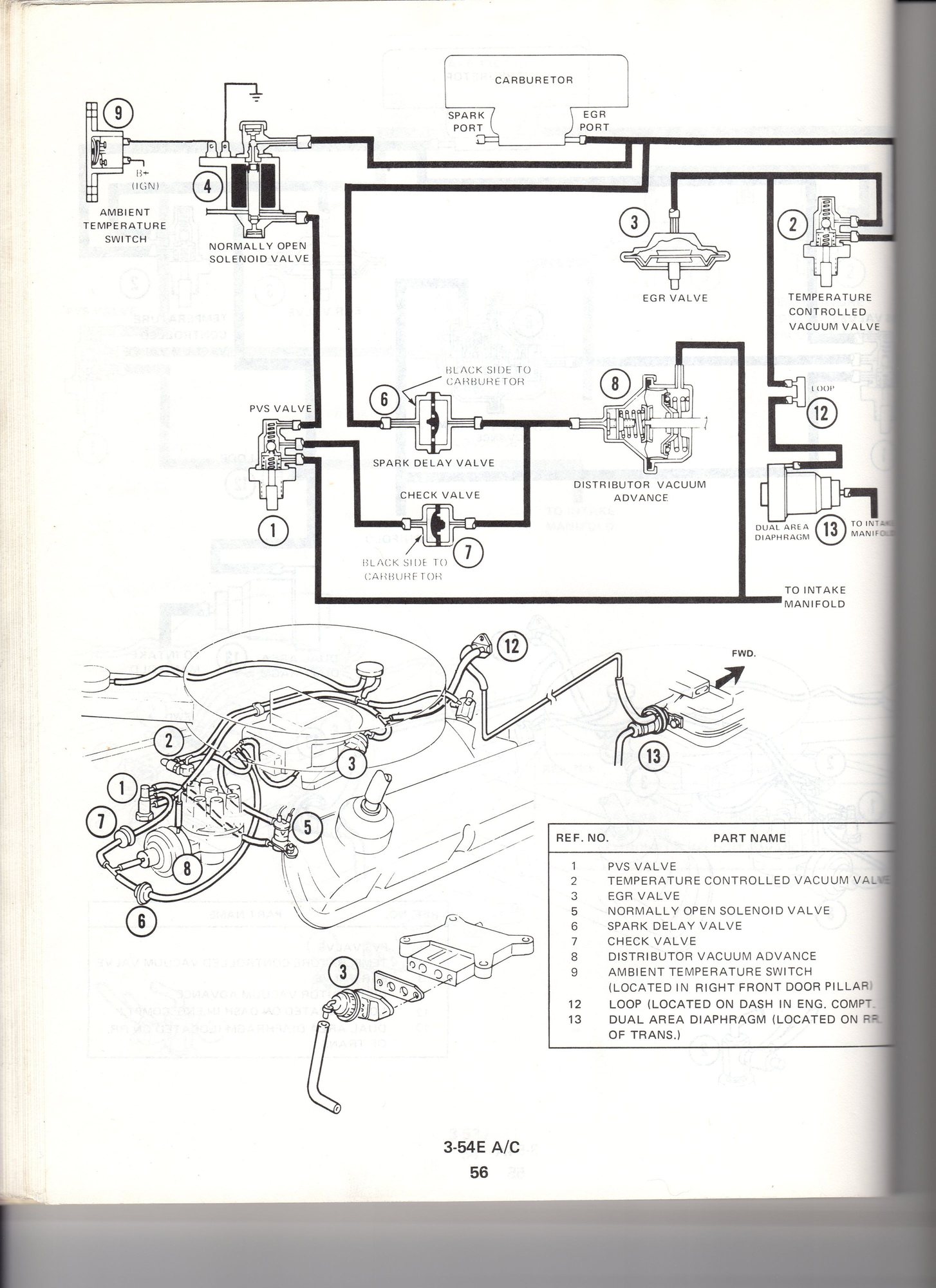

'73 F100 w/ 360 vacuum diagram. This is from the factory manual emissions volume.

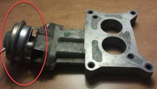

If you are still trying to find your EGR it is attached to a spacer plate directly under your carberator. in the pic below the circled item is the EGR and it is on the firewall side of your carb.
