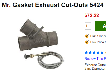

no, sir it wont, they make them, in electric or manual pull wire

Just recently on Januray 1st of 2020, emission inspections dont exist where I live now! ahaha. Thanks for that link, I will definitely check it out. I'm pretty handy with welding and metalworking and enjoy building things myself, but the switch is a nice perk for the price and it might be worth just buying it.

Another question, I can go measure tommorow but do you guys happen to know if the Mr. Gasket exhaust cutout 5424 is an exact fit or will I have to step down the size of the original pipe?

I have checked the laws, and my vehicle is 25 years old so I can modify my exhaust, so long as I have at least one cat and am not also I want to do the cutout just purely for fun. When I'm messing around in a field with my buddies, i'll open her up. When I am driving to school or just running errands, I'll close her and it will be nice a quiet. What I plan on doing is not touch my first cat, I'll just get rid of the second cat and replace it with a straight pipe and put the cutout in that, and not touch my muffler. I'm not sure how it sound so I plan on making nice and clean cuts for my second cat and clamp on the straight pipe, and if I don't like it I will put the cat back on and figure something else to do. I haven't messed around with exhaust systems much so I'm really just learning as I go. I really appreciate the responses.
