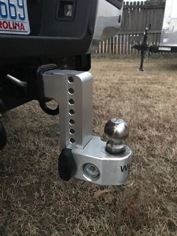

I have a stock 17 F250 with 18 inch wheels. I measured and needed a 6 in drop to level my trailer. Bought a Weighsafe 8in drop and it’s fantastic.
Bought same same from E Trailer that was a RETURN, saved BooKoo bucks. E trailer has a lot of this stuff folk buy, use one to move the family from NYC to Texas and then ship it back for a refund inside the return window. IIRC I save about $100 or so, I got the full 3" with weight scale, LOVE IT...

have you found that scale to be somewhat accurate?
Yes I would say it accurate based upon my observation.

I have different trailers and use between 4"-8" of drop all the time. My utility trailer (7x12), I have to use the full 8" of drop of my hitch and it's still not completely level. With my bumper pull RV, I use roughly 4" drop since it's much heavier.

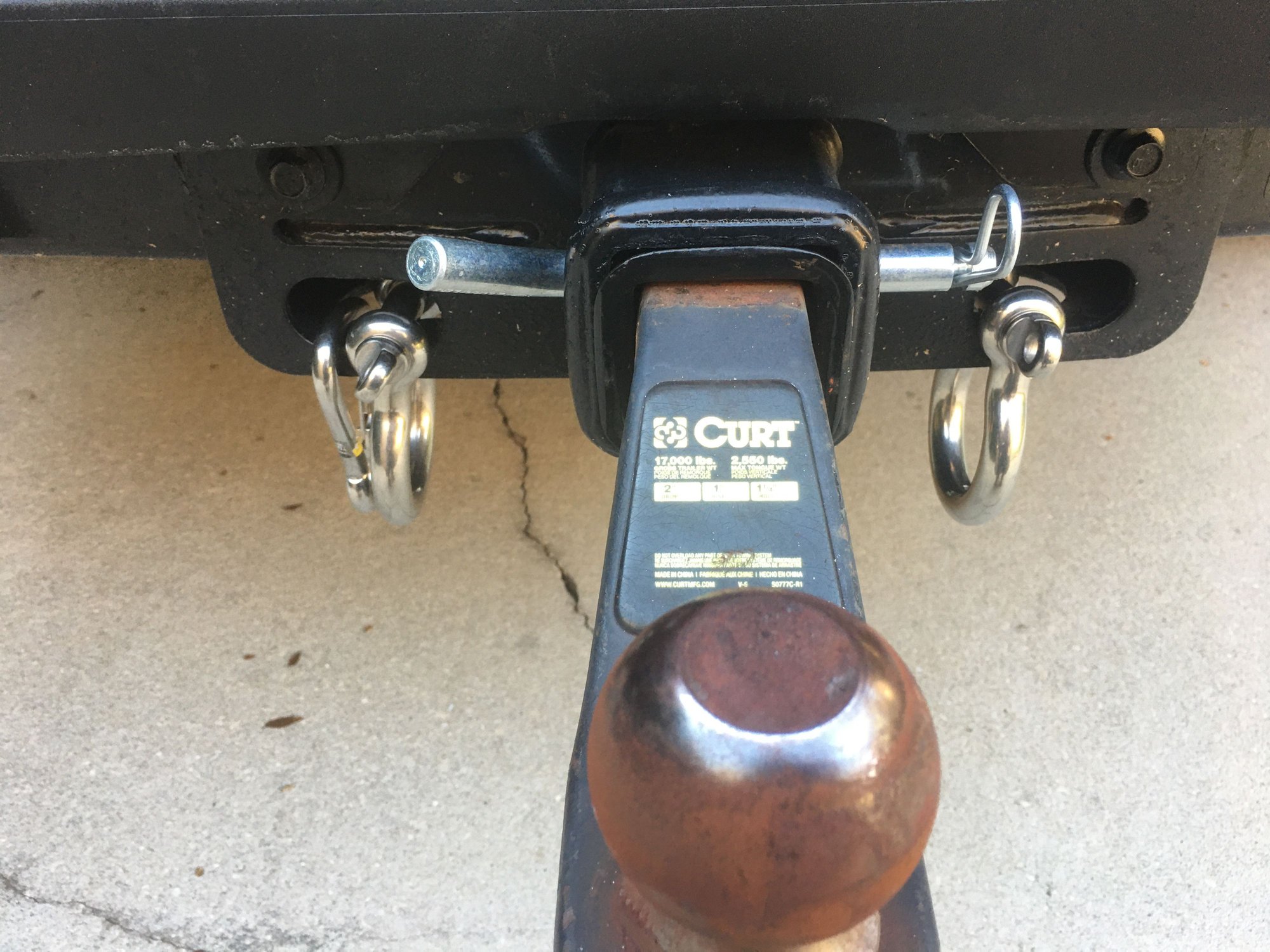

I don't want to take this too far off topic, but quick question. I always replace the emergency breakaway cable with the red fastway bungee type ones. I hook it to the same place the safety chains go. Is that incorrect? Been towing trailers for many years, but do not claim to be an expert by any means.

That’s fine. As long as the pin will pull if the trailer breaks away it’s good. Some folks just hook them to the chain so if the chain breaks, the wire will not pull the brake pin and that is not good. Out here in CA, the CHP will sometimes ride up and look at your setup and if it’s not correct (like the pic posted), they will pull you over. We also have a 55 mph speed limit while pulling a trailer although, most folks ignore this...

This CANT be right? The emergency break cable loops around where the hook n chain connect and then loops around the pin and hopefully the cotter pin keeps it from falling off? No way this is legal or proper!
I have a carabiner attached to my receiver (to the left of the left shackle), So if something fails, the cable will still be able to pull the EM brake. This needs to be isolated from everything else.

Frank79, I'm with you. I wouldn't attach the breakaway cable like was in that picture. I certainly wouldn't run it through the safety chains.
I have the 3" receiver. On the driver side of where the shank goes in, there is a small hole inside the opening where the safety chain goes. That's where I attach the carabiner for the breakaway cable. My carabiner is the screw type and it's rated for at least a thousand pounds.

any reason why the cable should not be intertwined within the chain?
when I bought my trailer that’s how mine came.
should I make them separate?

I want that cable to be able to get pulled. If there is any chance it could bind by being woven through the safety chain, it won't get pulled.

The reason why it intertwined thru the cable is to prevent the cable from"
Getting cut while driving and maneuvering, if it gets cut it does no good.
To ensure that the chain protects it see above and that the cable does not get caught while maneuvering and it pulls the plug. You are in a turn at an intersection, you make the turn and loose cable catches on something and pulls the plug, now you got a situation in a major intersection.
If you have not pulled the plug on it, try it. It does not take not a whole lot of effort.
You can leave it in the chain, I DO or take it out and let it flop around on its own, your choice...
