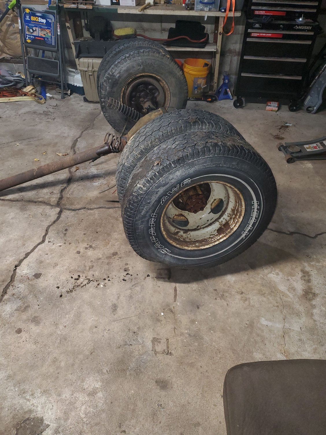

so, picked up this whole rear axle for 200 here in Minnesota. From a 1978 ford f350. Just ordered all new parts to rebuild it to brand new. Small projects until I get my truck out of storage in the summer.
This is a Dana 70. Rear axle ratio could be 3.73 or 4.10 or 4.56.

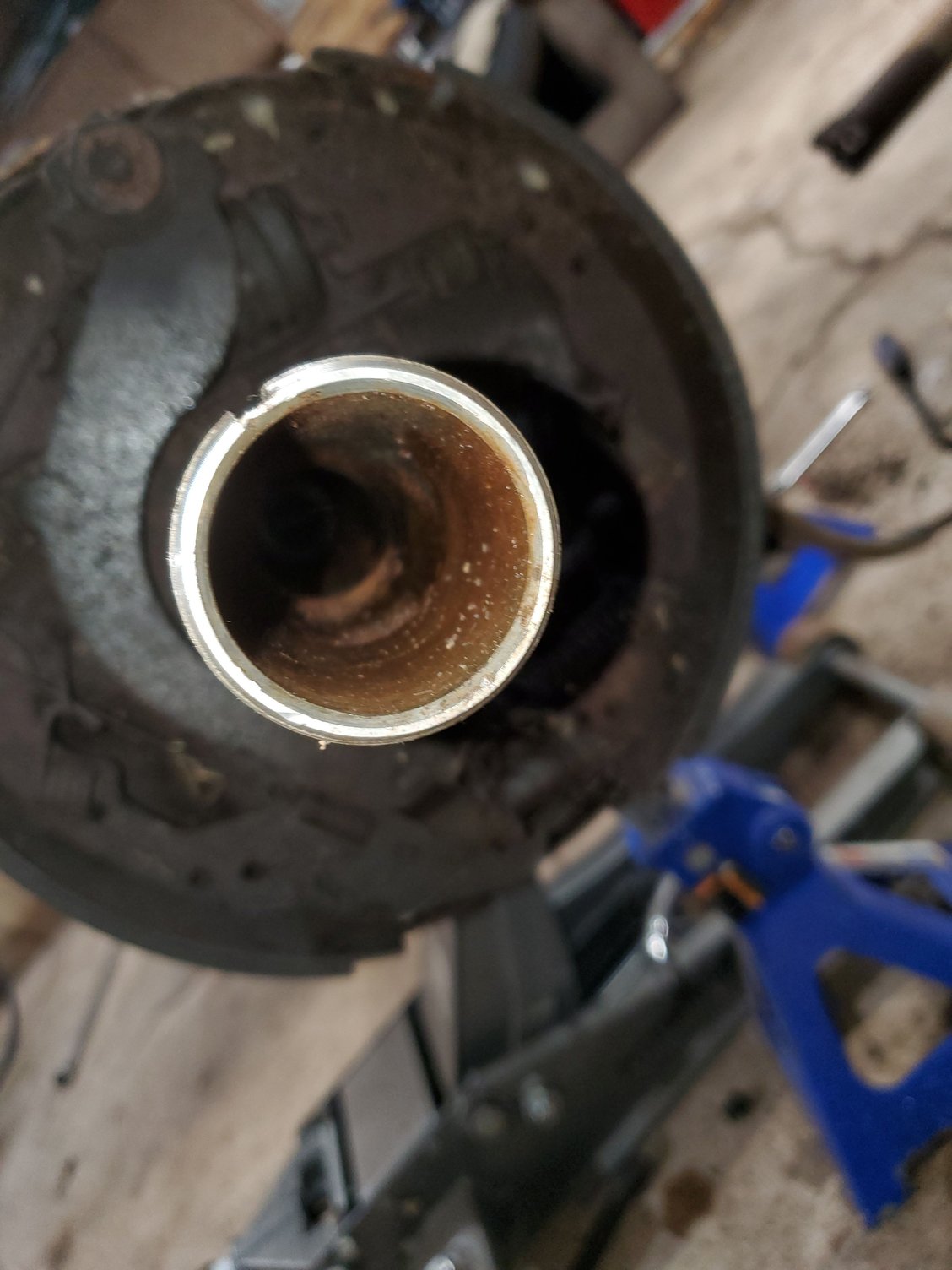

Found a rusted bearing on the shaft.
Also found some rust inside the axle.
With the rust am I screwed if any info would be great!!
Old Nov 28, 2019 | 05:06 AM
User 71024's Avatar
User 71024
Joined: Sep 2005
Posts: 2,954
Likes: 64
what's the diff look like? The bearing does all the work on the wheel end, rust on the spindle is no big deal. Just make sure the ring and pinion are good.

Old Nov 28, 2019 | 05:36 AM
2dwoods's Avatar
2dwoods
Joined: Oct 2019
Posts: 558
Likes: 109
The seal surfaces look a little ruff might need some love

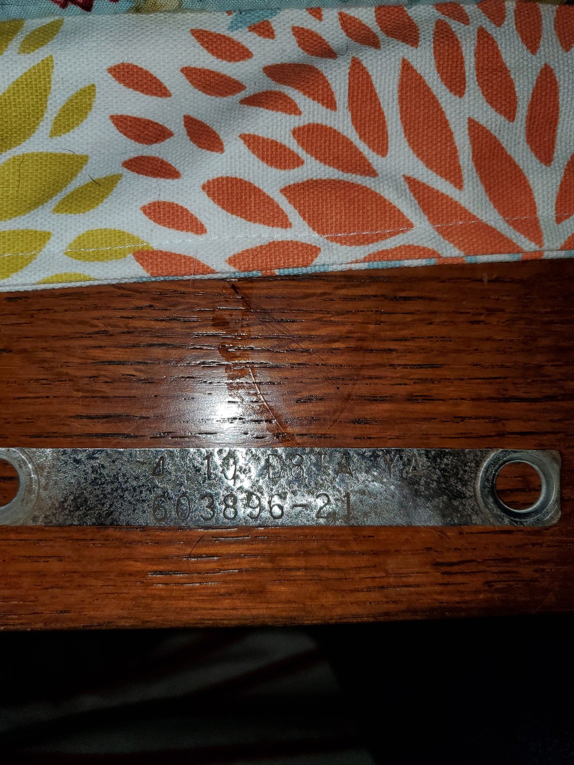

Wanting info on this number on the axle
Wanting info on this number on the axle.
Not Ford related.
Rear axle ID tag located under two of the bolts that retains the inspection cover to the housing. Post what the code is (if the tag is still present).
Found the tag says 4.10 and counted to verify. My wife was about to throw this away cause it was full of rust on my work bench.

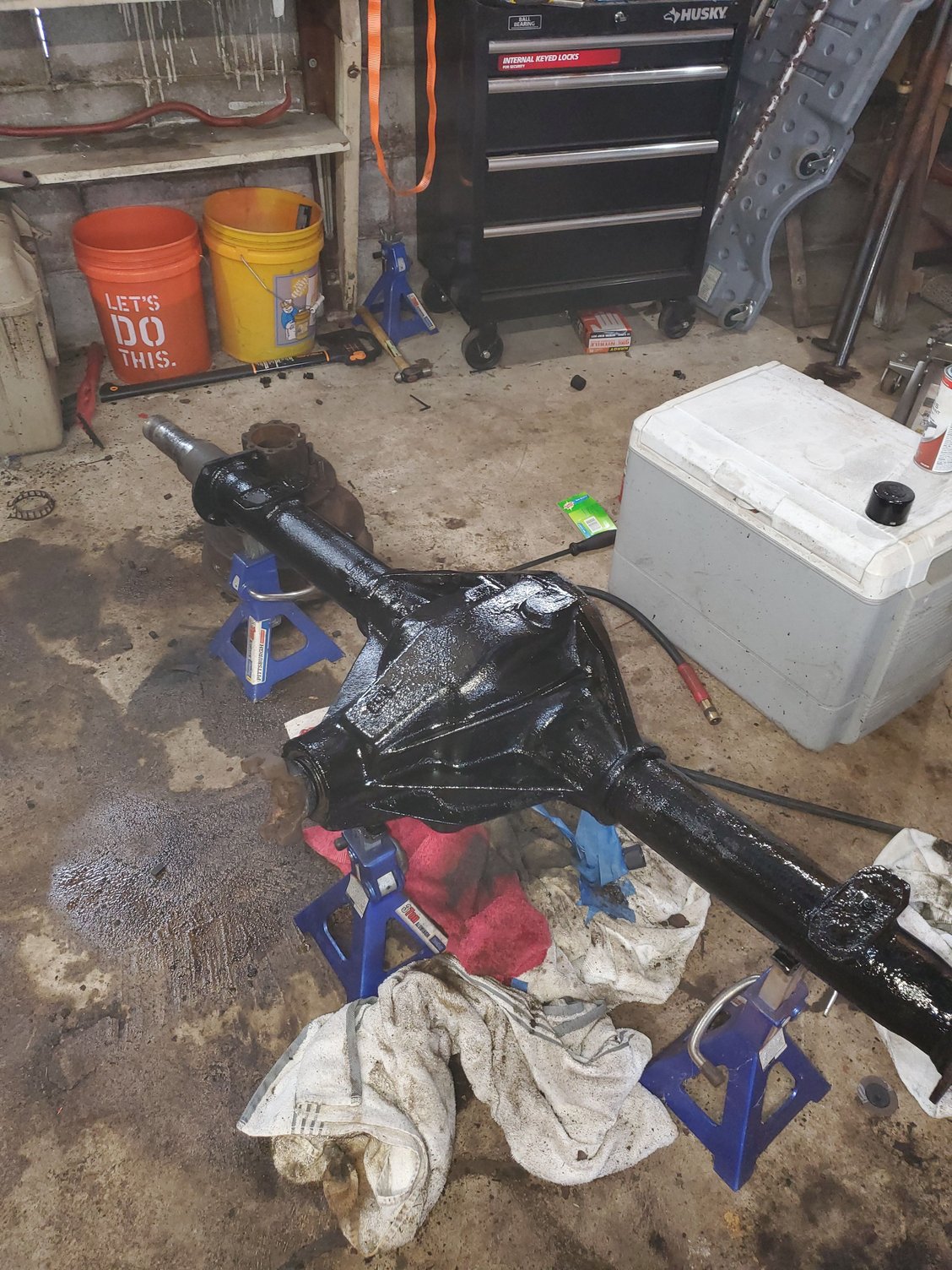

Updates
Cleaned up well and now waiting for all the parts complete new internals and gear ratios.
