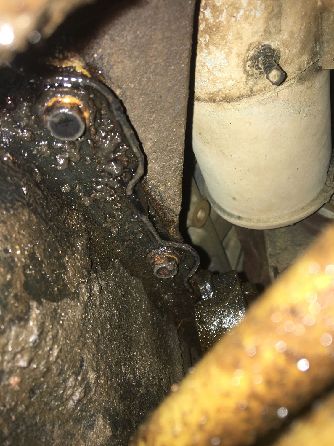

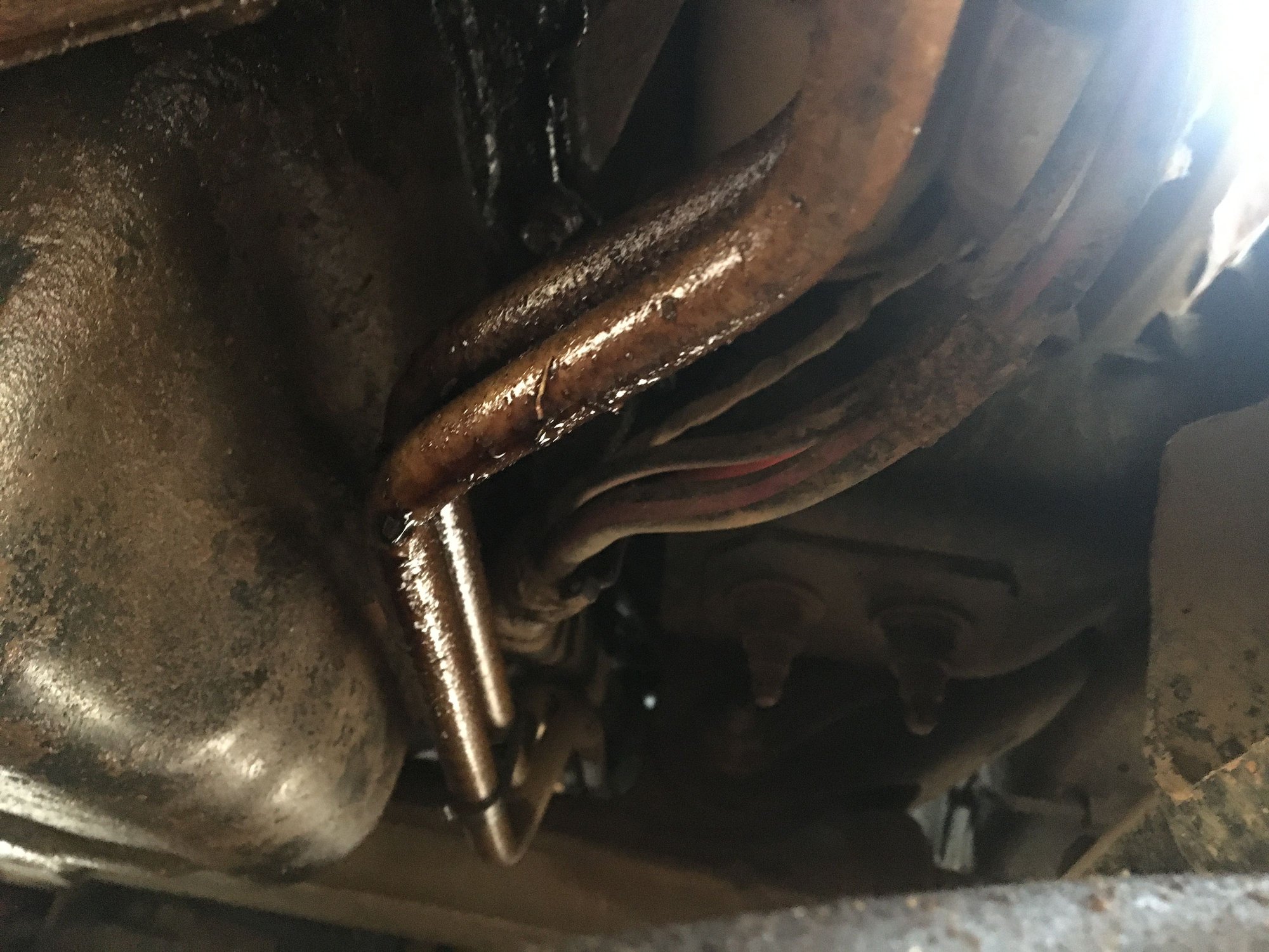

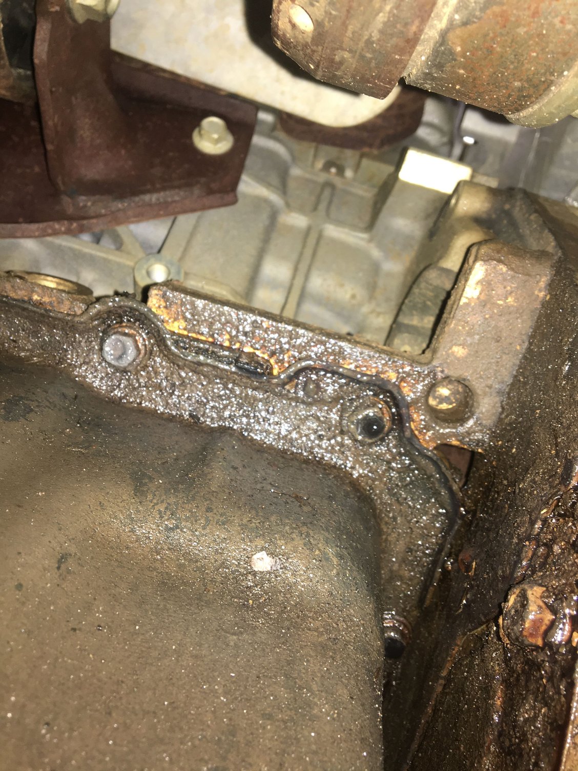

Ok this is what I have discovered
This is what I discovered
Ford F-150 lariat

your photos are the oil pan on the bottom of the motor... one photo shows the side of the motor and I don't see any oil on it.. YES, something has failed and the oil all over is the result.. It needs to be washed off, maybe over cleanen or gunk or similar... then hosed off and run to see where the leak is..... but that probably is not stopping it from starting..
