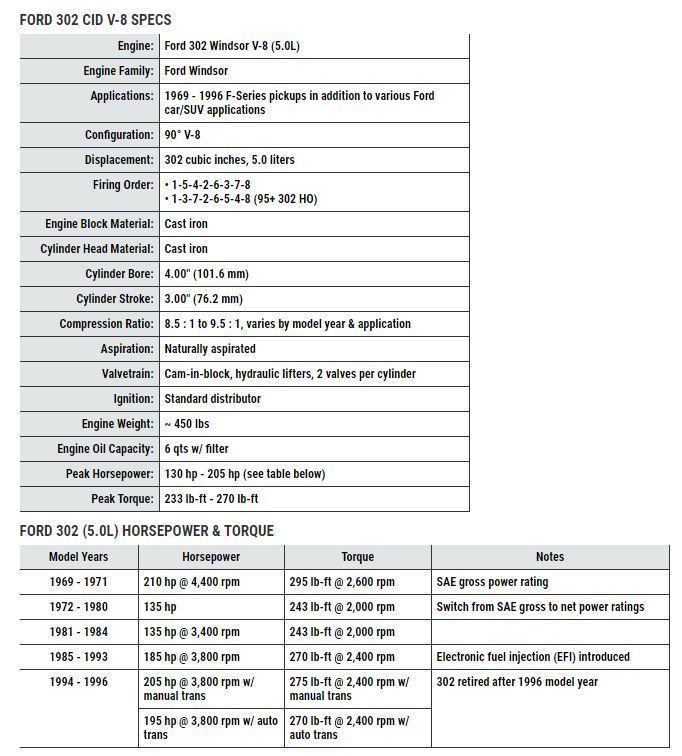

The EFI in his truck will support nearly 300HP.
He could drop a later, roller cam equipped short/long block, rebuilt or salvage in and use everything stock.
There are a limited number of aftermarket EO/cali compliant parts extant in the world but there are some.
And his engine is making more than 160hp. Borrowed this elsewhere:
