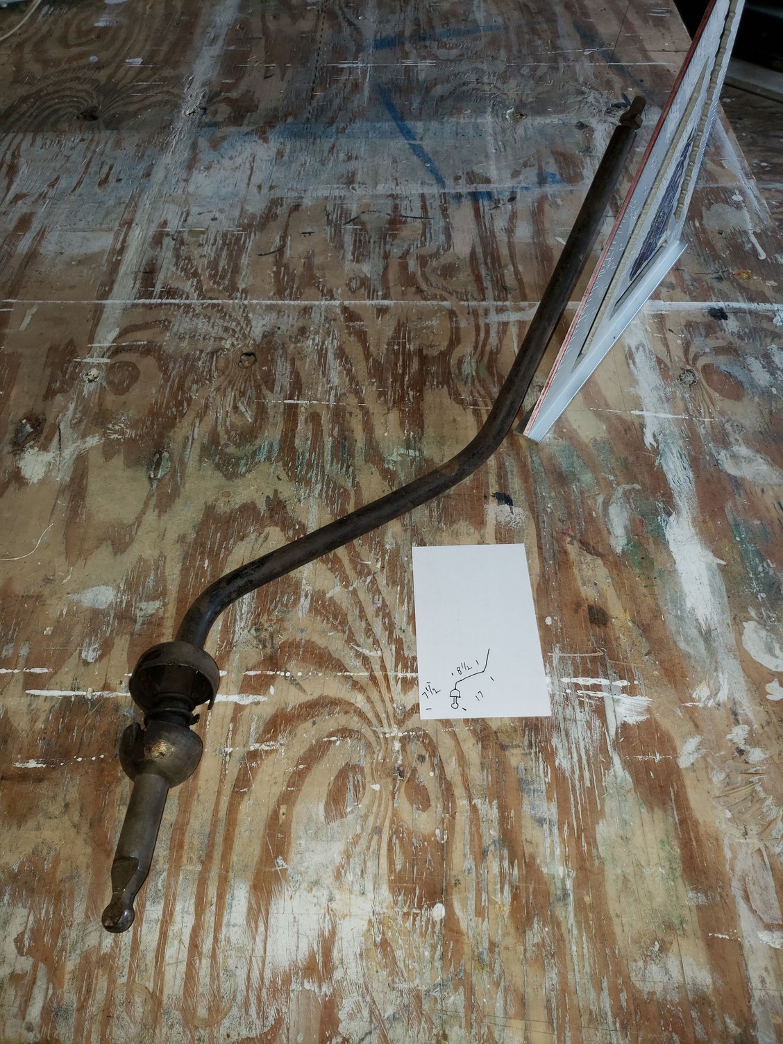

Ok. Took all my measurements from the very bottom of the shaft where it is.ground flat on its edge. Jumped in my truck put in neutral. First bend points too 5 o'clock. Second bend points back to my face. Now out of the truck and at the work bench. Starting at the bottom 3" finger, so top of the ball is 4" up. First bend is 7 1/2" up at 30 degrees aiming at 5 o'clock (or 15 degrees)
. Secound bend is 17" up and at 45 degrees. Total lenght from bottom too top including threads is 28".

Awesome! Thank you so much, this is really helpful!
