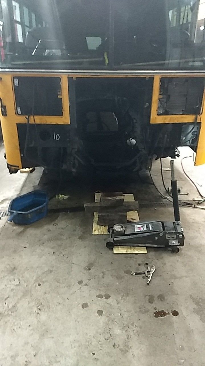

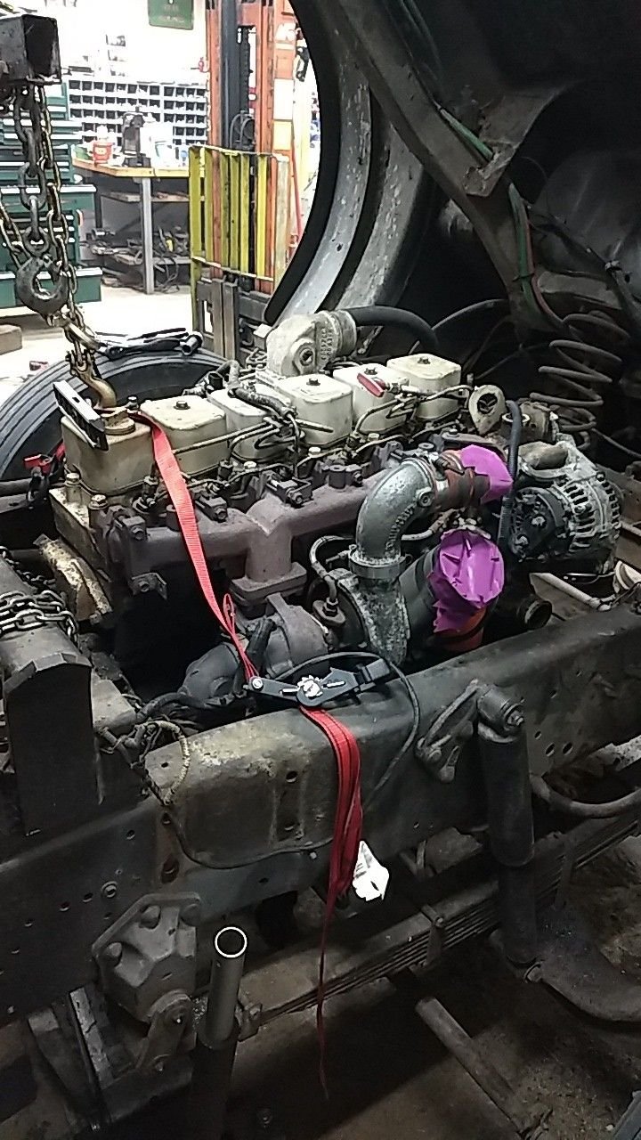

While browsing the forums looking for info, I came across some doubt that a 12 valve Cummins would fit in a C-series cabover. After an hour of measuring, it looked possible so I committed to it. First I bought a blue bird bus as a donor but didn't have any experience with adapting transmissions and it looked to be some guessing and alot of expense so I decided to go with the Allison from the bus for the time being until I got the manual stuff figured out as I needed to use the truck come spring. I ended up using the engine mounts from the bus including the front cradle, new radiator and intercooler, other than that it was a very simple swap. All in all it took me 8 Saturdays to complete and I used it from spring until a couple weeks ago. I really didn't like the auto idea in the first place and I wasn't willing to spend the money on adding the PTO and PTO gear to the Allison 545 so I could use the dump bed so it is back under the knife now and I just put an Eaton Fuller 6 speed in from another donor truck I found. The donor was a 1993 Ford cf7000 cabover with a 12 valve Cummins so I scrapped the rest of the truck and swapped in the flywheel housing sae 2, flywheel, clutch, and trans last weekend. Also using the seats from that truck as the shifter stays down and pokes through the cab between the driver and passenger seats. I now have the 109k mile 12 valve from that truck sitting on a stand I made out of the piece of frame from the cf7000 that purrs like a kitten so might need another project??? If I can figure it out, I'll post pictures from the conversion last year and take some pictures of the current 6 speed swap soon.
Engine and trans out

Mounts done
Bad view of the radiator and intercooler piping

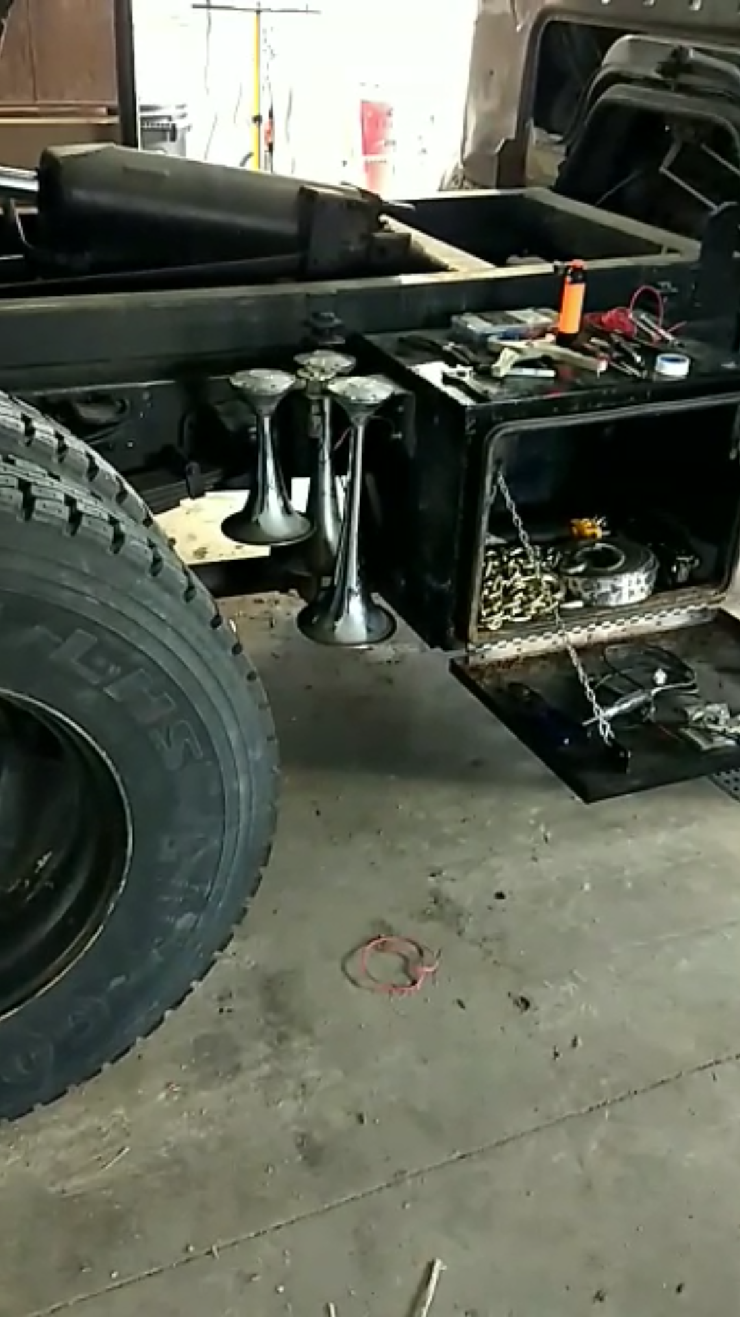

NEEDED air horns

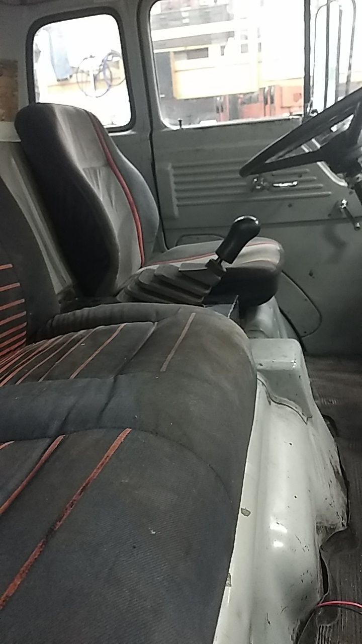

Shifter stays with engine when cab is flipped and has very simple linkage that is not sloppy like the c-700 was

That shifter reminds me of the one on my 83 CL-9000, shifter was on a bracket mounted to the side of the frame rail.

The cf7000 radiator will work but the intercooler piping wraps around the sides and the main frame of the cab would hit it while closing. As for the 5 or 6 speed Allison, they would typically work but being that mine was a tractor and is so short I couldn't have it any longer than the 545 was or my already only 28" driveshaft would be at a bad angle.

I think the key to the 5.9 fitting is not mounting it to your transmission but putting it where it needs to be and mounting the trans to it.
