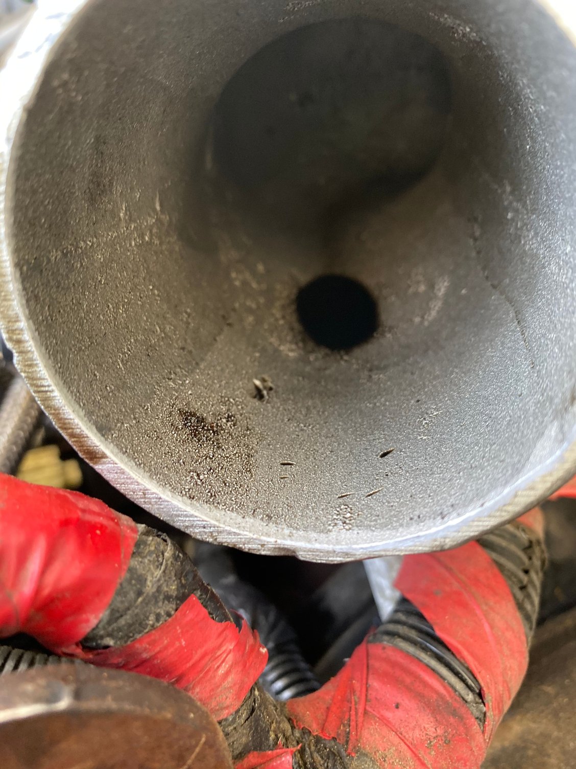

Pretty clean under here for 271k
but wtf happened to my turbo wheel !!???
also is this much oil in turbo intake normal?
Old Nov 17, 2019 | 12:08 PM
beef tits's Avatar
beef tits
Joined: Mar 2017
Posts: 833
Oil is normal. Damaged blades are not normal. Looks like your turbo ate a small rock/bolt or something along the way. At minimum, I would be looking into a new wheel. Presumably, whatever it was got through and went into the charge pipes and intercooler. Wouldn't hurt to pull those and see if anything is rattling around in there.
If the truck is a keeper, at 271k, I'd skip the wheel and look into a new turbo, perhaps a kc300x - very nice upgrade over stock and not too expensive. What are your EGTs like?
Hot torquing quieted my motor down noticeably. I also over-torqued about 10-20%, I forget but nothing broke and once the motor warms up it purrs like a kitten.
Walleye Hunter's Avatar
Walleye Hunter
Joined: Mar 2014
Posts: 10,750
Likes: 1,065
From: Douglassville, PA
It does look clean under there. Oil in turbo inlet is typical from crankcase vent. Something got in there and put a hurting on your turbo wheel so you'll want to replace that.

10.4 will probably do wheel for now....may look at gtp38R after Christmas

Obviously replacing the damaged turbo wheel. Is your current turbo rebuildable? spinning at those RPM’s that out of balance may have caused bearing damage. Hopefully guys with your same turbo will chime in to send you in the right repair direction until you have the funds for a new turbo.

At a minimum that turbo needs to be torn down and evaluated for a rebuild or a suitable replacement.
