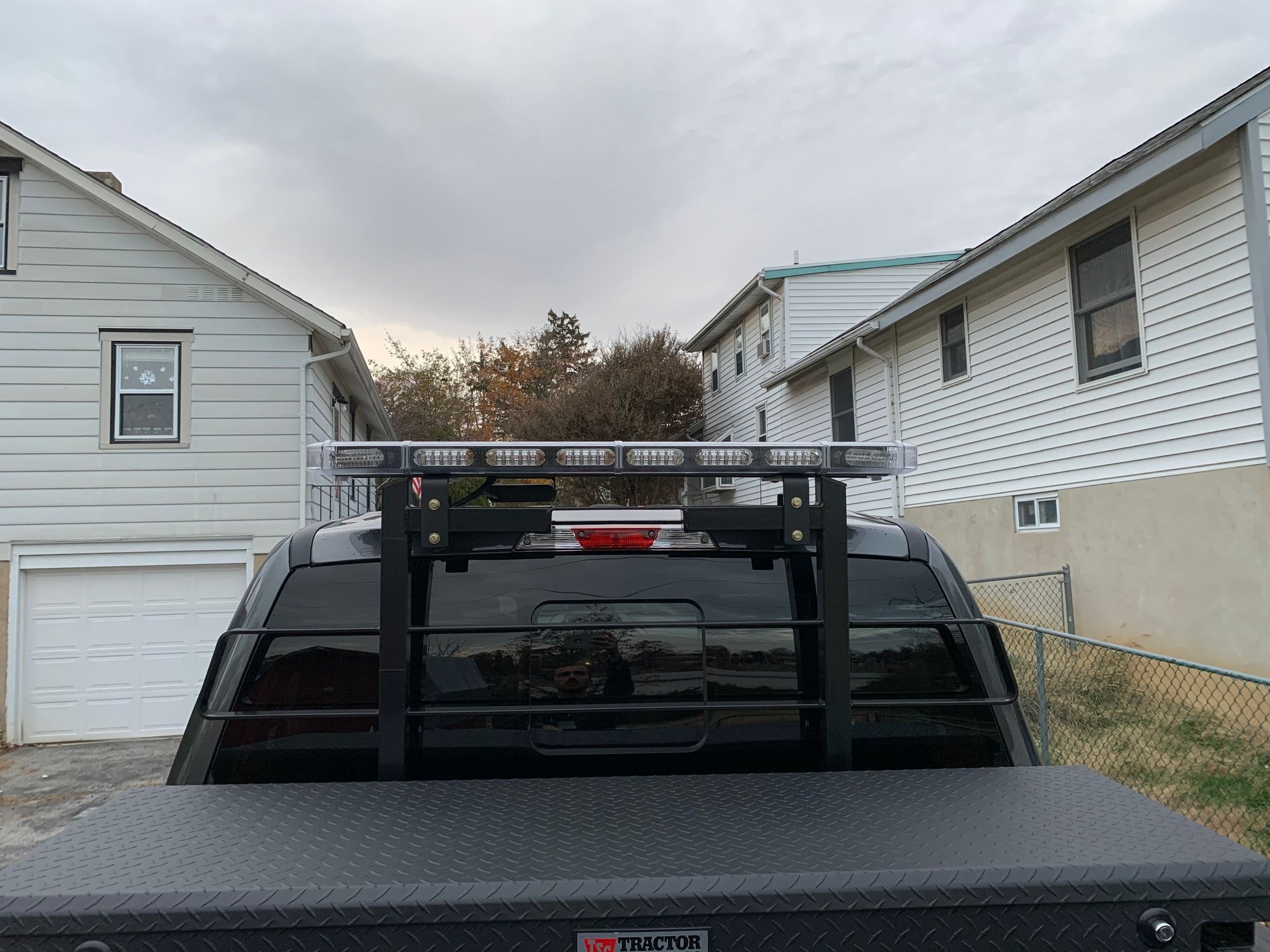

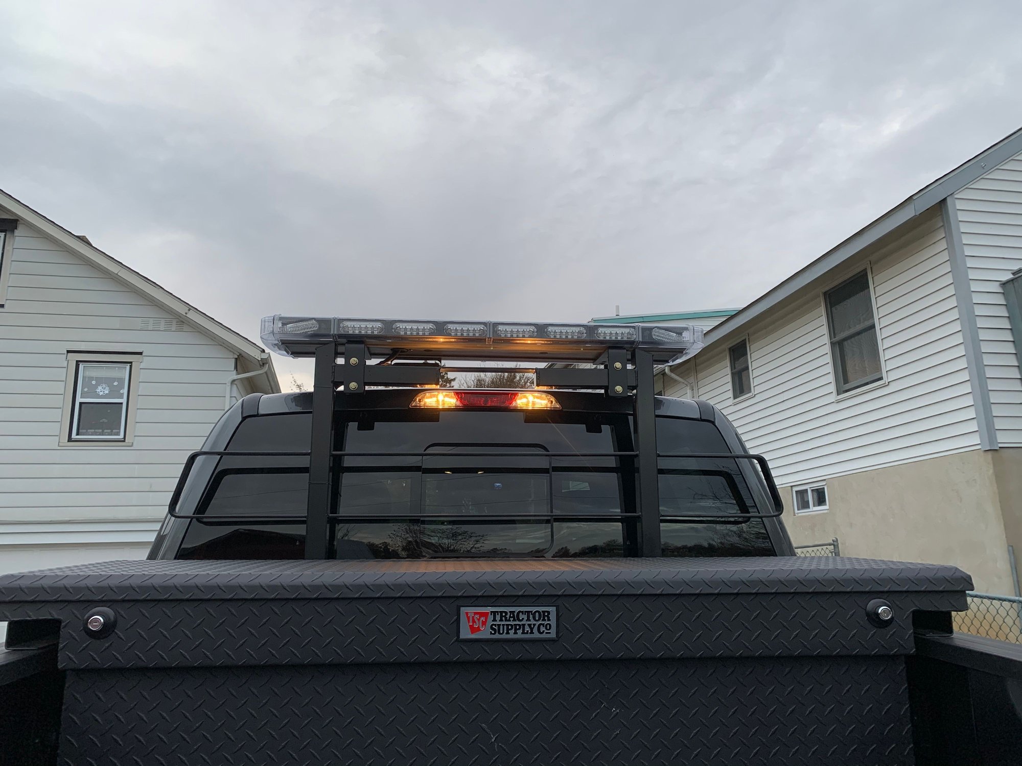

@19SuperDuty May we please see some closeups of how your LED light bar is attached?
On roof or on headache rack?
If roof, through third brake light mounting bracket, or via holes drilled in roof, or by "hugging hook" brackets inside rear doors?
If headache rack, then how is such a wide (front to back) lightbar balanced and secured onto headache rack? Gussets? Brackets?
What is wind noise, before and after light bar installation?
How are wires from the light bar brought into cab? Floor penetration? Back of cab penetration? Existing grommet or new hole? 3rd brake light penetration?
Please post more pics!

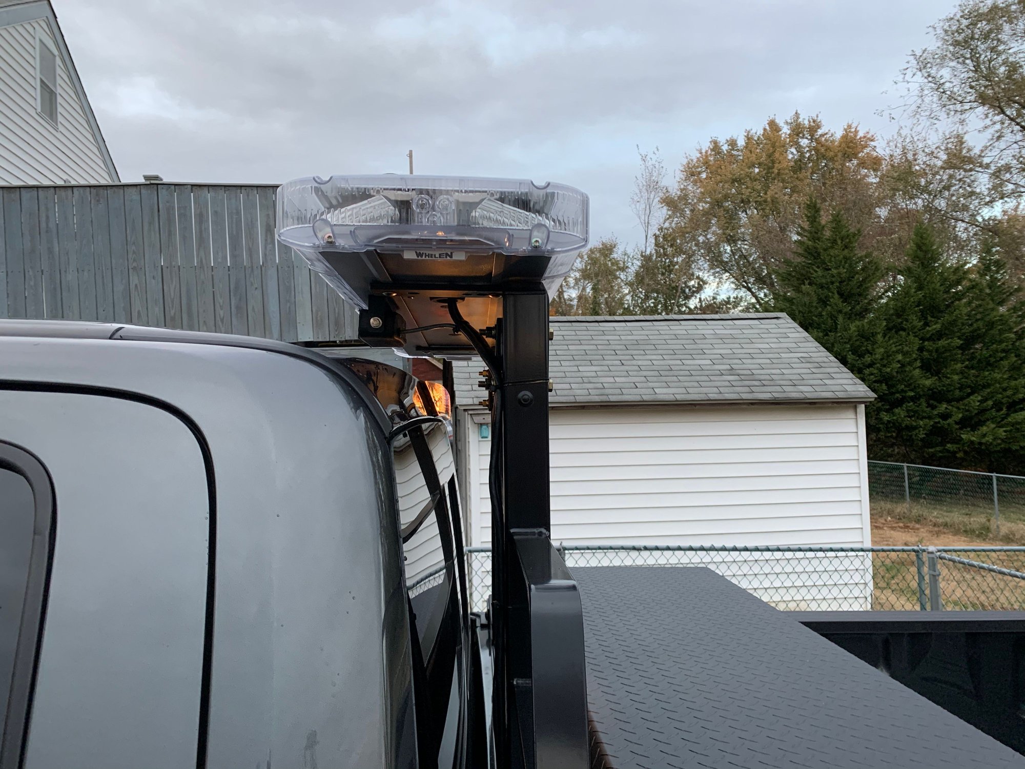

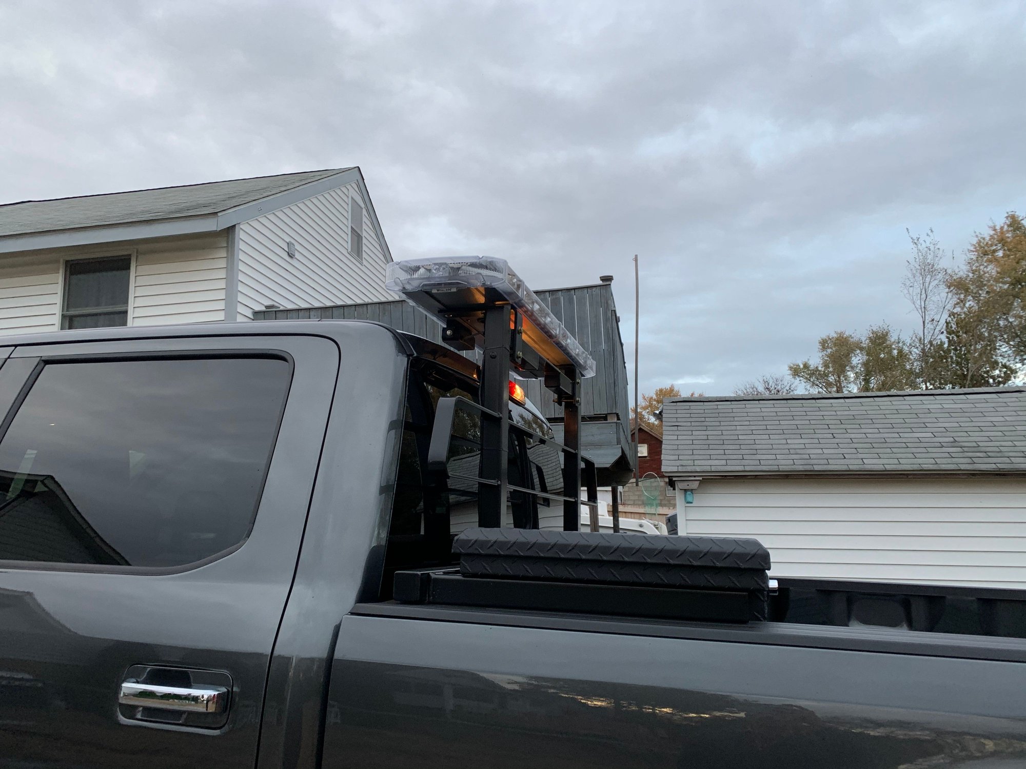

I will take some more pictures as soon as i get chance. The lightbar is a 49 inch Whelen liberty. I mounted it right to the backrack using the backrack full size light bar mounting brackets. The backrack itself is plenty sturdy to support the bar. There is no wind noise, although this could vary depending on what model light bar you end up using. I ran the wires down the backrack to the decompression air vents on the back wall of the cab, behind the rear seat. You have to leave a loop in the bottom of the wires before routing them back up into the vent so rain and water doesn't ride down the wire into the cab. This way there was no holes drilled in the truck and I can remove everything if I ever decide to. As for the lightbar itself, I used my upfitter swithes to control everything. aux 1 turns on the rear of the bar, aux 2 the front of the bar and my dash light, aux 3 is an opticom (traffic preemption, legal in my state) aux 4 is alley lights, aux 5 is a left traffic adviser on the rear of the bar, and aux 6 is a right traffic adviser.
