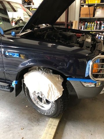

Did some polishing on mine yesterday since it was a rainy nasty day . It made quite a difference on the 16 yr. old paint . Can't get all the scratches out , but at least now they are shiny !!
front fender done ...
front door done ...
at this rate , I may be done by Christmas .

Due to rainy day , I was able to get back to polishing . Hopefully will finish up tomorrow !
quite a few more scratches on this side , sanded some down with 2000 grit ...

Very nice job!!! What did you use for polish? Thanks,. Tim
Old Jan 4, 2020 | 03:54 PM
RONMCHUGH's Avatar
RONMCHUGH
Romcjr
Joined: Jul 2008
Posts: 788
Likes: 40
From: Waller,TX.
3M rubbing compound and machine polish . Used a porter - cable polisher and also used Pinnacle paste wax . It doesn't look brand new as some of the scratches were pretty deep , but it looks much better than before .
